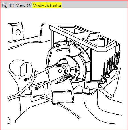

Blows hot air on driver side and cold on passenger side.

Hello, I am Danny.
It sounds like you are having a problem with the mode actuator in your A/C system. It is an electric motor that moves doors around inside the heater/A/C box to route airflow through the air ducts. I am not sure if your system is automatic or manual controls but it is mounted in the same location for both and is the same part for both systems. The repair involves disassembly/removal of the center console and the mode actuator is located on the HVAC box under the dashboard on the passenger side. I have attached a tutorial to make you familiar of the repair and a picture of the mode actuator. Hope this helps and let me know if you have any further questions. Danny-
