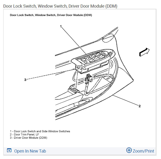

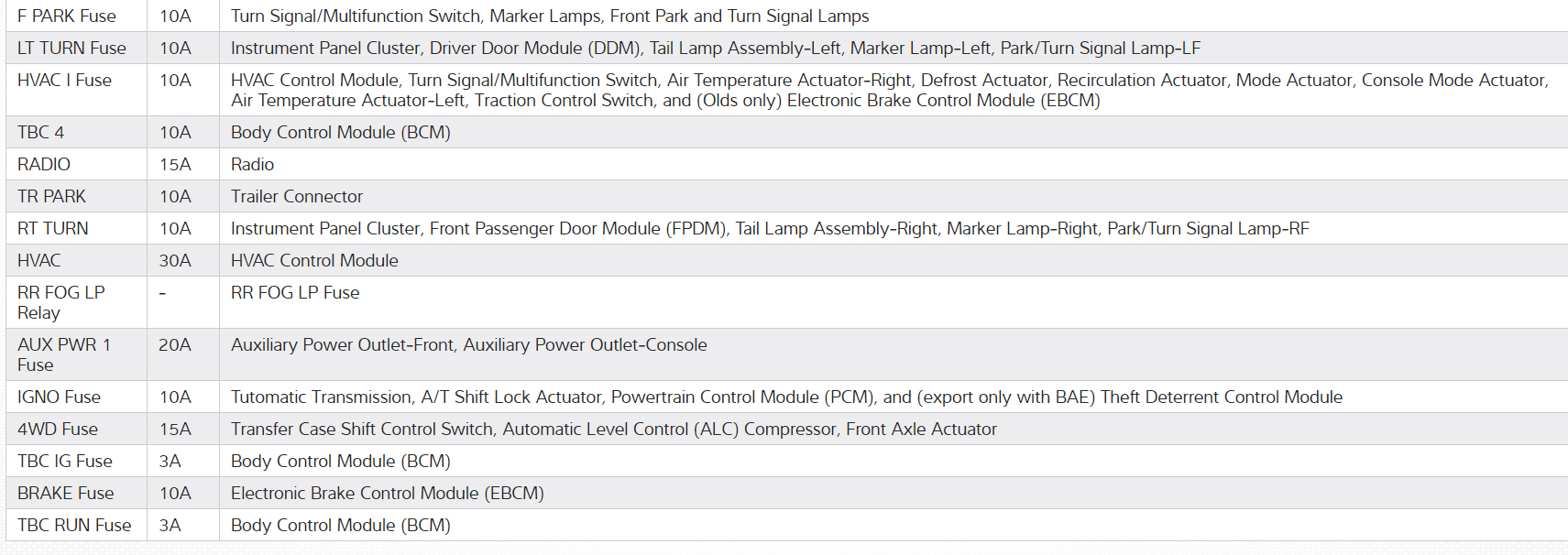

The fobs and remote starter suddenly stopped working. I tried reprogramming. It goes into programming mode but when I get to holding the open and close buttons simultaneously on the key fob it doesn't program. I also tried programming them with my Launch Diagnostics tool. And it says they're reprogrammed before I can even push any buttons on the key fob. I replaced the batteries. Checked the fuses. Everything works from the driver's door controls. Rear wiper, hatch lock, and defroster work. The wiper is quite slow though and sometimes it doesn't make it back to the seated position. I scanned BCM and no codes came up. I actuated the driver's seat and that worked. I couldn't find a valet button. I just removed the rear panel and didn't see any cracked wires. Since everything works from the door, does that mean the Hatch/lift gate module is working correctly before I try checking for power on all the wires? Are there any simpler things I should try first?
Mar 16, 2024 at 5:43 AM
  • 55,710 POSTS

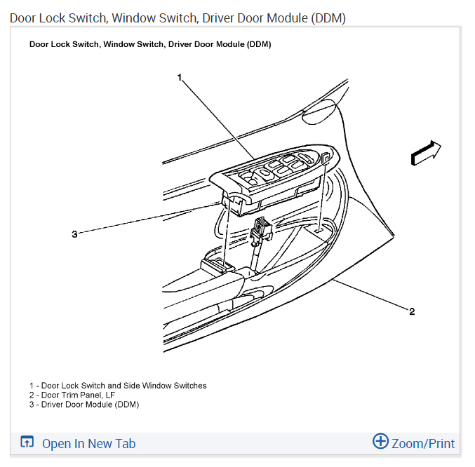

Yep, this happens when the driver's door module goes out which is common, here is the location and how to change it out in the images below. When you say you scanned the BCM did you use a CAN scanner? You can get a CAN scanner (Controller Area Network) which will work on most cars from Amazon.
https://youtu.be/u-4syLc-ifQ
The DDM is integrated into the main window switch. Check out the images (below). Please let us know what happens.

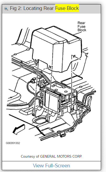

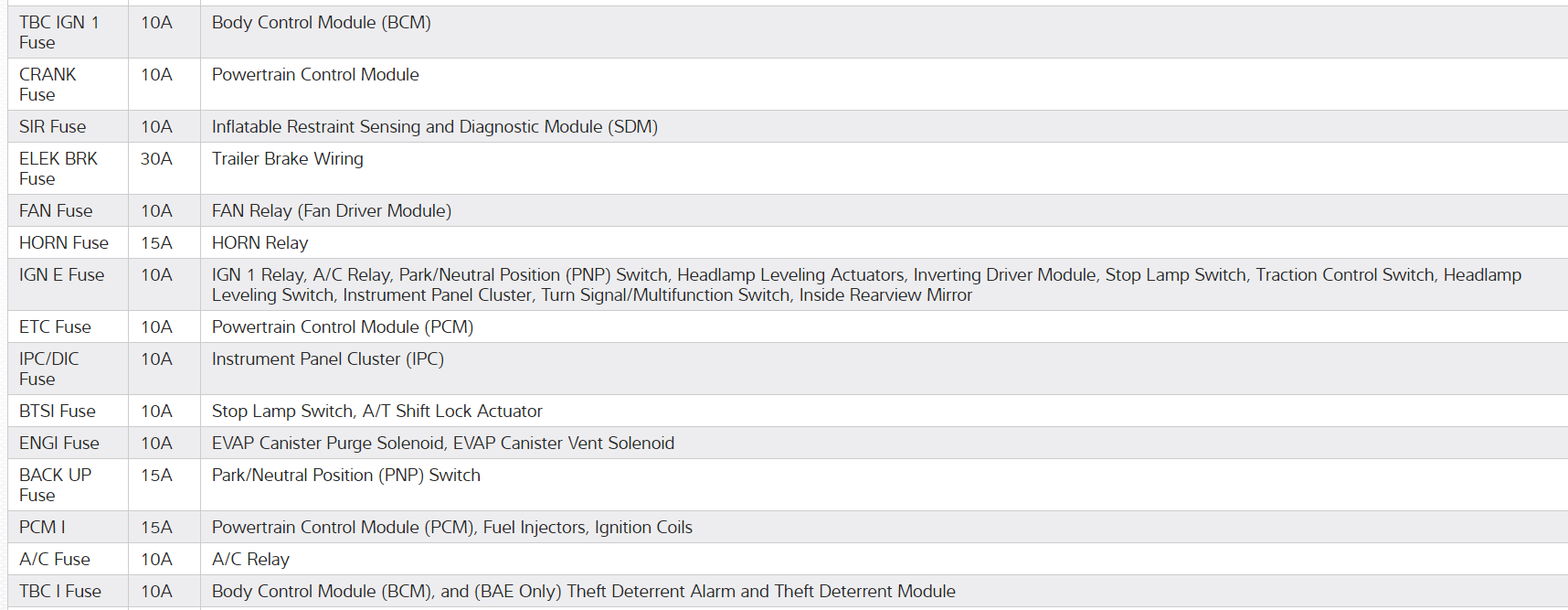

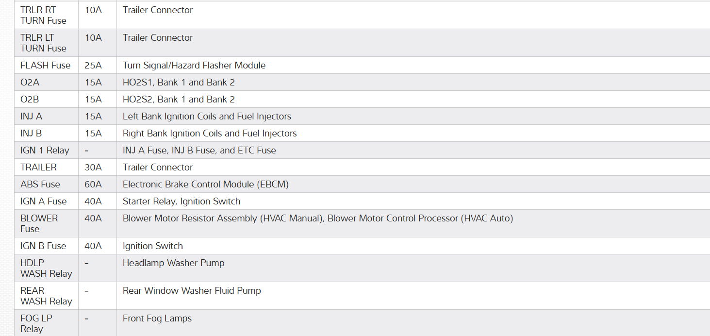

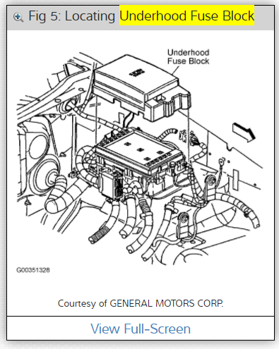

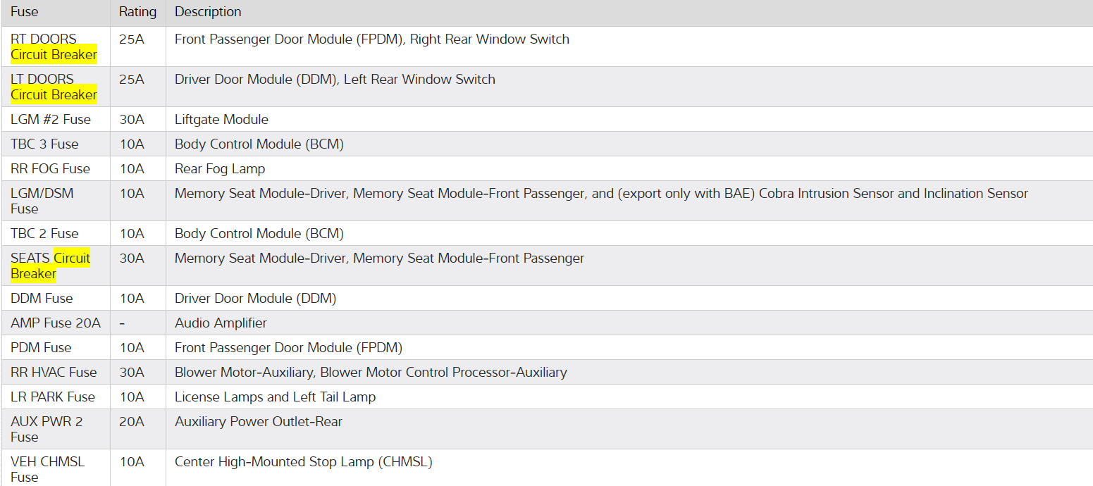

I don't think the garage door opener would do anything, is there an aftermarket remote start kit on this truck i so I would remove it and put the wiring back to stock. I am surprised that a CAN scan is not telling us more. With all systems on I would check all fuses for power. You could have a maxi fuse that has gone out which can power down many systems which makes sense that there are not more codes.
