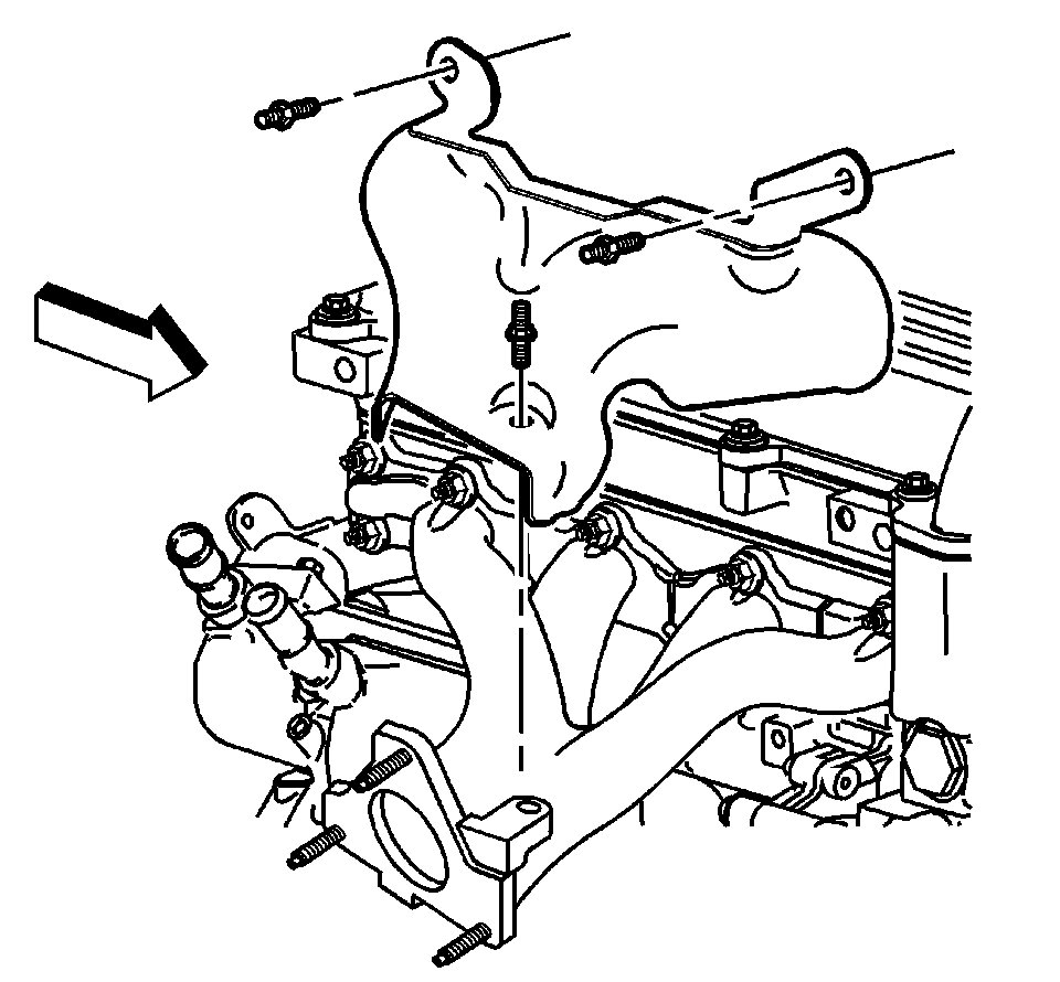

When buying the upstream oxygen sensor a Note pops up that says this: "[Oxygen Sensor] Upstream; VIN: F, Std Trans, Eng Code: L61, 5T45MI, 5 Speed Trans, Transaxle; B1S1)(In exhaust manifold/crossover; reroute harness to service past2003; Quantity needed per vehicle: 1"
I thought this would be simple to do but that message has thrown me off. The car is standard transmission 5 speed. The car is not coding. I am replacing all of the sensors to gain back performance lost from aging sensors.
Here is part #213-968

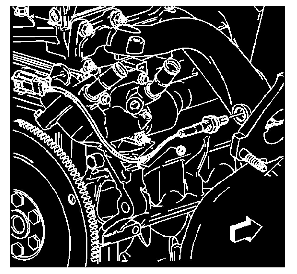

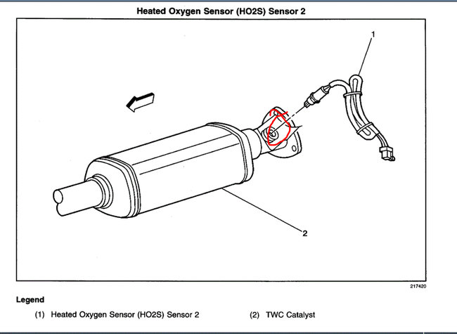

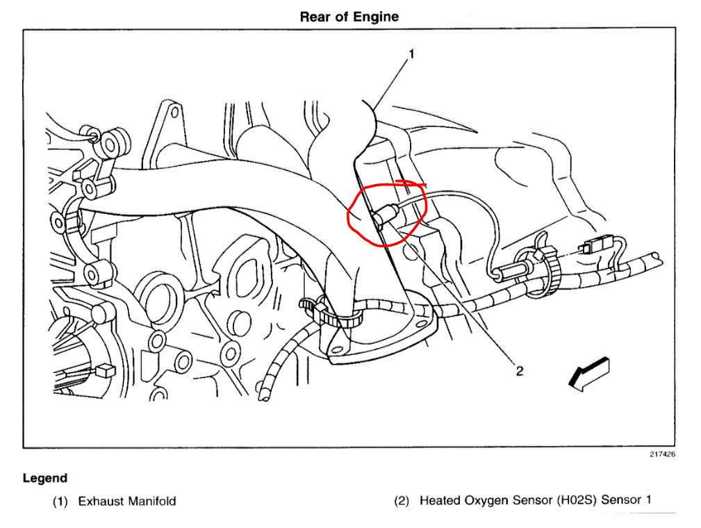

That sounds correct. There are two sensors on the vehicle, an upstream and downstream. The one you listed is for the upstream. It is mounted in the exhaust manifold. See pic 1. Sensor two (not listed above) is after the catalytic converter. See pic 2.
Here are the directions for replacing the one you listed. The attached pics correlate with the directions.

pic 3
1. Remove the exhaust manifold heat shield.
pic 4
2. Disconnect the oxygen sensor harness connector.
3. Remove the oxygen sensor.

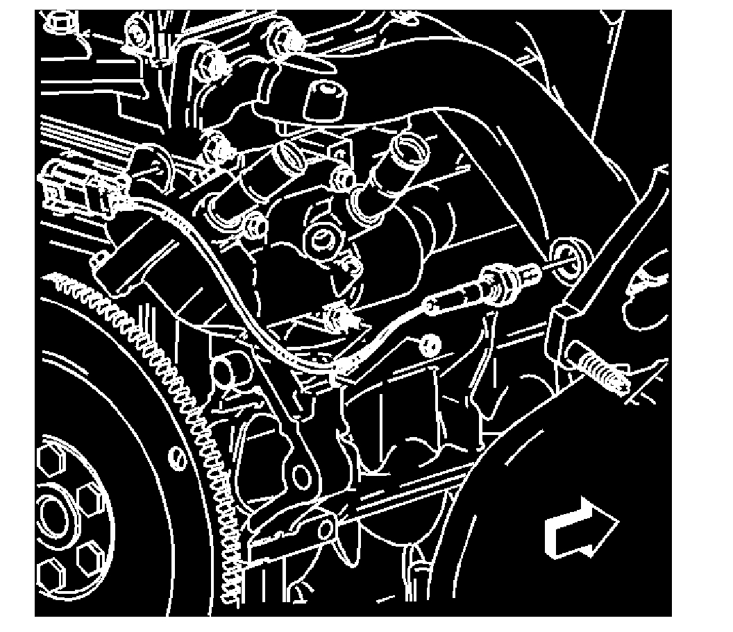

INSTALLATION PROCEDURE
1. Coat the threads of the oxygen sensor with anti-seize compound, if necessary.
IMPORTANT: A special anti-seize compound is used on the oxygen sensor threads. The compound consists of a liquid graphite and glass beads. The graphite will burn away, but the glass beads will remain, making the sensor easier to remove. New or service sensors will have the compound applied to the threads. If a sensor is removed and is to be reinstalled, the threads must have an anti-seize compound applied before installation.
pic 5
2. Install the oxygen sensor.
NOTE: Refer to Fastener Notice in Service Precautions.
Tighten
Tighten the oxygen sensor to 30 N.m (22 lb ft).

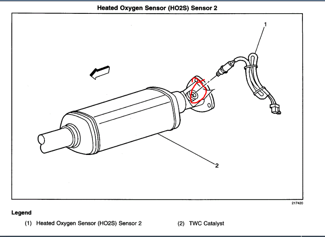

3. Connect the oxygen sensor harness connector.
pic 6
4. Install the exhaust manifold heat shield.
