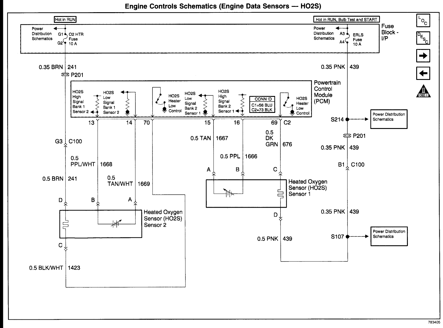

P0135 code replaced O2 sensor code still there
2002 PONTIAC SUNFIRE
150,000 MILES • 2.2L • 4 CYL • FWD • AUTOMATIC
LUMEUX
I received a P0135 code and replaced the upstream O2 sensor. I was able to reset then I received the same code. What is my next step?
Dec 11, 2016 at 1:59 PM
JIS001
  • 3,412 POSTS
The first thing you need to do is verify if you have power going to the heater element on the oxygen sensor. If no power then check the fuses.
As you can see in the diagram the pink wire should supply the battery voltage to the sensor from the fuse located under the engine compartment. Test that circuit out for a fault.
If all is good then I would recommend you replace the oxygen sensor with a Delphi brand. When you buy store brand sensors the heater resistance could be much higher causing the light to come on.
