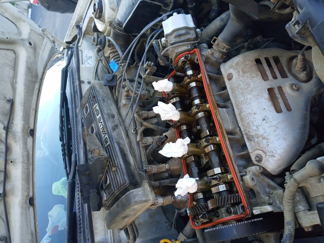

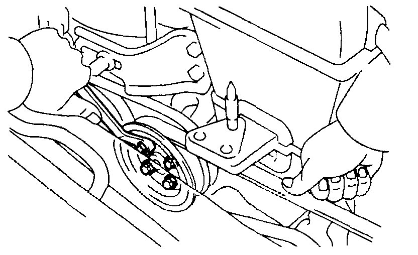

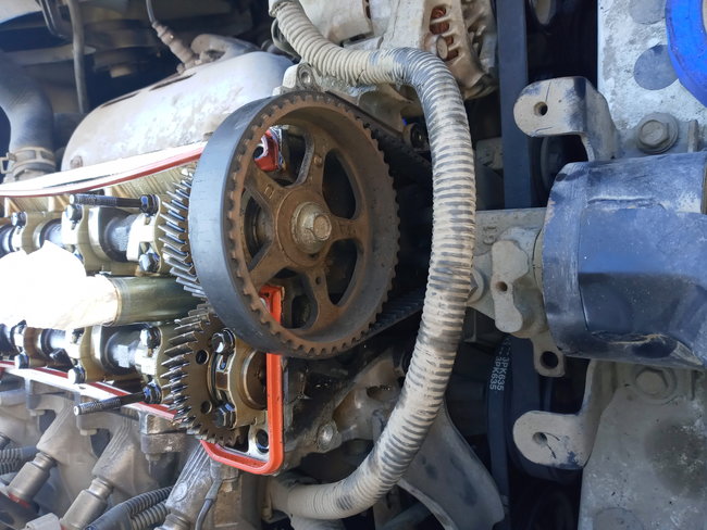

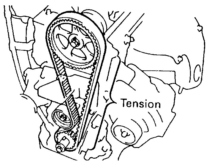

I need to replace my timing belt and i have never done this before. I have worked on cars a little bit, but this is new to me. I have already removed the valve cover and part of the timing belt cover which is all obviously accessed from the top. From here i am totally clueless and need some help!! Trying to understand instructions i find online is like reading stereo instructions in french because it makes no sense. Please, if anyone can offer me a more simplified and descriptive step guide for doing this, this almost middle aged tomboy would very much appreciate the help!
Aug 2, 2020 at 11:43 AM
  • 110,244 POSTS
Everything I have shows the 1.8L as having a duel overhead cam. If that is incorrect, let me know. However, here are the directions for removal and replacement of the belt. The attached pictures correlate with the directions. Please take your time and make sure that all timing marks are located as described in the directions; otherwise, the engine won't run and it can cause internal damage to it.
_________________________________________________
Removal
1995 Toyota Celica Liftback L4-107.5 1762cc 1.8L DOHC (7A-FE)
Timing Belt Removal
Vehicle Engine, Cooling and Exhaust Engine Timing Components Timing Belt Service and Repair Procedures Timing Belt Replace Timing Belt Removal
TIMING BELT REMOVAL
See last pic
pic 1

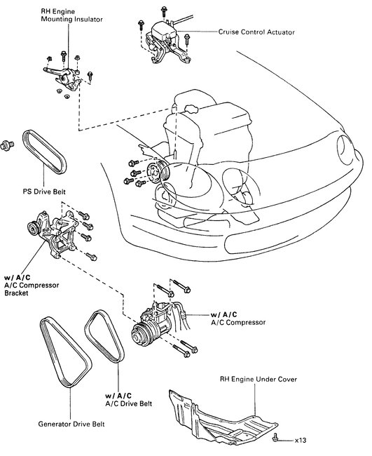

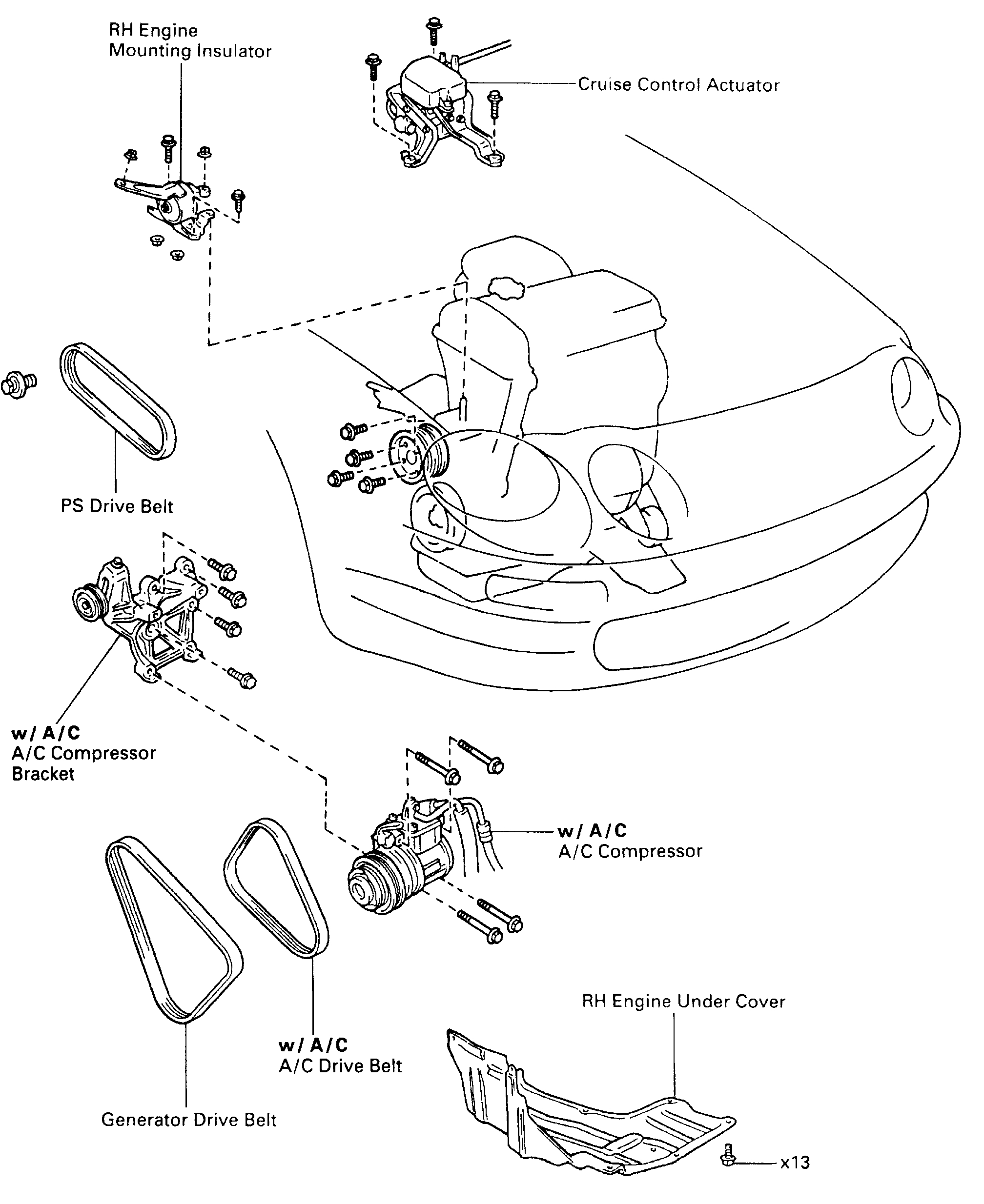

COMPONENTS FOR REMOVAL AND INSTALLATION
1. W/ CRUISE CONTROL SYSTEM: REMOVE CRUISE CONTROL ACTUATOR
(a)Disconnect the actuator connector.
pic 2
(b)Remove the 3 bolts, and disconnect the actuator with the bracket.
2. REMOVE RH FRONT WHEEL
3. REMOVE RH ENGINE UNDER COVER
pic 3

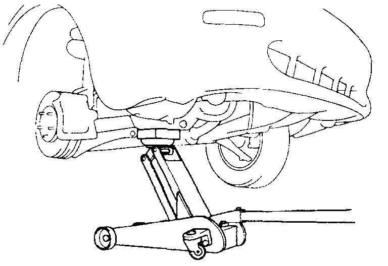

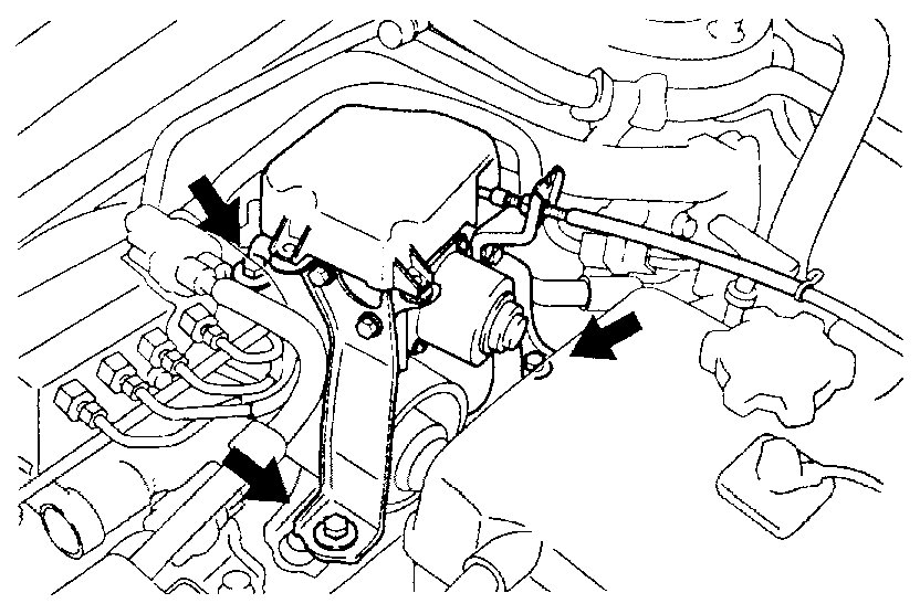

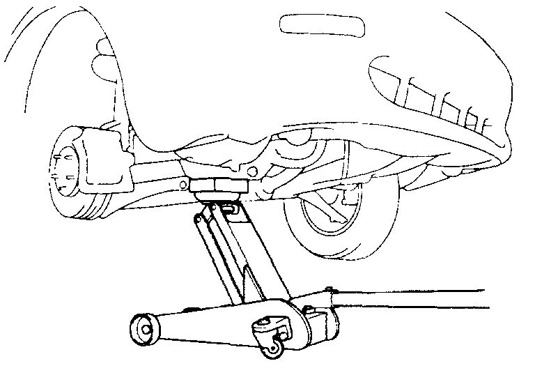

4. SLIGHTLY JACK UP ENGINE
- Raise the engine enough to remove the weight from the engine mounting on the right side.
HINT: Place a wooden block between the jack and engine.
5. REMOVE RH ENGINE MOUNTING INSULATOR
- Remove the 2 bolts, 4 nuts and insulator.
pic 4
6. LOOSEN WATER PUMP PULLEY BOLTS
- Stretch the belt tight and loosen the water pump pulley bolts.
7. REMOVE GENERATOR DRIVE BELT
8. w/A/C: REMOVE A/C COMPRESSOR WITHOUT DISCONNECTING HOSES
9. w/A/C: REMOVE A/C COMPRESSOR MOUNTING BRACKET

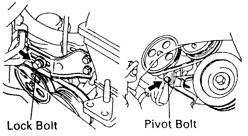

pic 5

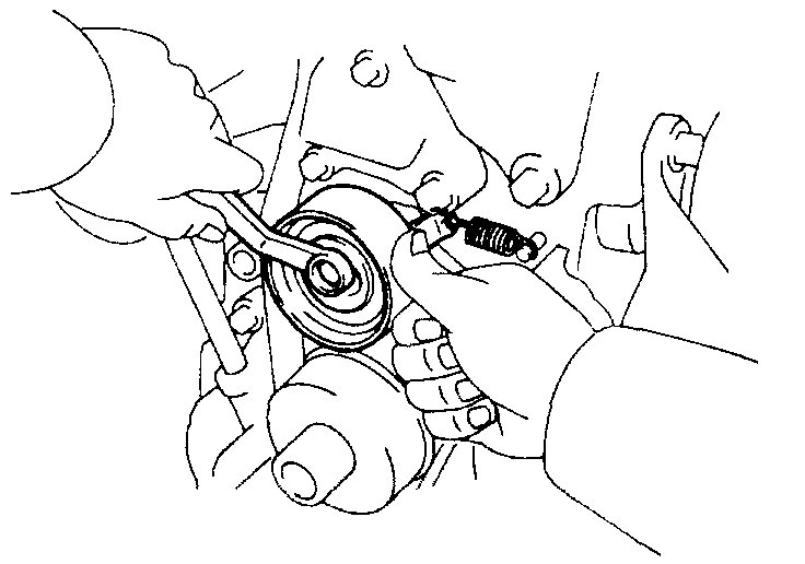

10. REMOVE PS PUMP DRIVE BELT
(a)Loosen the pivot and lock bolts.
(b)Swing PS pump toward the engine and remove the drive belt.

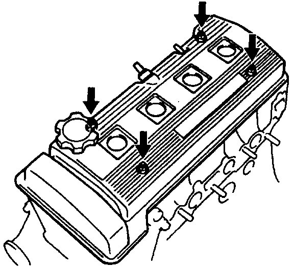

12. REMOVE CYLINDER HEAD COVER
- Remove the 4 cap nuts, seal washers, and cover and gasket.

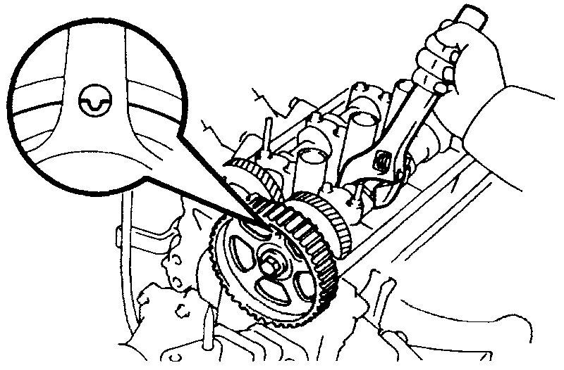

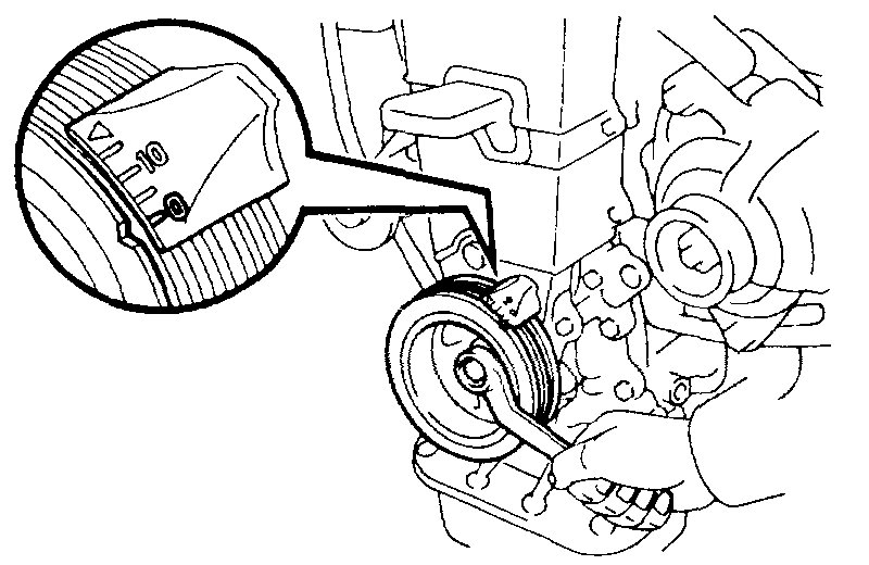

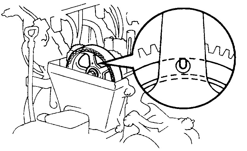

13. SET NO.1 CYLINDER TO TDC/COMPRESSION
(a)Turn the crankshaft pulley and align its groove with the timing mark "0", of the No.1 timing belt cover.
pic 7
(b)Check that the hole of the camshaft timing pulley is aligned with the timing mark of the bearing cap.
If not, turn the crankshaft one revolution (360°).

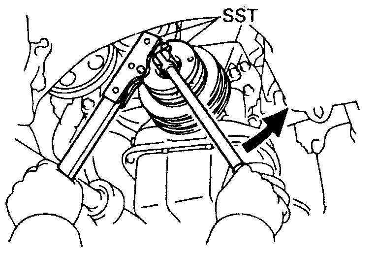

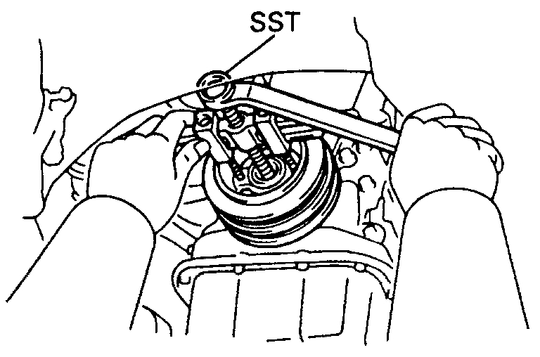

14. REMOVE CRANKSHAFT PULLEY
(a)Using SST, remove the pulley bolt.
SST 09213-54015,09330-00021
pic 9
(b)Using SST, remove the pulley.
SST 09950-50010 (09951-05010, 09952-05010, 09953-05020, 09954-05030)
pic 10

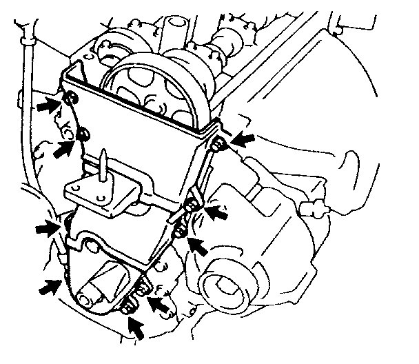

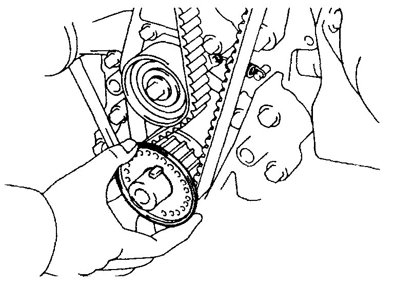

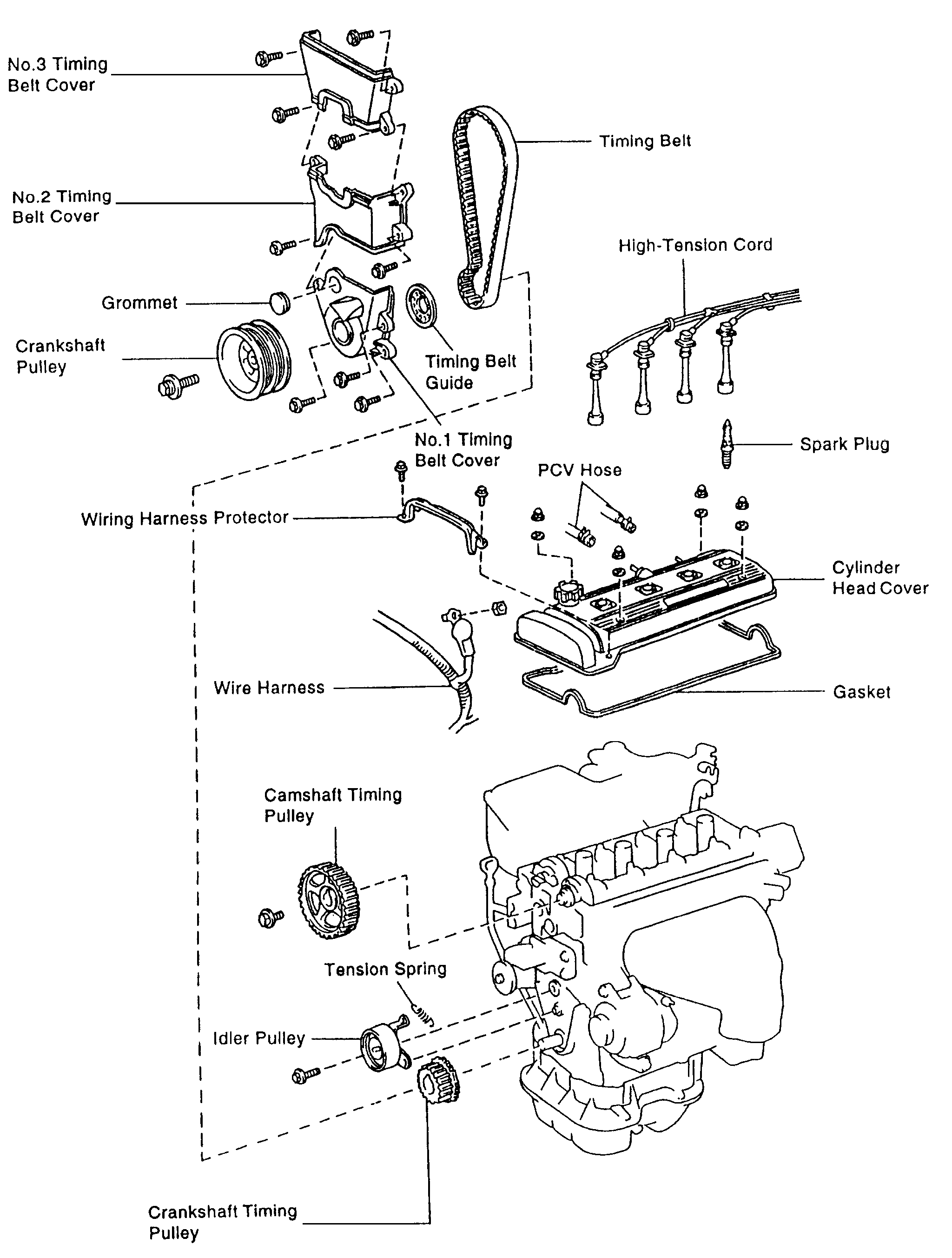

15. REMOVE TIMING BELT COVERS
- Remove the 9 bolts and timing belt covers.
16. REMOVE TIMING BELT GUIDE
17. REMOVE TIMING BELT
pic 11

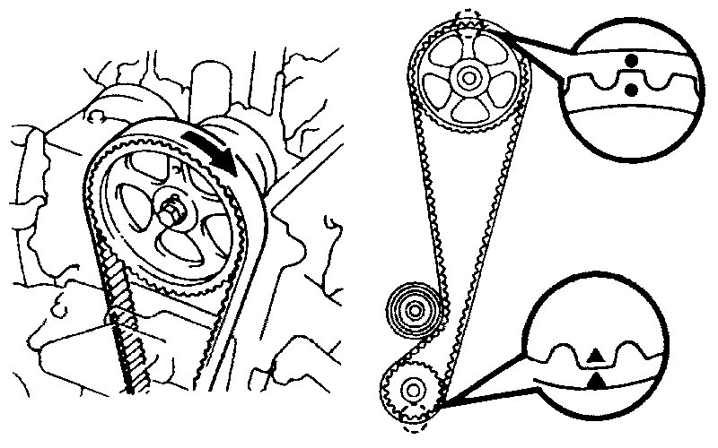

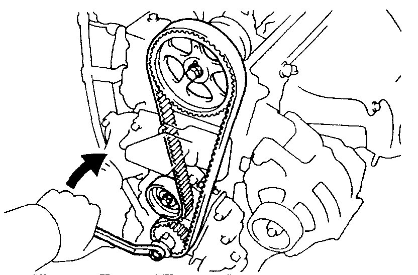

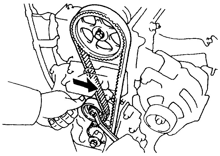

HINT: If reusing the timing belt, draw a direction arrow on the belt (in the direction of engine revolution), and place matchmarks on the pulleys and belt as shown in the illustration.
pic 12

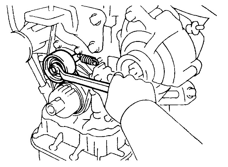

(a)Loosen the mounting bolt of the idler pulley and shift pulley toward the left as far as it will go and then temporarily tighten it.
(b)Remove the belt.
pic 13
18. REMOVE IDLER PULLEY AND TENSION SPRING
- Remove the bolt, pulley and tension spring.
pic 14

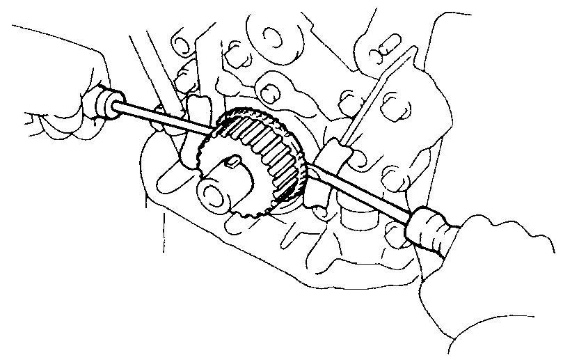

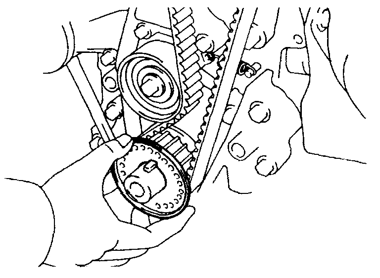

19. REMOVE CRANKSHAFT TIMING PULLEY
- If the pulley cannot be removed by hand, use 2 screwdrivers.
pic 15

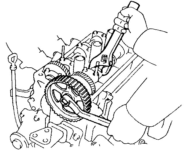

20. REMOVE CAMSHAFT TIMING PULLEY
- Hold the hexagonal head wrench portion of the camshaft with a wrench, and remove the bolt and timing pulley.
NOTICE: Be careful not to damage the cylinder head with the wrench.

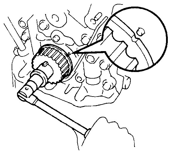

1. INSTALL CAMSHAFT TIMING PULLEY
HINT: Align the camshaft knock pin with the knock pin groove of the pulley, and slide the timing pulley on the camshaft.
Torque: 59 Nm (600 kgf-cm, 43 ft-lb)
2. INSTALL CRANKSHAFT TIMING PULLEY
(a)Align the pulley set key with the key groove of the pulley.
(b)Slide the timing pulley on the crankshaft, facing the flange side inward.
pic 16
3. TEMPORARILY INSTALL IDLER PULLEY AND TENSION SPRING
(a)Install the idler pulley with the bolt. Do not tighten the bolt yet.
(b)Install the tension spring.
(c)Push the pulley toward the left as far as it will go and tighten the bolt.

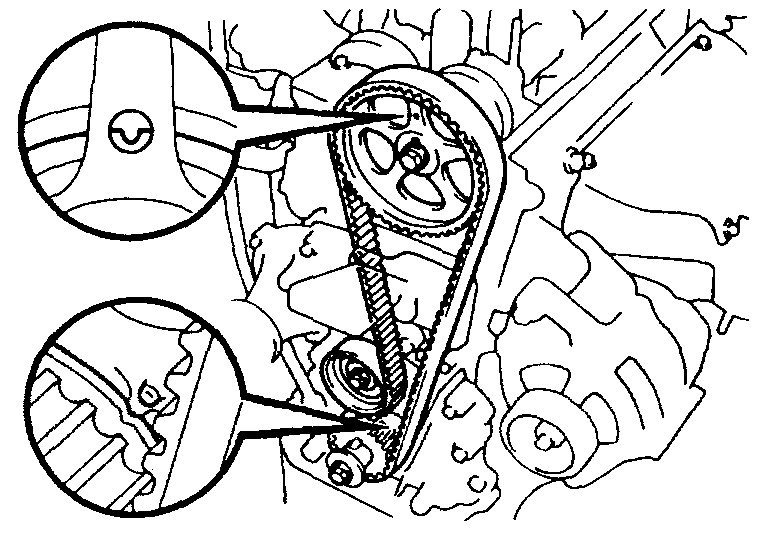

4. SET NO.1 CYLINDER TO TDC/COMPRESSION
(a)Turn the hexagonal wrench head portion of the camshaft, and align the hole of the camshaft timing pulley with the timing mark of the bearing cap.
pic 18
(b)Using the crankshaft pulley bolt, turn the crankshaft and align the timing marks of the crankshaft timing pulley and oil pump body.
5. INSTALL TIMING BELT
NOTICE: The engine should be cold.
pic 19
HINT: If reusing the timing belt, align the points marked during removal, and install the belt with the arrow pointing in the direction of engine revolution.
pic 20
Install the timing belt. and check the tension between the crankshaft timing pulley and camshaft timing pulley.
6. CHECK VALVE TIMING
(a)Loosen the idler pulley bolt.
pic 21
(b)Slowly turn the crankshaft 2 revolutions from TDC to TDC.
NOTICE: Always turn the crankshaft clockwise.
pic 22
(c)Check that each pulley aligns with the timing marks as shown in the illustration.
If the timing marks do not align, remove the timing belt and reinstall it.

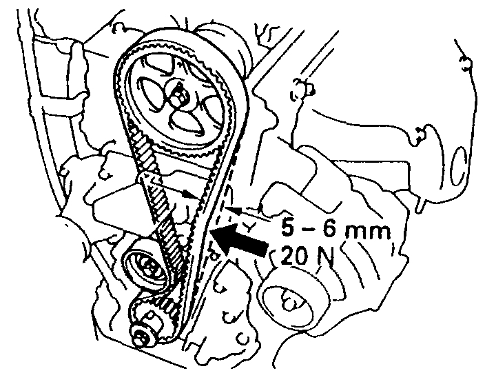

7. Reference: CHECK TIMING BELT DEFLECTION
- Check that there is belt deflection at the position indicated in the illustration.
At 20 N (2 kgf, 4.4 lbf): 5-6 mm (0.20-0.24 in.)
pic 24
If the deflection is not as specified. readjust with the idler pulley.

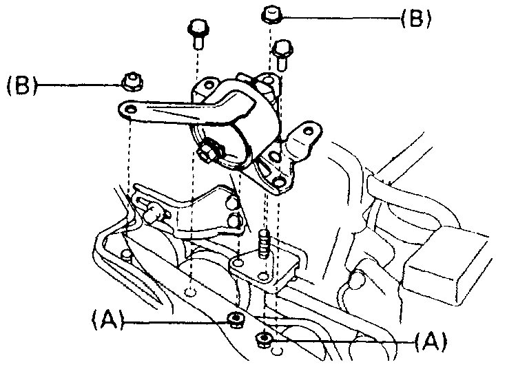

18. INSTALL RH ENGINE MOUNTING INSULATOR
- Install the mounting insulator with the 2 bolts and 4 nuts.
Torque:
Bolt: 64 Nm (650 kgf-cm. 47 ft-lb)
Nut A: 52 Nm (530 kgf-cm, 38 ft-lb)
Nut B: 28 Nm (290 kgf-cm, 21 ft-lb)

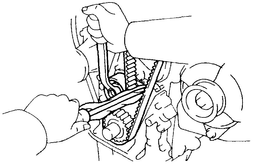

Thank you very much for the instructions! I have made extreme progress!! However, I have reached a stand-still again. any suggestions on how to hold the camshaft pulley still without the SST or impact wrench? I have a breaker bar and a hand drill (not sure if i can make that work or not) and the proper fitting socket and ratchet, but that's all.
Aug 6, 2020 at 5:21 AM
  • 110,244 POSTS
If you look at pic 16 above, it shows a crescent wrench holding the hex shaped section on the cam. That is the only way I know to do it. Do you have any open ended wrenches or a crescent wrench that would fit?
Aug 6, 2020 at 4:44 PM
KSTEELE
  • 10 POSTS
It took me almost 2 weeks and a lot of blood sweat and tears, but i finally managed to get that stupid bolt loose and remove that darn pulley! Timing belt is finally removed!! Now, the challenge of putting it all back together..... It ended up taking a heavy duty impact wrench to get the thing to get loose.
Aug 26, 2020 at 8:42 AM
  • 110,244 POSTS
Wow! It shouldn't have been that tight. As far as replacement, do you have any questions? Do you need help with anything?
