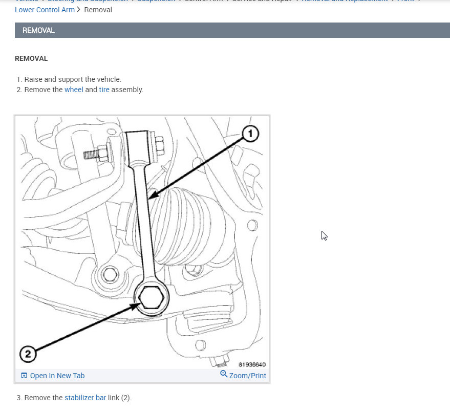

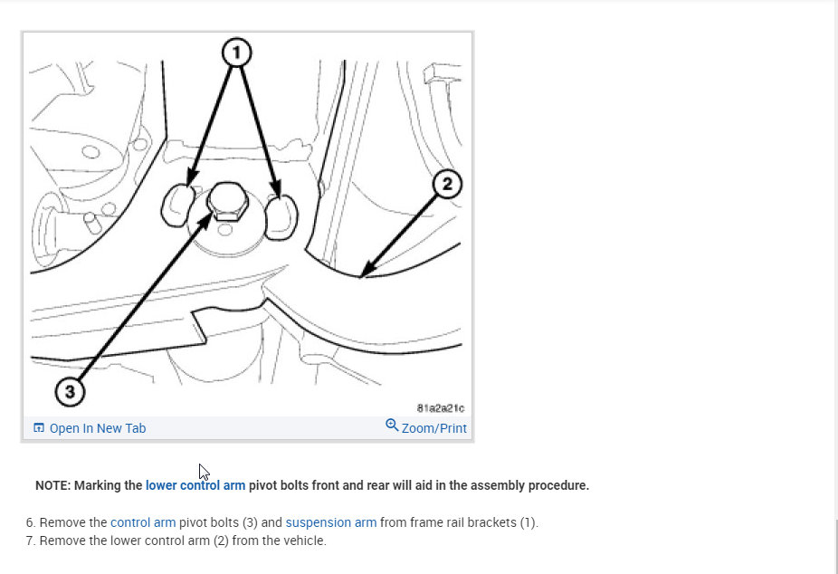

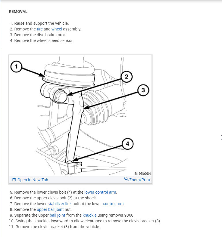

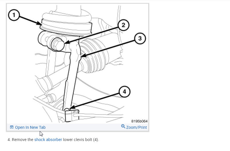

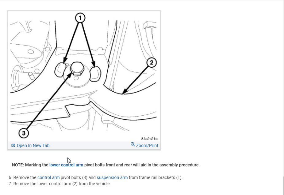

How to replace whole strut assembly? thank you.
Dec 8, 2019 at 12:28 PM
Here is the process for the strut and the lower control arm. It appears the lower control arm process covers all the steps needed that are laid out in the actual strut process. Let me know if you have questions. Thanks
Here is a video that will help. This is not your vehicle but the idea is the same.
https://youtu.be/qkRMwlO_u3U
