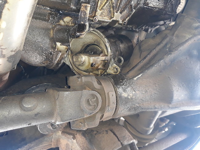

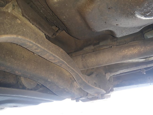

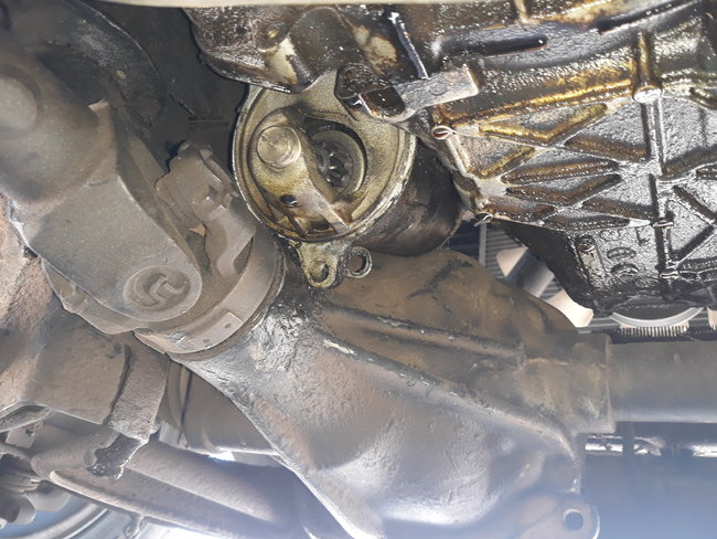

Starter went out. I'm replacing it and I got the starter bolts out finally from under the vehicle. Now I dropped the starter down and it wont fit out due to the driveshaft blocking the way. It even looks like with the drive shaft removed it wouldn't fit out. How do I get my starter out? .Also tried removing it from up top as well as side tire well. The steering wheel column blocks me on the drivers front tire side. Any ideas would be helpful I've looked online everywhere for videos and any advice but can't find anything.

If you bring the opposite end out first and then angle the starter motor, you should be able to get it past the drive shaft/differential. I'm not there to know what all was tried, so please bear with me. Can it go out through the front or is the exhaust in the way? I don't ever recall having trouble.
Worst case, you may have to support the engine and unbolt the left motor mount and slightly lift that side of the engine, but I do not remember ever doing that.

It has been a while since I've done that year Explorer but it will come out the bottom without removing anything. I think you need to turn it so that the drive gear is facing up I'm pretty sure it will slide by the axle and the upper lip that gets in the way I'm pretty sure when you angle it right you can get it by like getting a couch through a doorway.at the spot where where the axle meets the transmission.

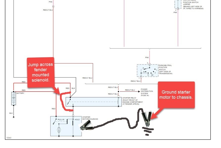

Hello, my husband got it off today but in order to get it off he had to take the drive shaft out, loosen a motor mount and move the motor over to get the starter past the transfer case lip and the yolk. but now after he had everything back together hes still having the same problem as before; one single click when he turns the key to start it. The click is coming from the starter relay next to the battery. What do you recommend trying next since he changed the starter and its doing the same thing? Thank you all for replying so fast and trying to help!!

I've attached a diagram of two things to verify, power and ground at the starter.

Well, do you have a test light? Your going to have to follow the power down the circuit starting at the battery you want a consistent bright light the whole way, attach a good ground and with someone turning the key into the crank position check down the line, first the positive cable at the battery then over to the relay one terminal power on (bright light) one turns on with the key (bright light). if you have that right to the starter, first the main post (bright light), then second small wire on with the key (bright light). If it passes that the starter needs a bench test.
