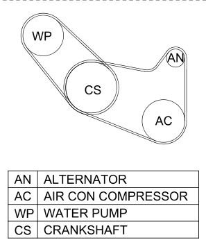

Need a diagram for the vehicle listed above SE model.
Sep 10, 2020 at 12:51 AM
STEVE W.
  • 15,413 POSTS

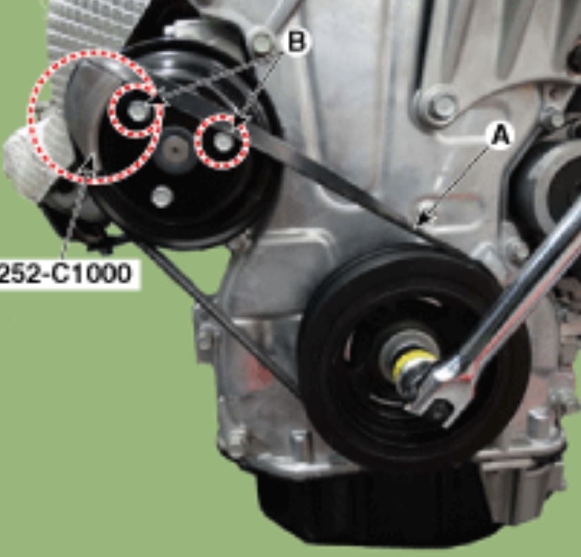

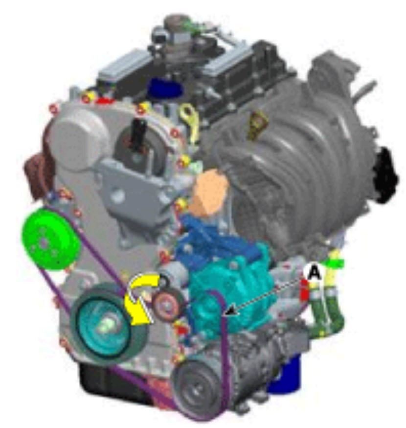

There are two belts on that engine if the data is correct. One is a stretch type belt that powers the water pump only. That is the first image, the other belt powers the alternator and A/C compressor and uses a tensioner. That is the second image. It wraps around the crank pulley and under the A/C clutch then up to the alternator and then back to the crank pulley. The tensioner needs to be moved counter clockwise to remove or install that belt.

Confirm which belt is being replaced. The water-pump belt is a stretch type and drives only the water pump. The other belt drives the alternator and A/C compressor, routes from the crank pulley under the A/C clutch to the alternator and back to the crank, and uses a tensioner that must be moved counterclockwise for removal or installation.
