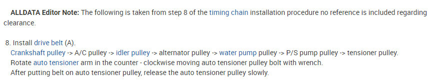

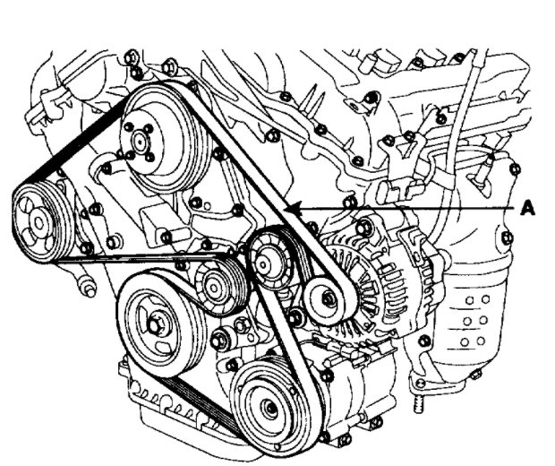

could you send me a diagram on how the serpentine belt is to be put on?

Here is the information you requested. This is a tutorial for you to view on how to remove and replace a serpentine belt:
I've attached picture steps below on how to replace the serpentine belt and its routing diagram on your car. Hope this helps and thanks for using 2CarPros.
