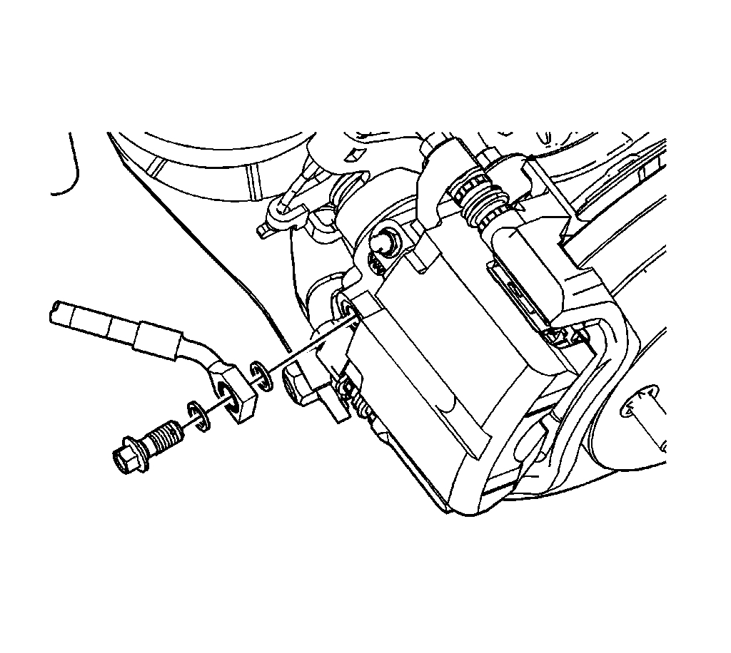

9. Remove the brake hose to caliper bolt from the brake caliper.
10. Remove the brake hose from the brake caliper.
11. Remove and discard the 2 copper brake hose gaskets. These gaskets may be stuck to the brake caliper and/or the brake hose end.
12. Cap or plug the opening in the brake caliper and the brake hose to prevent fluid loss and contamination.

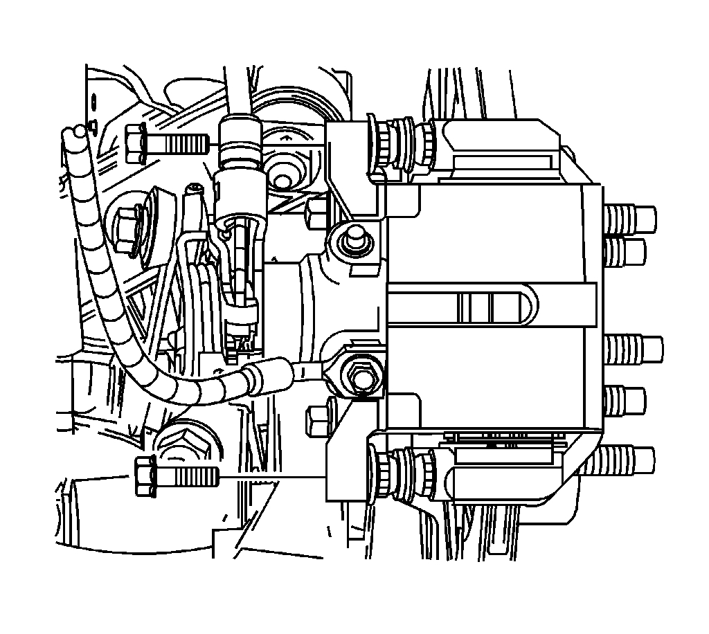

13. Remove the 2 brake caliper pin bolts.
pic 4
14. Remove the park brake cable from the caliper.
15. Remove the brake caliper from the brake caliper bracket.

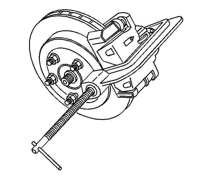

Installation Procedure
1. Inspect the caliper slide boots for cuts, tears, or deterioration. If damaged, replace the slides and boots.
pic 5

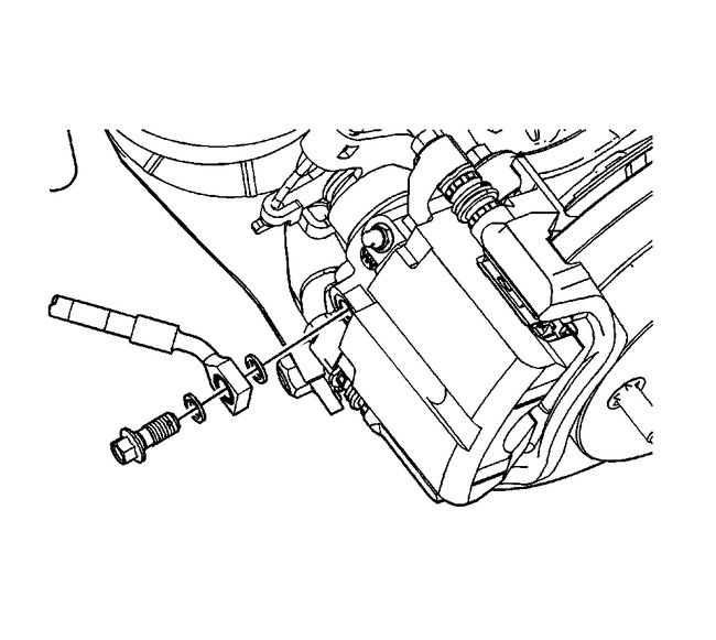

5. Remove the caps or plugs from the brake caliper opening and the brake hose.
6. Important: DO NOT reuse the copper brake hose gaskets.
Install NEW copper brake hose gaskets to the brake hose-to-caliper bolt and to the brake hose.
7. Install the brake hose and the brake hose-to-caliper bolt to the brake caliper.
Tighten the brake caliper bolt to 50 Nm (37 lb ft).

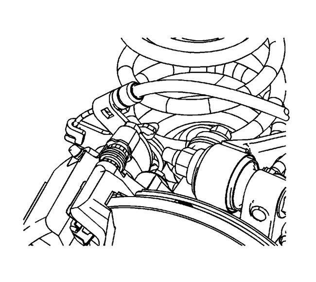

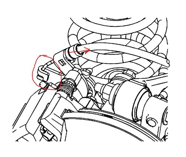

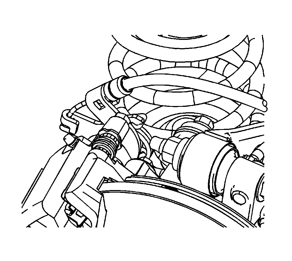

I'm having a hard time figuring out how to remove the parking brake cable from the caliper.
Jun 13, 2019 at 12:05 AM
  • 110,244 POSTS
Welcome back:
Make sure the parking brake is fully released. I attached a picture. I circled the end needs removed and have an arrow pointing the direction to pull the cable to take it off the bracket. Pull back on the cable to remove it from the bracket, then the other end will come off. Now, if there is still too much tension on the cable to do this, you will need to completely remove tension from the cable. I have the directions for cable replacement. You will need to follow them to a point because the cable isn't actually being replaced. You just need to see how it comes apart.
Pic 1 shows the first thing I suggested. The remaining pics will correlate with these directions. All you really need to do is remove the tension from that cable.

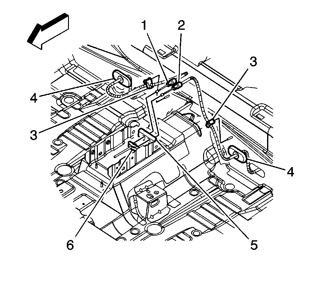

4. Remove the right rear park brake cable (1) or the left rear park brake cable (2) from the console park brake bracket (5) and the front park brake cable equalizer (6).
5. Raise and support the vehicle.
pic 3
6. Remove the plastic retainer clip (1) from the body.

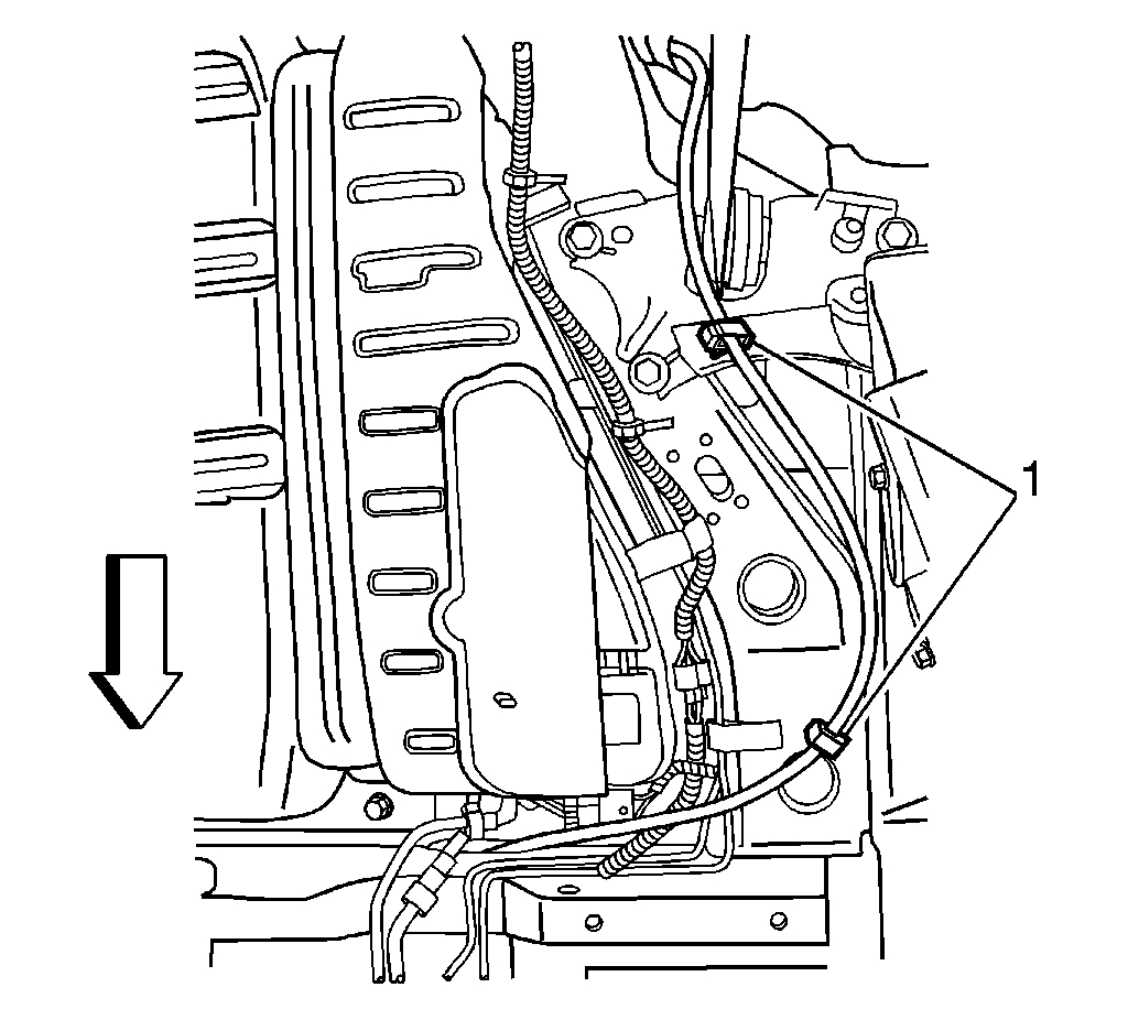

pic 4

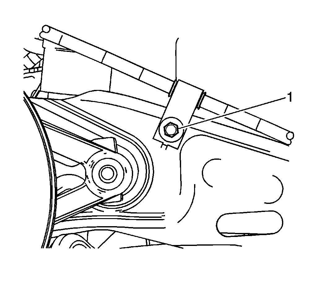

8. Remove the rear park brake cable retainer bolt (1).

11. Remove the plastic retainer clip (3) from the stud.
12. Remove the park brake cable and pass-thru grommet (4) from the body and remove the cable from the vehicle.

Tighten the bolt to 10 Nm (89 inch lbs.).
