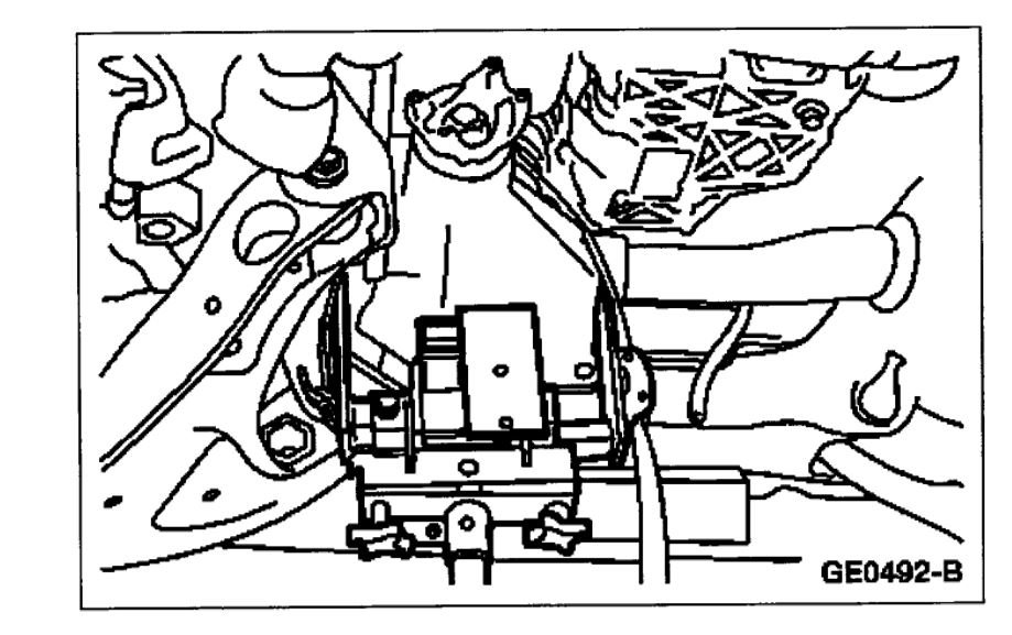

I have a humming noise as i decelerate and a clunking while turning sharply. I was told something inside the front differential was broken and it had to be replaced . I called a few transmission shops they had no clue about it. Is the front differential replaceable by myself? If so how would i got about doing that? Also, this is an all wheel drive vehicle.

Yes, it is replaceable by itself. It is a big job and you need a lift to perform this operation. Below is the procedure and a picture attached of the differential.

Secure the axle housing to a suitable lift.
imageZoom/Print
imageZoom/Print
12. Remove and discard the bolts.
13. Lower the axle 25 mm (1 inch) and move to the right 19 mm (0.75 inch), guiding the LH axle halfshaft out of the axle.
