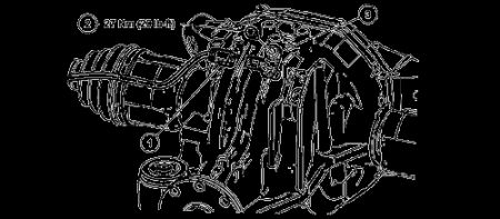

How do I replace the rear differential speed sensor on 2002 Ford Explorer?

This is a very simple job. One bolt, one electrical connector, and one o-ring. Here are the actuall directions: 1.With the vehicle in NEUTRAL, position it on a hoist. NOTE Apply electrical grease to the connector terminals. 2.Disconnect the wheel speed sensor electrical connector. 3.Remove the wheel speed sensor bolt. NOTE Install a new O-ring. 4.Remove the wheel speed sensor. 5.Installation is the reverse of the removal procedure. Tighten the speed sensor bolt to 20 ft. lbs. (27 Nm).
https://images.2carpros.com/forum/automotive_pictures/249084_6_5.jpg
Let me know if you have other questions. Joe
