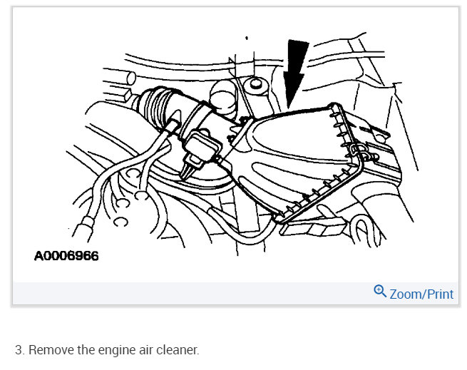

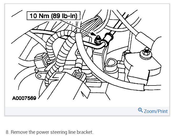

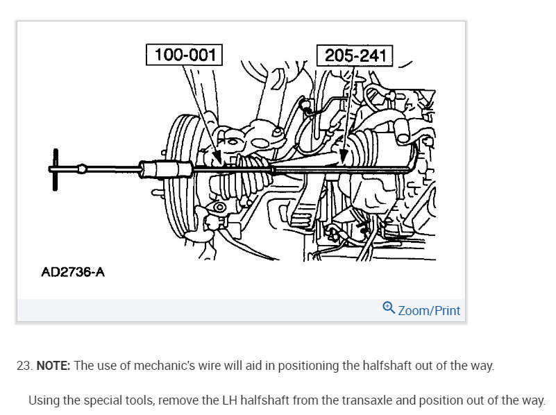

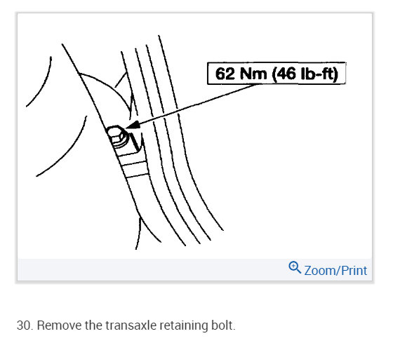

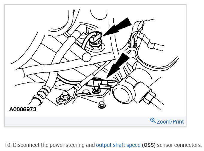

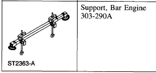

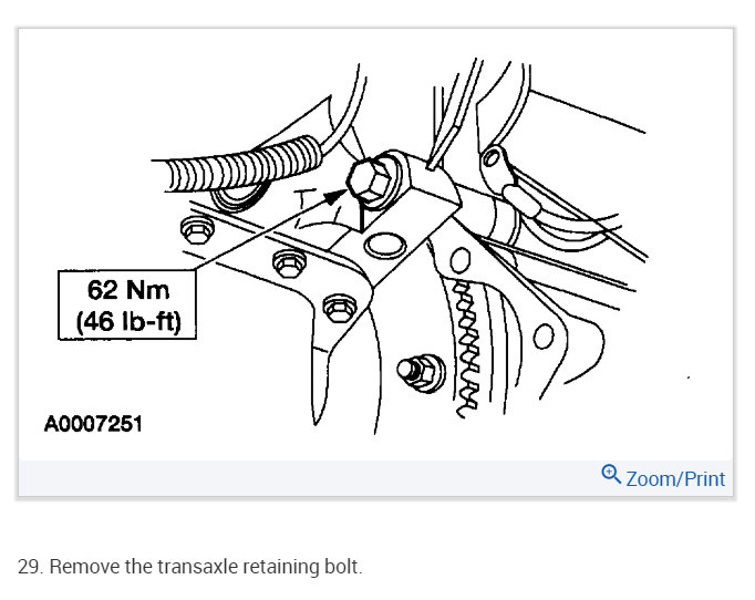

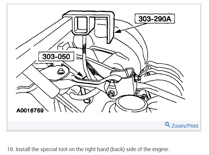

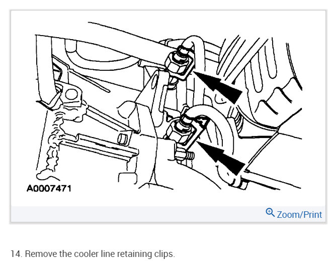

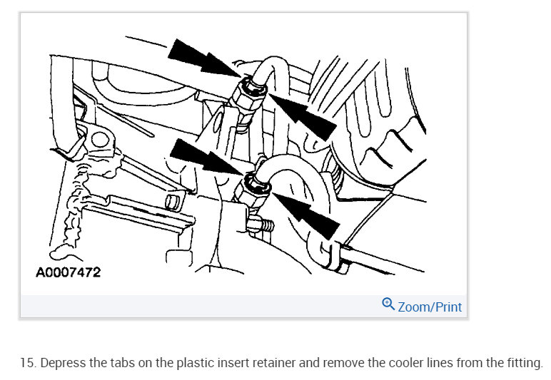

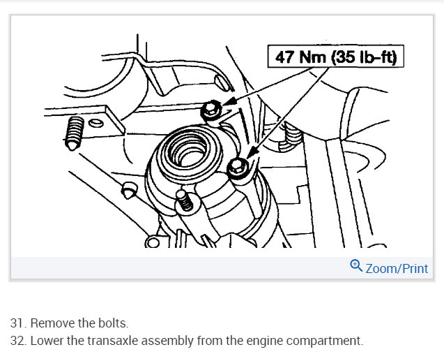

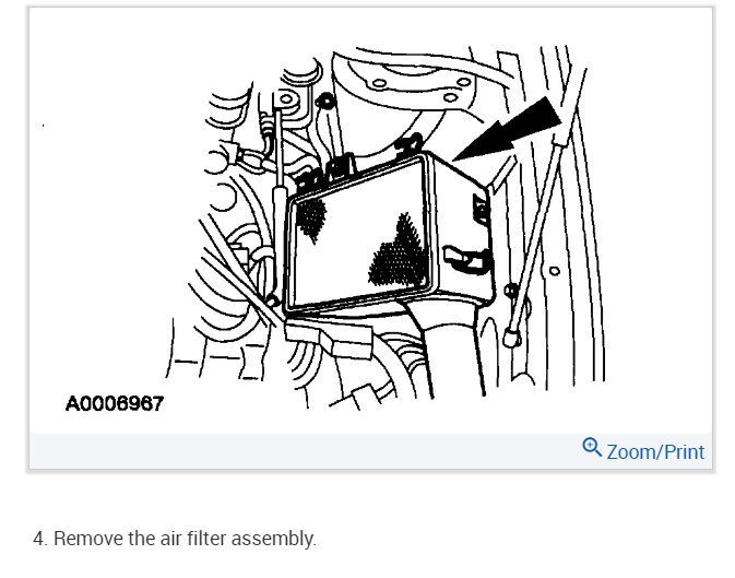

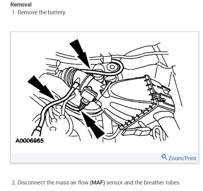

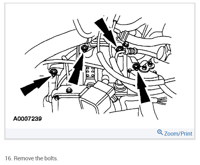

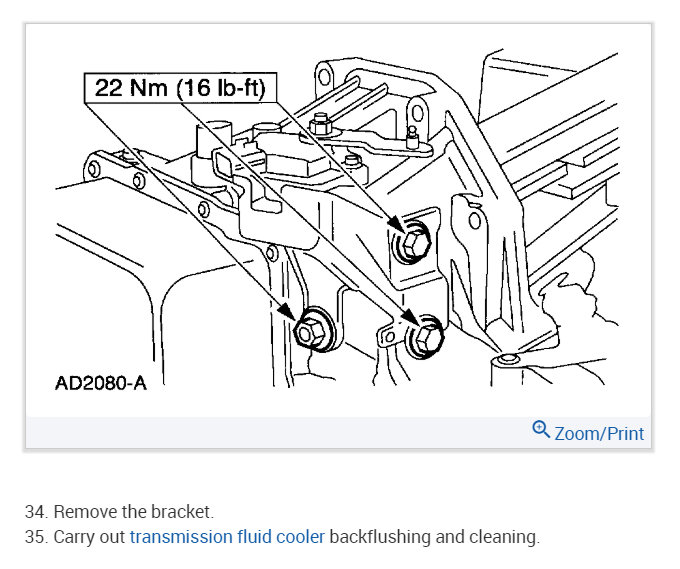

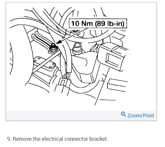

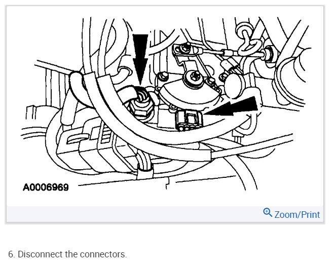

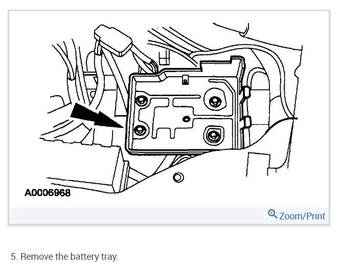

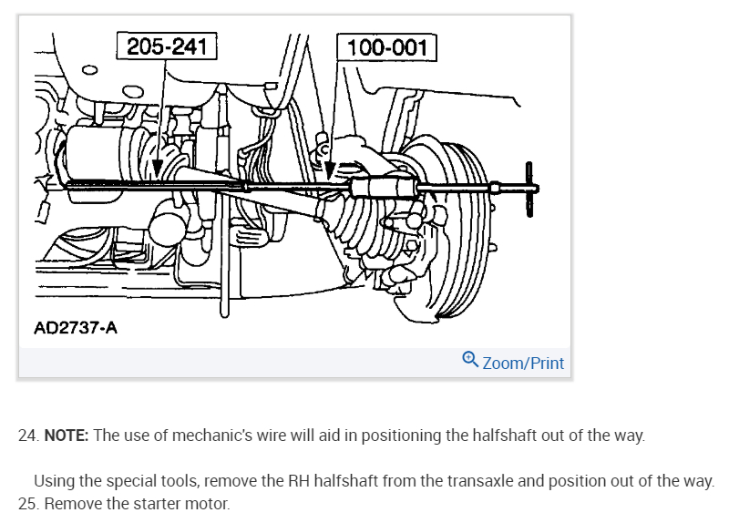

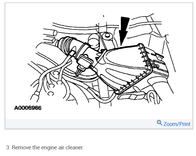

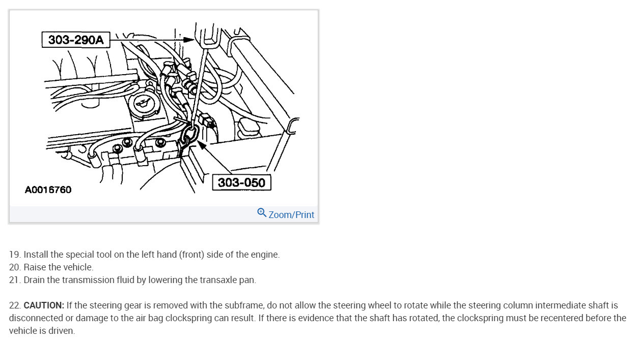

how long does it usually take to replace a flywheel/flexplate
Apr 13, 2016 at 5:13 AM
HMAC300
  • 48,601 POSTS

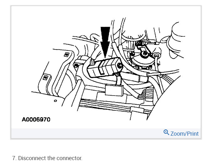

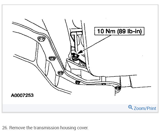

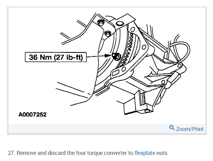

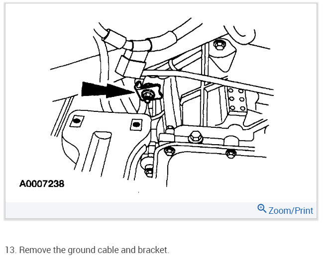

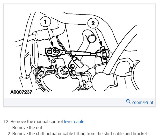

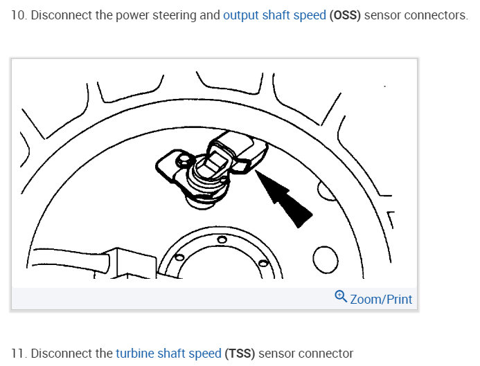

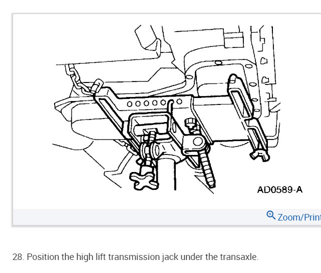

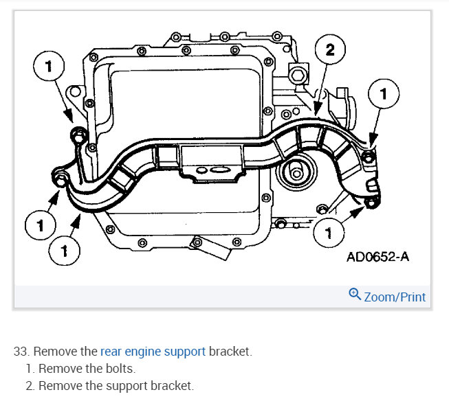

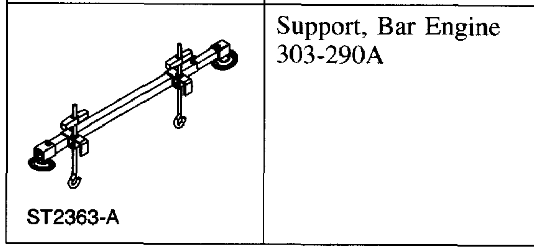

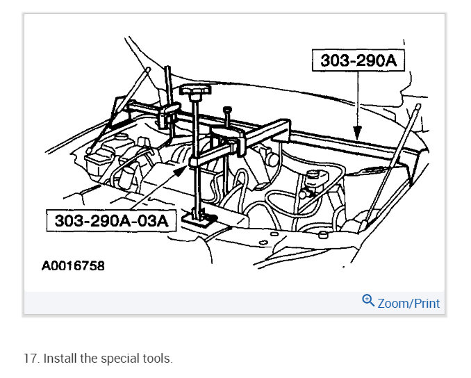

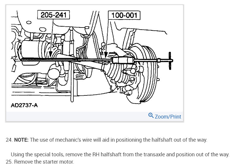

This is a big job and takes about 8.5 hours at the shops labor rate of $85.00 to would be $722.50 Here is a video and diagrams below to show you what it will take to change the flywheel.
This video will give you an idea of how the pull the transmission, its a different car but the procedure is the same.
https://youtu.be/6N6b5F2ChyE
Cheers

Either that or remove the transmission. The flywheel / flex plate is between the transmission and engine and connects the two of them together. It is indeed a big job to replace it. You can expect it to take between six and eight hours.

do i have to drop the transmission to remove the flywheel.
Oct 1, 2018 at 4:57 AM (Merged)
MHPAUTOS
  • 31,937 POSTS
Hi there,
yes you must remove the transmission.
mark (mhpautos)
MERLIN2021
  • 17,250 POSTS
Yes...sorry!
