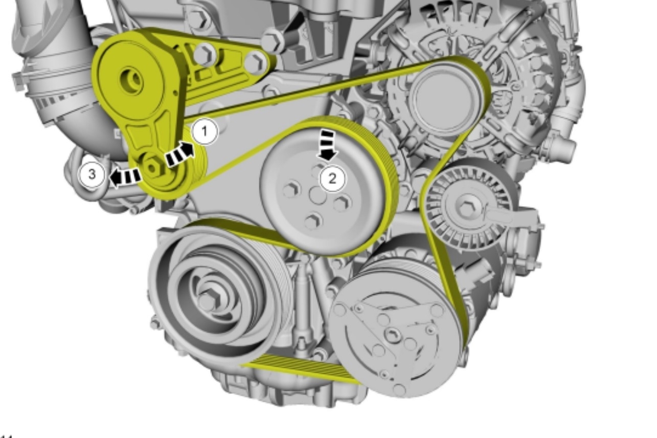

I'm replacing my alternator I need a diagram of the serpentine belt so that I can get to the tension pulley to take belt off and replace alternator.

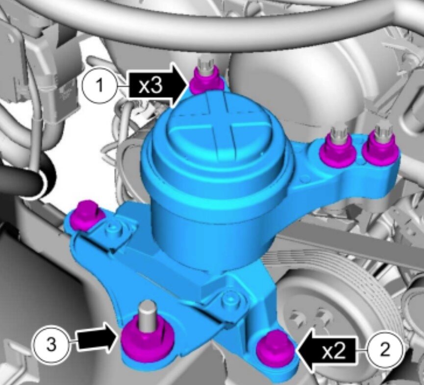

Here is the diagram. FYI to get the belt off you need to loosen the tensioner bolts. The catch to that is that the engine mount bolts to the tensioner, so you need to support the engine, then remove the mount for access. I have been able to coax the belt in between the tensioner pulley and the front case so you may want to try that first.

Suggested Repair
Support the engine, remove the mount that bolts to the tensioner, then loosen the tensioner bolts to remove the serpentine belt. First try working the belt between the tensioner pulley and the front case.
