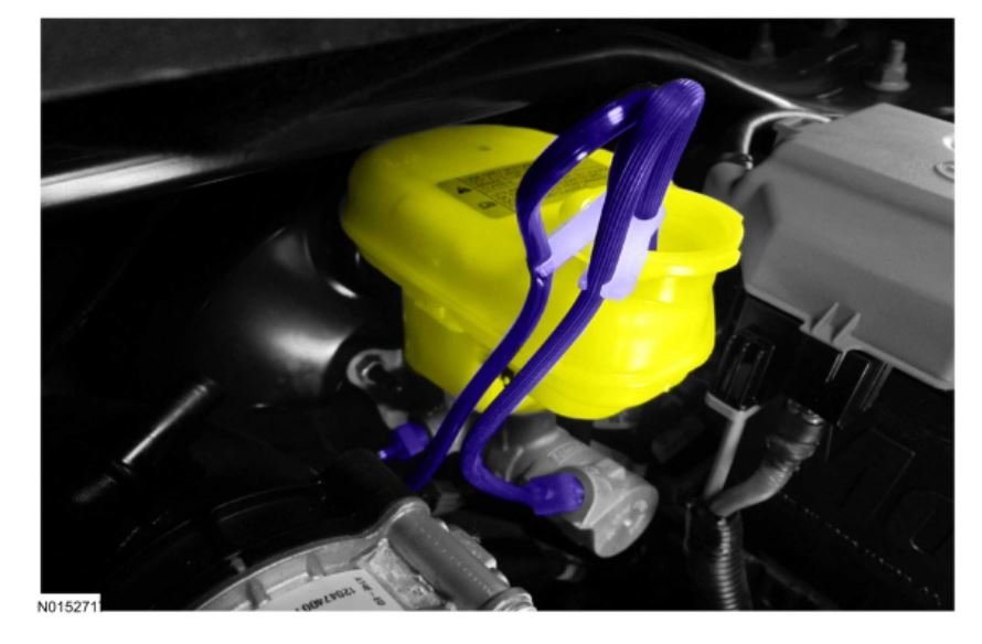

I would suspect there is air in the lines. These guides can help you fix it.
https://youtu.be/w7gUsj2us0U
and
https://youtu.be/WDxvEQrMkBg
and
https://www.2carpros.com/articles/brake-pedal-goes-to-the-floor
As far as bleeding, you can't do it on this vehicle in a traditional way. It requires pressurized bleeding. Here are the directions. The attached pics correlate with these directions. Note that the brake pedal going to the floor is likely the result of air in the system. However, the master cylinder itself may have failed internally if the pedal has gone to the floor.

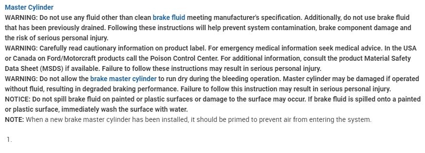

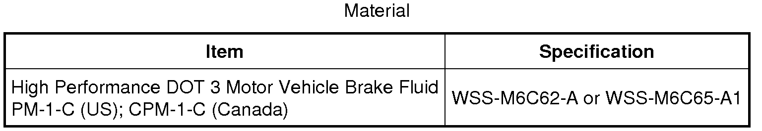

Brake System Bleeding
Pressure Bleeding

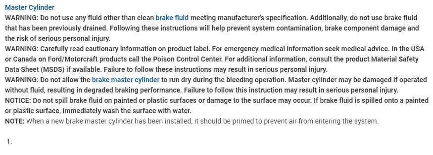

WARNING: Do not use any fluid other than clean brake fluid meeting manufacturer's specification. Additionally, do not use brake fluid that has been previously drained. Following these instructions will help prevent system contamination, brake component damage and the risk of serious personal injury.
WARNING: Carefully read cautionary information on product label. For EMERGENCY MEDICAL INFORMATION seek medical advice. In the USA or Canada on Ford/Motorcraft products call: 1-800-959-3673. For additional information, consult the product Material Safety Data Sheet (MSDS) if available. Failure to follow these instructions may result in serious personal injury.
WARNING: Do not allow the brake master cylinder to run dry during the bleeding operation. Master cylinder may be damaged if operated without fluid, resulting in degraded braking performance. Failure to follow this instruction may result in serious personal injury.
NOTICE: Do not spill brake fluid on painted or plastic surfaces or damage to the surface may occur. If brake fluid is spilled onto a painted or plastic surface, immediately wash the surface with water.

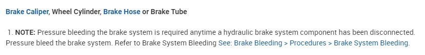

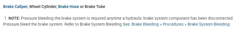

NOTE: Due to the complexity of the fluid path within the hydraulic system, it is necessary to pressure bleed the system.
NOTE: When any part of the hydraulic system has been disconnected for repair or installation of new components, air can get into the system and cause spongy brake pedal action. This requires bleeding of the hydraulic system after it has been correctly connected.
NOTE: Due to the complexity of the fluid path within the rear integral parking brake calipers, it is necessary to press and release the parking brake during the bleed procedure.
NOTE: The Hydraulic Control Unit (HCU) bleeding procedure must be carried out if the HCU or any components upstream of the HCU are installed new.

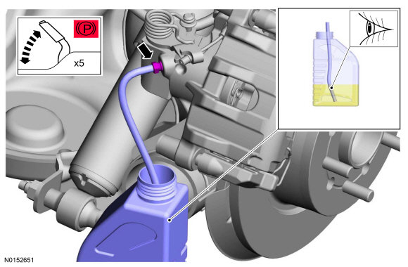

All vehicles

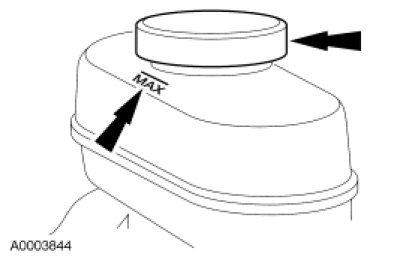

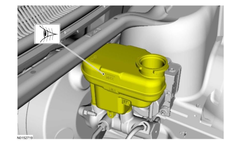

1. Clean all the dirt from around the brake fluid reservoir cap and remove the cap. Fill the brake master cylinder reservoir with clean, specified brake fluid.
2. NOTE: Master cylinder pressure bleeder adapter tools are available from various manufacturers of pressure bleeding equipment. Follow the instructions of the manufacturer when installing the adapter.
Install the bleeder adapter to the brake master cylinder reservoir and attach the bleeder tank hose to the fitting on the adapter.
3. NOTE: Make sure the bleeder tank contains enough specified brake fluid to complete the bleeding operation.
Open the valve on the bleeder tank.
- Apply 207-345 kPa (30-50 psi) to the brake system.

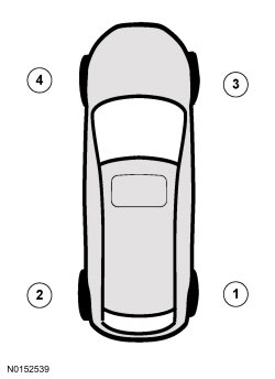

4. Remove the RH rear bleeder cap and place a box-end wrench on the bleeder screw. Attach a rubber drain tube to the RH rear bleeder screw and submerge the free end of the tube in a container partially filled with clean, specified brake fluid.
5. Loosen the RH rear bleeder screw. Leave open until clear, bubble-free brake fluid flows, then tighten the RH rear bleeder screw.
- Press and release the parking brake 5 times.
- Repeat until clear, bubble-free fluid comes out.
6. Tighten the RH rear bleeder screw to specifications, refer to Specifications. Remove the rubber hose and install the bleeder screw cap.
7. Repeat Steps 4 through 6 for the LH rear brake caliper.
8. Remove the RH front bleeder cap and place a box-end wrench on the bleeder screw. Attach a rubber drain tube to the RH front bleeder screw and submerge the free end of the tube in a container partially filled with clean, specified brake fluid.
9. Loosen the RH front bleeder screw. Leave open until clear, bubble-free brake fluid flows, then tighten the RH front bleeder screw.
10. Tighten the LH rear bleeder screw to specifications, refer to Specifications. Remove the rubber hose and install the bleeder screw cap.
11. Repeat Steps 8 through 10 for the LH front brake caliper.
12. Close the bleeder tank valve and release the pressure. Remove the tank hose from the adapter and remove the adapter. Fill the reservoir with clean, specified brake fluid and install the reservoir cap.

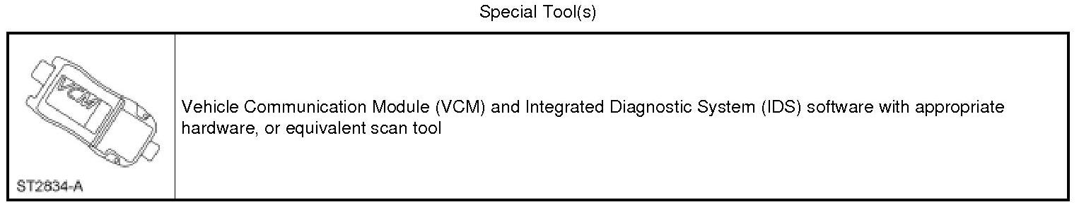

Hydraulic Control Unit (HCU) Bleeding
NOTE: When any part of the hydraulic system is disconnected for repair or installation of new components, air can get into the system and cause spongy brake pedal action. This requires bleeding of the hydraulic system after it is correctly connected.
All vehicles
1. Use the Pressure Bleeding procedure to bleed the system. For additional information, refer to Brake System Bleeding.
2. Connect the scan tool and follow the ABS HCU Hydraulic Control Unit (HCU) bleeding instructions.
3. Repeat the Pressure Bleeding procedure to bleed the system.
Hybrid vehicles
4. Following the scan tool instructions, carry out the Multi-Calibration Routine.

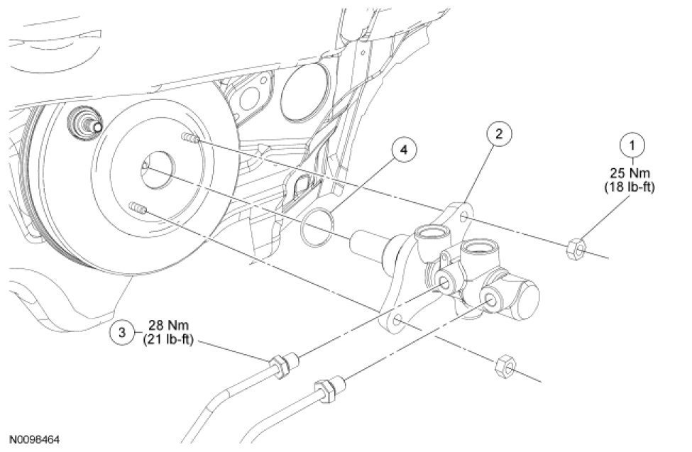

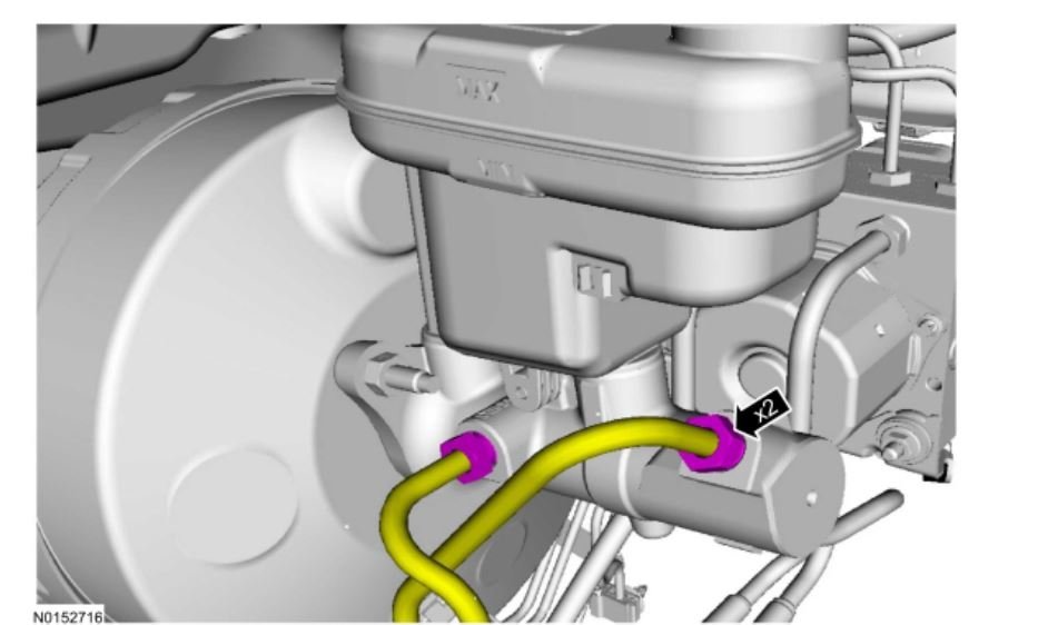

Hi Randy and thanks for using 2CarPros.com Even if the booster is bad, you should still have a pedal. If the pedal is going to the floor, review this link and see if anything of the items discussed could be an issue for you. My biggest concern is that you have a used master cylinder. There is a chance it is bad even though you were told differently.

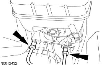

I did some research for you and found the following test from Alldata:
Component Tests
Brake Master Cylinder - Bypass Condition
Disconnect the brake tubes from the master cylinder.
Plug the outlet ports of the master cylinder.
Note: Make sure the outlet port plugs do not show signs of leakage.
Lightly apply the brakes and hold for 10 seconds. Release the brakes and then reapply with heavy force. If brake pedal height cannot be maintained, the brake master cylinder has an internal leak and a new brake master cylinder must be installed.
This will at least indicate if the master cylinder is bad. Keeping in mind, if there are no leaks, you should get SOME pedal.
