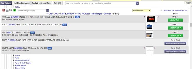

Have replaced batteries three times for a total of six batteries in my truck listed above (diesel). Ford replaced them with the same Motorcraft batteries they use. Since they have a problem with Motorcraft, I need to know what battery and size would be a better replacement. As I will never use Motorcraft again they are junk batteries! I live in south Florida where heat plays a factor.

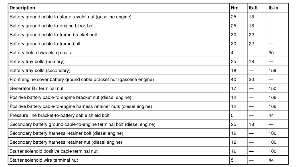

Also, make sure the cables are clean and tight both at the battery and the starter, block and alternator. Bad connections will also cause an issue with batteries failing.
I attached a chart for you to check some connections.

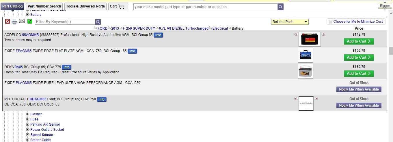

Cannot locate or match criteria for group 27 1100 cca batteries anywhere. Motorcraft battery that is in truck is BXT-65-750. What would be an Optima equivalent? After I get batteries, will have charging system checked, and not by Ford!
Nov 23, 2018 at 9:04 PM
Okay, the group number is 65 by what you gave me. It is only 750 CCA. That is low. It should be much more. The batteries are too small in capacity. That may be the reason for the failure.
I attached a list from rockauto. They list the Exide battery needed at 930CCA. The others are a cheap replacement.
You could call around to parts houses for price and availability of those batteries. They are the ones I would use.
