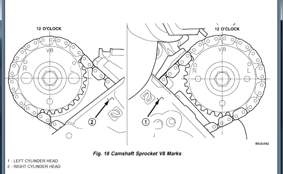

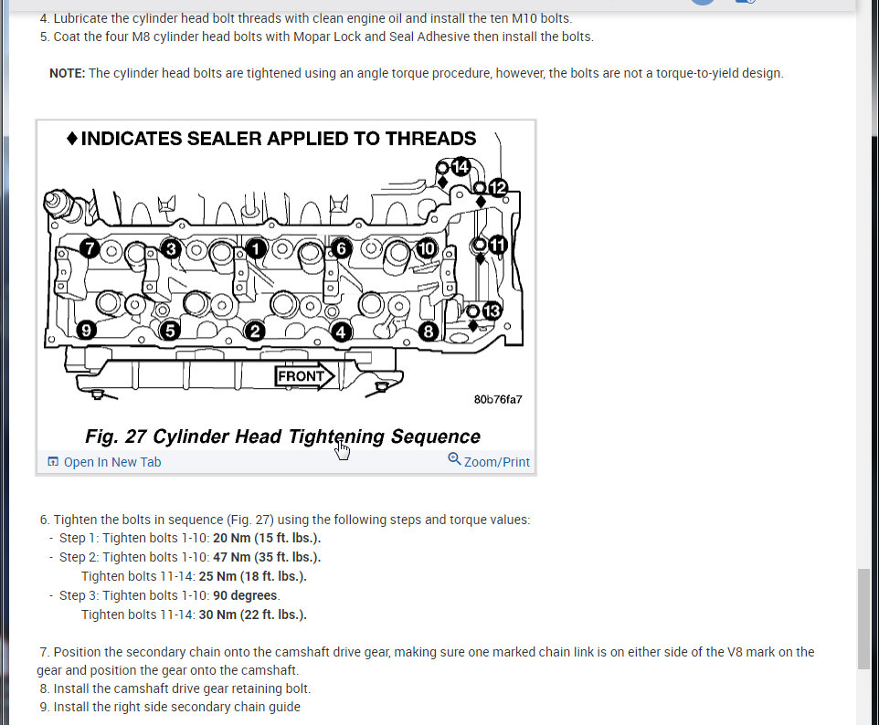

i replaced a head on my 4.7 because one of the casings was cracked and threw a rocker off. I have built and torn down 5 different times with all marks perfect but truck will barely stays running. i am going crazy and have to be in LA on Monday. can anyone help me? when i installed new camshaft i just used bolts to tighten it down onto the rockers. was i supposed to do something different? please help!
Dec 5, 2020 at 12:53 AM
  • 110,244 POSTS
If you are certain timing is correct, have you checked to see if there are any diagnostic trouble codes that may indicate a specific cylinder misfire? Are there any engine vacuum leaks?
As for the camshaft, they tighten in a specific sequence. Here are directions for removal and replacement. The attached pics correlate with the directions. See if there is anything you missed or did differently.

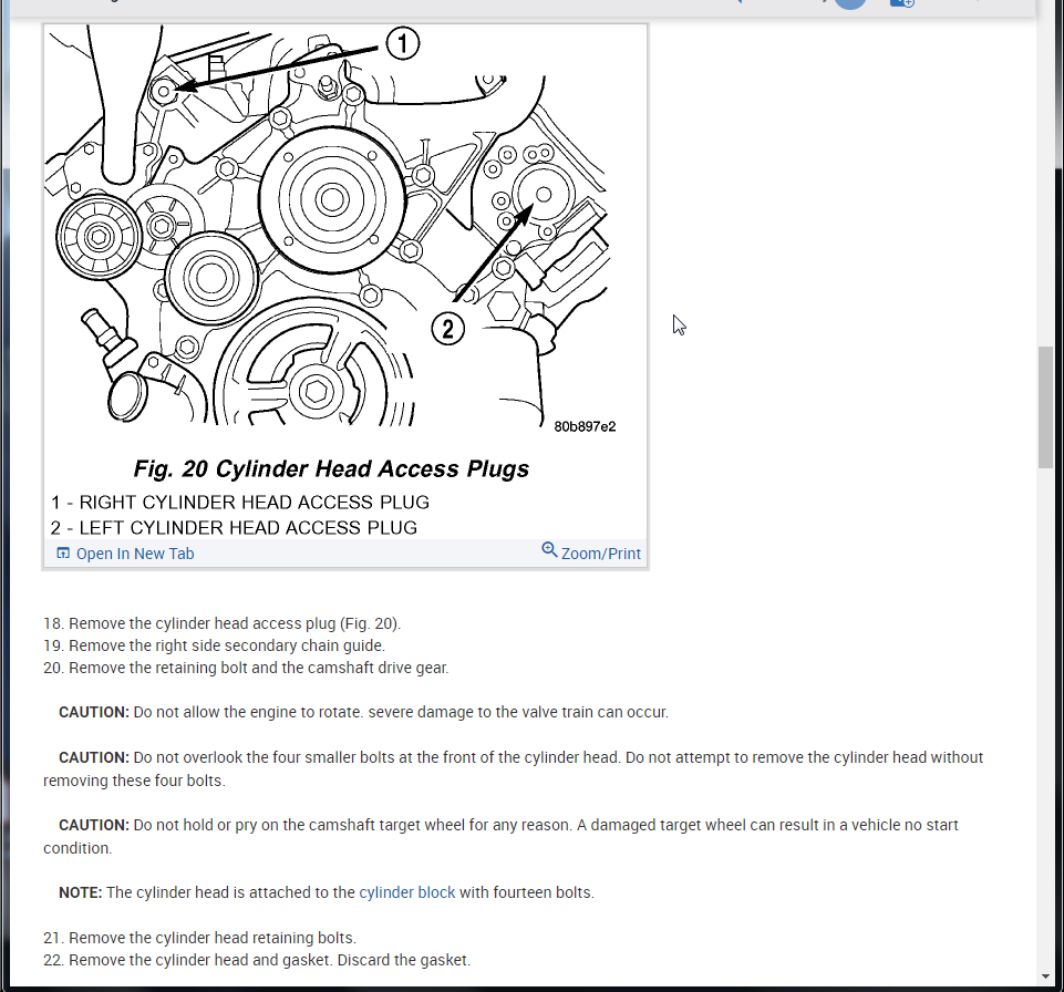

CAUTION: When removing the cam sprocket, timing chains or camshaft, Failure to use Special Tool 8350 will result in hydraulic tensioner ratchet over extension, requiring timing chain cover removal to reset the tensioner ratchet.

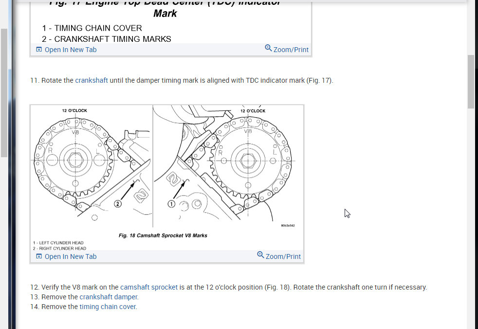

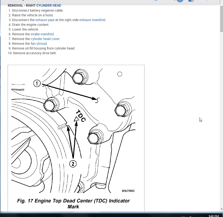

2. Set engine to TDC cylinder # 1, camshaft sprocket V8 marks at the 12 o'clock position.
3. Mark one link on the secondary timing chain on both sides of the V8 mark on the camshaft sprocket to aid in installation.

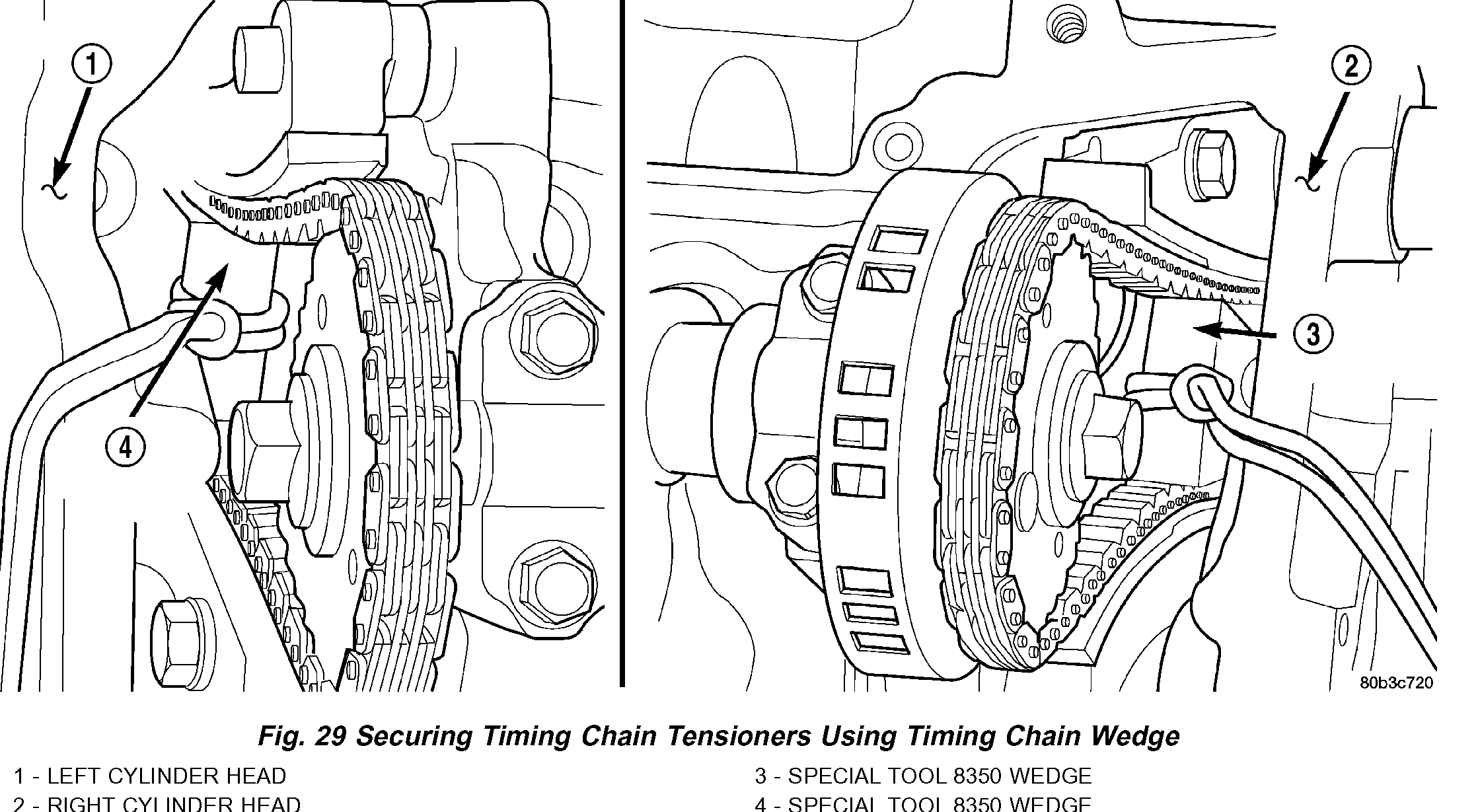

NOTE: The timing chain tensioners must be secured prior to removing the camshaft sprockets. Failure to secure tensioners will allow the tensioners to extend, requiring timing chain cover removal in order to reset tensioners.
CAUTION: Do not force wedge past the narrowest point between the chain strands. Damage to the tensioners may occur.
pic 1

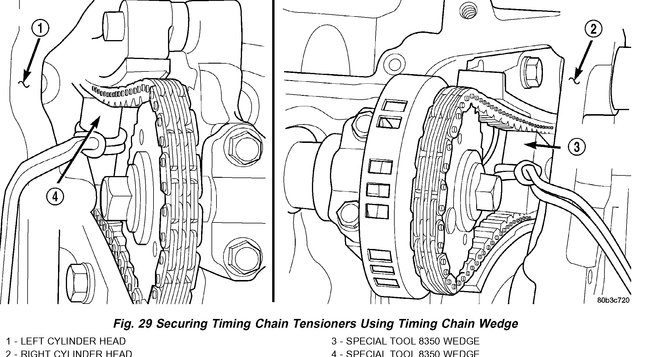

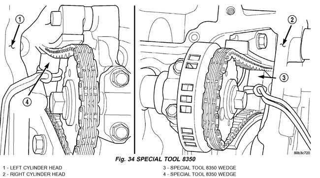

5. Position Special Tool 8350 timing chain wedge between the timing chain strands, tap the tool to securely wedge the timing chain against the tensioner arm and guide (Fig. 29).

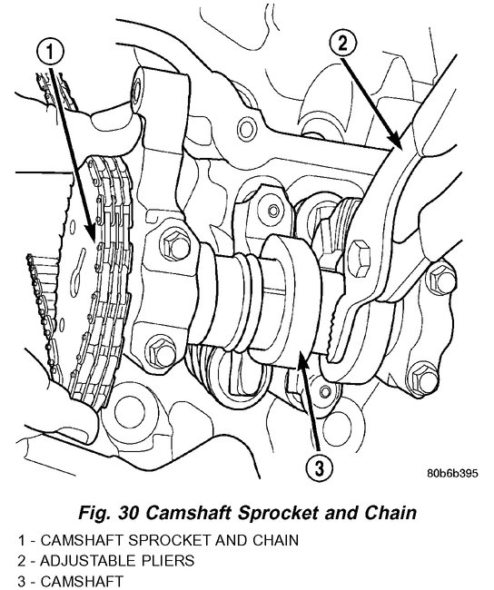

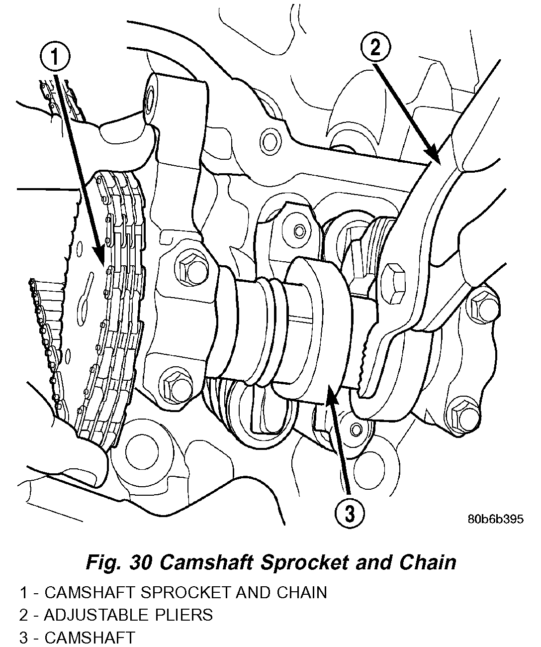

6. Hold the camshaft with adjustable pliers while removing the camshaft sprocket bolt and sprocket (Fig. 30).
7. Using the pliers, gently allow the camshaft to rotate 15° clockwise until the camshaft is in the neutral position (no valve load).

pic 3

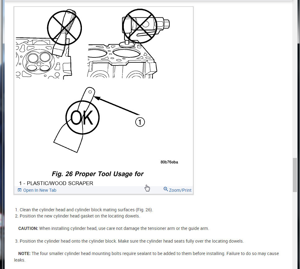

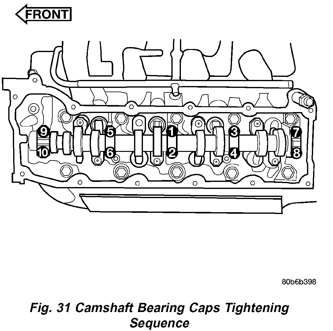

4. Working in 1/2 turn increments, tighten the bearing cap retaining bolts starting with the middle cap working outward (Fig. 31).
5. Torque the camshaft bearing cap retaining bolts to 11 Nm (100 inch lbs.).

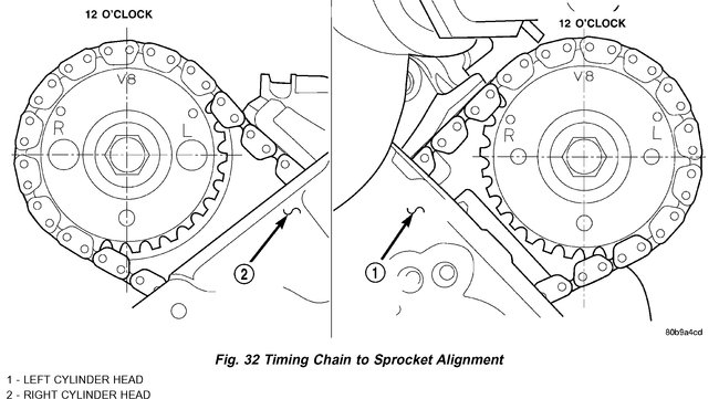

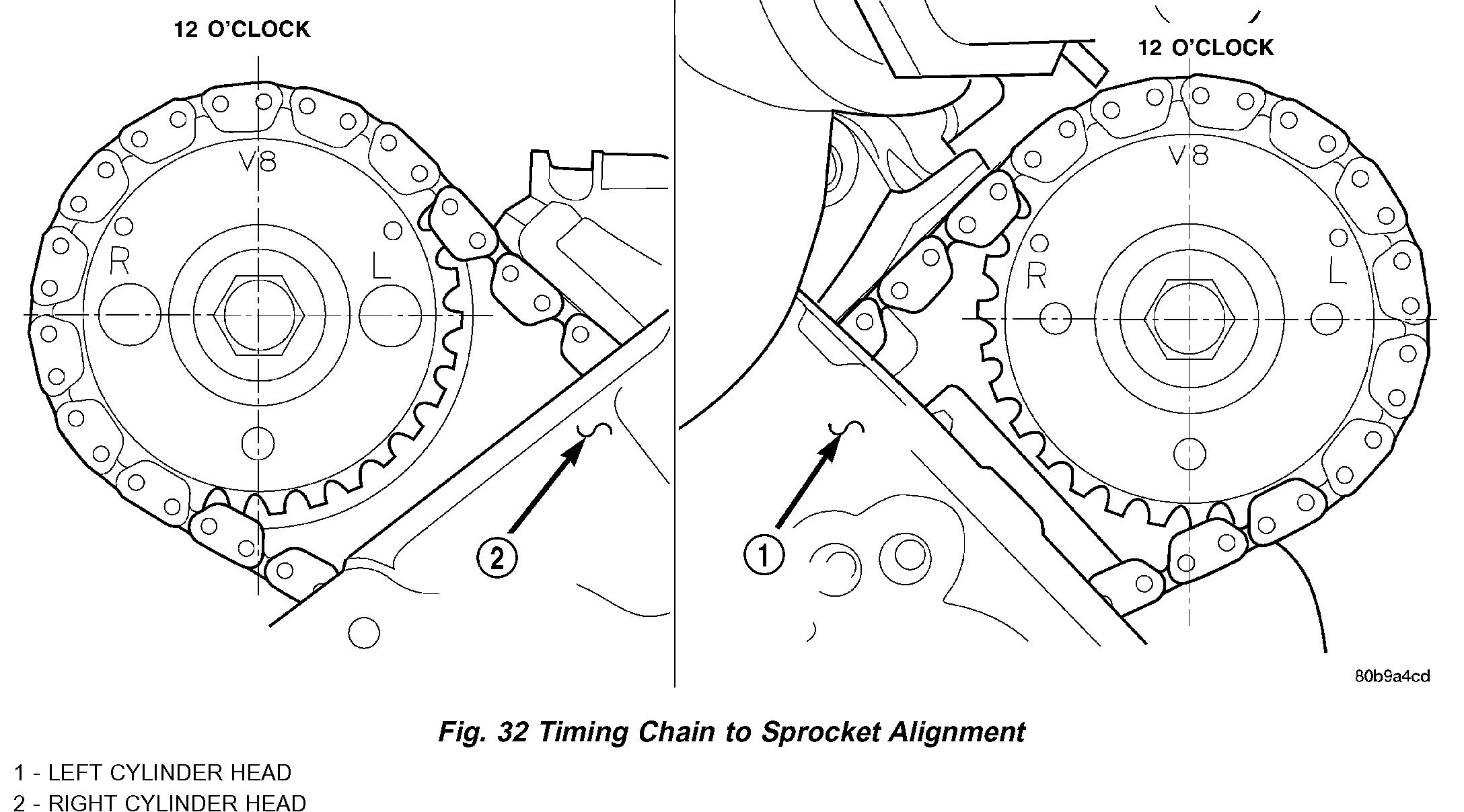

6. Position the camshaft drive gear into the timing chain aligning the V8 mark between the two marked chain links (Two links marked during removal) (Fig. 32).

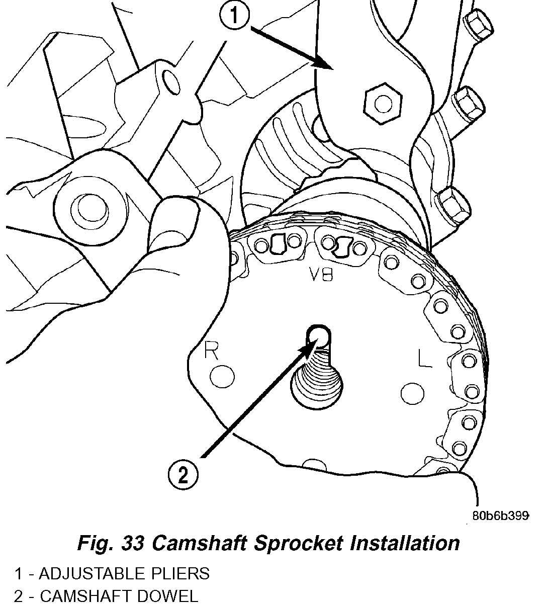

7. Using the adjustable pliers, rotate the camshaft until the camshaft sprocket dowel is aligned with the slot in the camshaft sprocket. Install the sprocket onto the camshaft (Fig. 33).

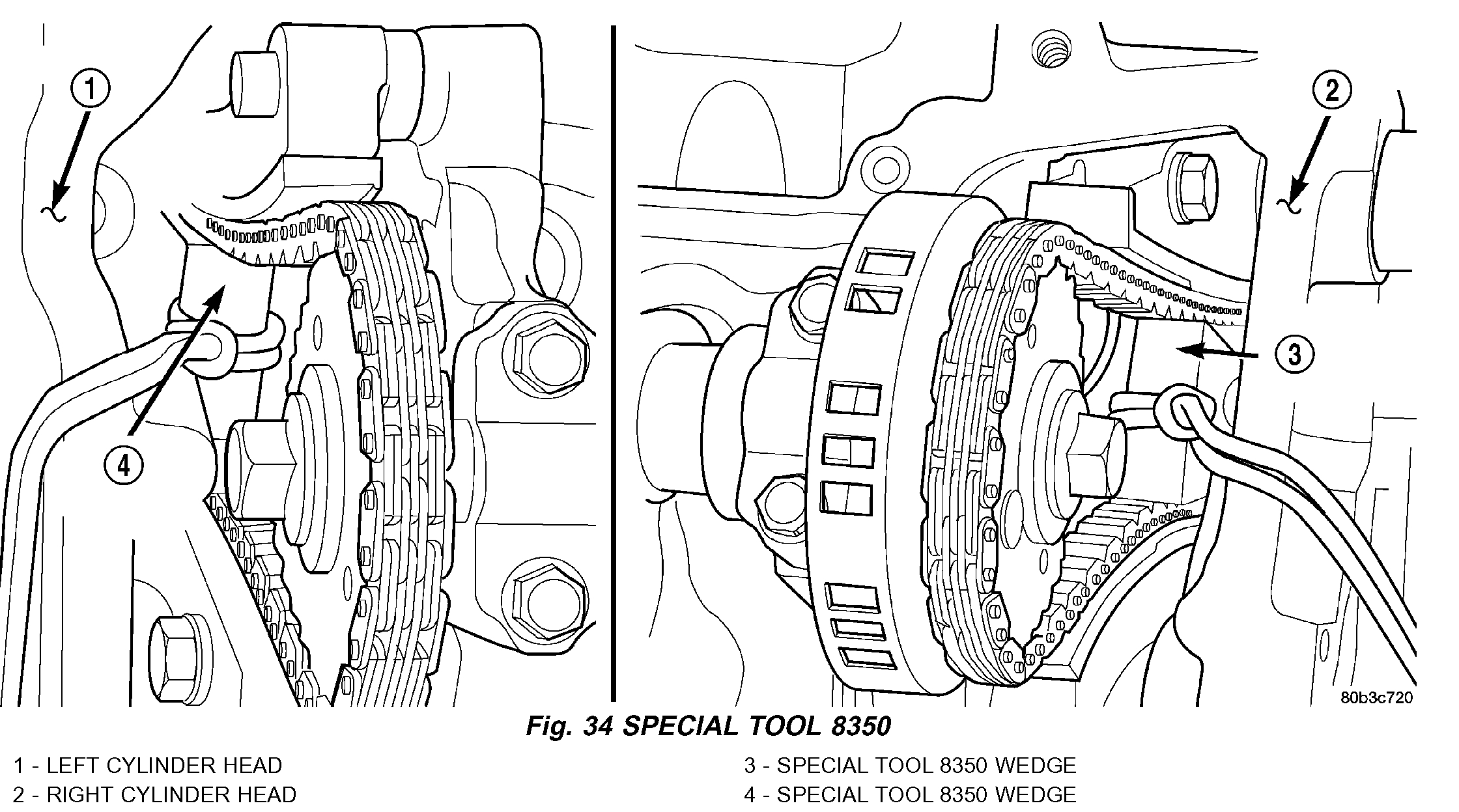

9. Remove Special Tool 8350 timing chain wedge (Fig. 34).

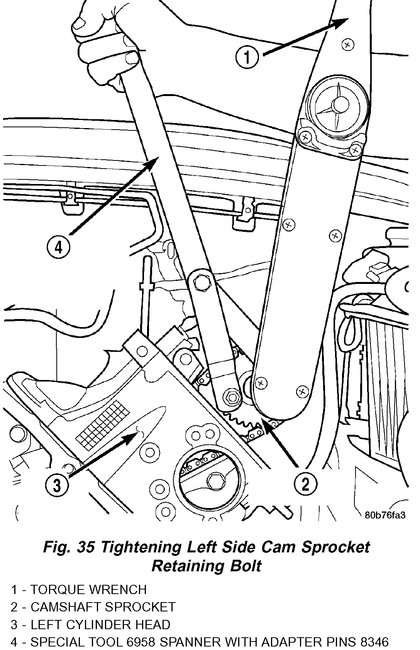

10. Using Special Tool 6958 spanner wrench with adapter pins 8346 (Fig. 35), torque the camshaft sprocket retaining bolt to 122 Nm (90 ft. lbs.).

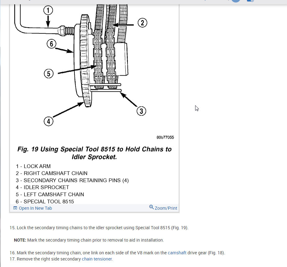

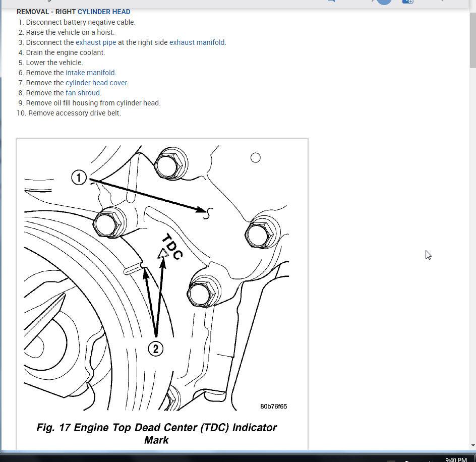

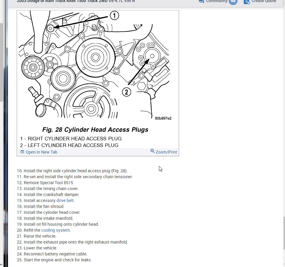

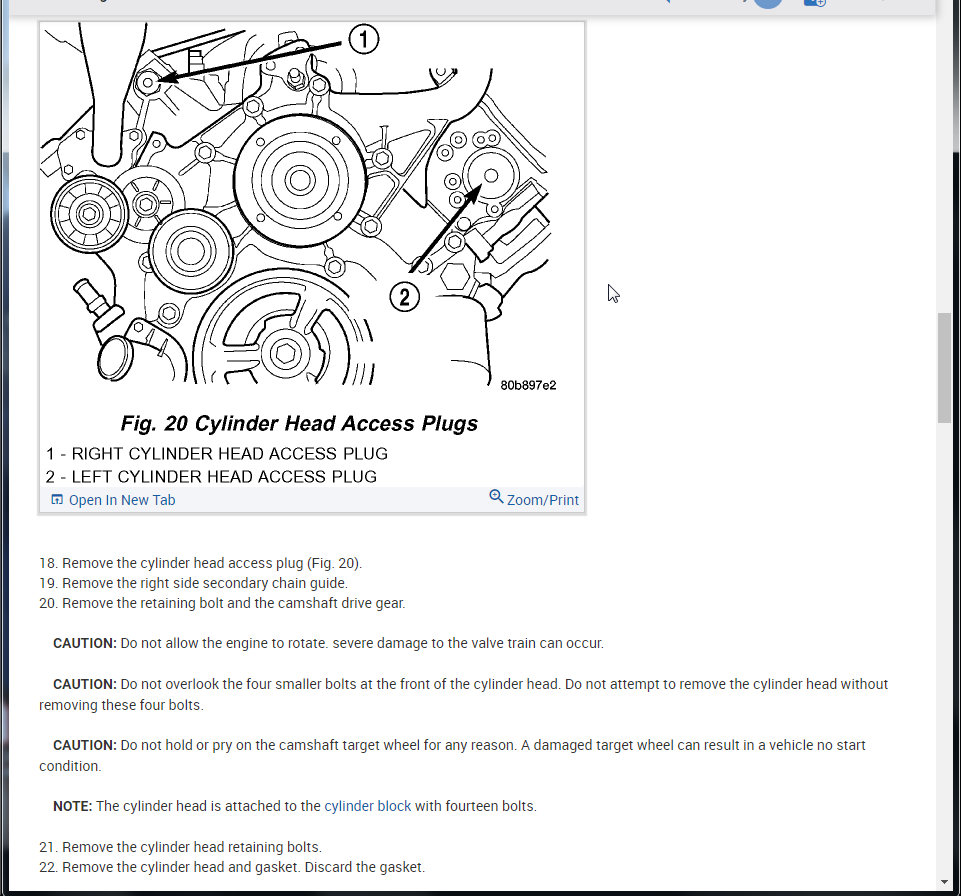

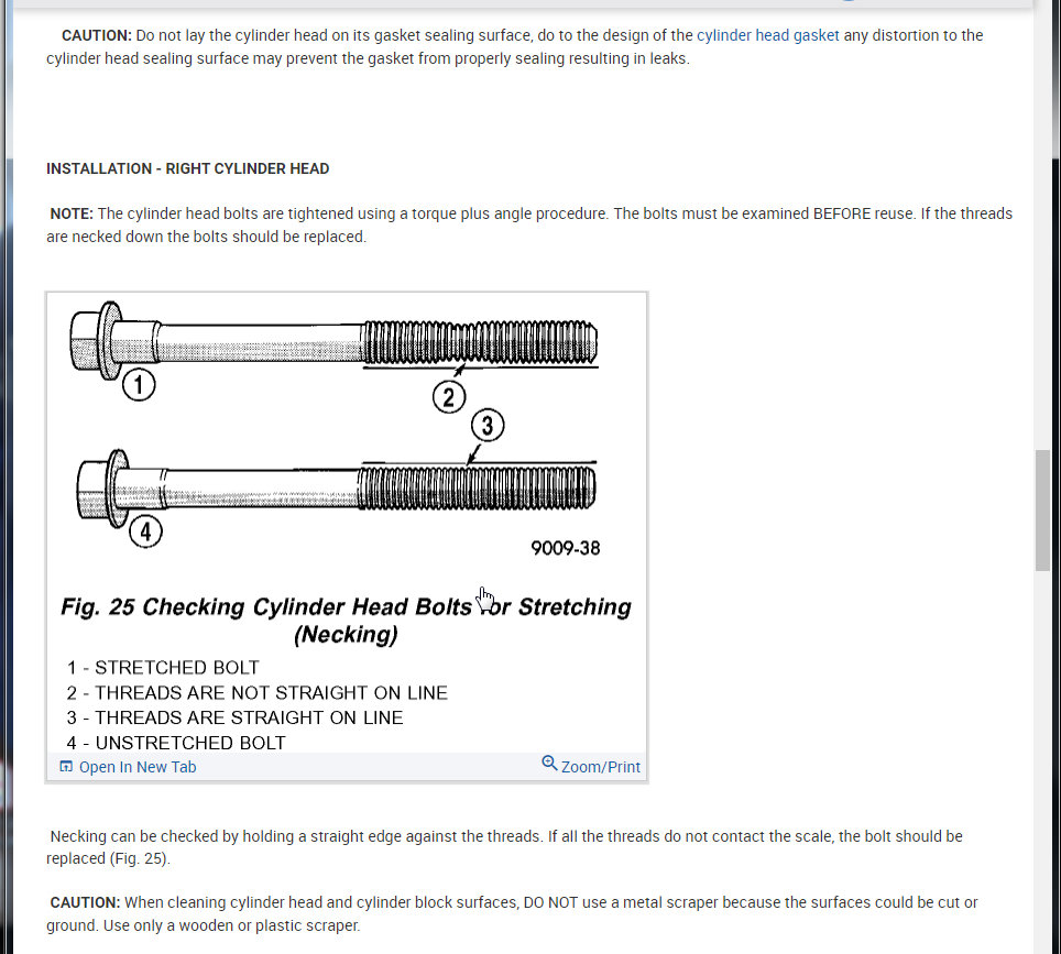

I am not sure what you mean you used bolts to tighten them down. I attached the process for the right head. Take a look at it and let me know what questions you have.
Can you get pictures of what it is you are dealing with and I am sure that will help explain what the issue is. Thanks

I've done all this to a tee except for one thing; when I put the camshaft on I just made sure the v8 was at 12 o'clock and I tightened it down then having previously already set timing chains I just removed camshaft sprocket put chain on and replaced on camshaft. it had zero resistance and I did not have to turn sprocket at all.

As far as there being no resistance on the camshaft, that doesn't sound right. The cam is loaded at all times and will have resistance at all points. When you crank the engine, is the cam turning?
