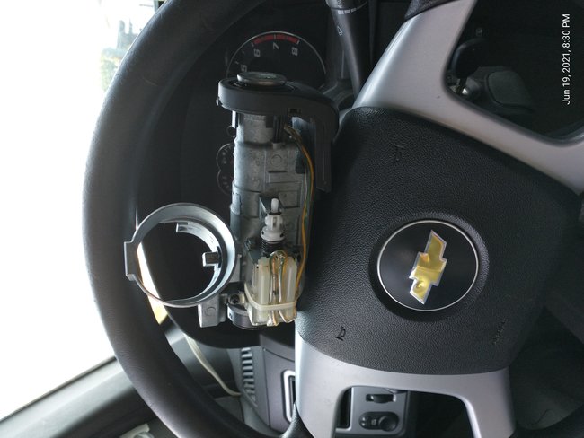

I replaced my ignition switch, cylinder and got new keys. It's actually an entire assembly off of another vehicle. Mine took a dump. Still have off key. A bit worn but, I just installed it. Hadn't tried anything yet. Disconnected battery fully to charge it. Been disconnected bout.. well tomorrow will be 2 days.. is there anything I need to do before I try it tomorrow? Heard talk about programming and whatnots... Hoping was just a plug and play lol.. since it was all one same unit already linked to each other.. everything but my car reckon.. oh, I got a keyless entry with me ignition as well.. didn't have one before..
But was seeing if needed do anything or ..?
Thank you

If you mean you replaced the cylinder and keys you will still need to program it into the system as the transponder chips will be different in the new keys. However it should work to do the 30 minute relearn if those are the only items you changed.
This 30-minute learn procedure should be used when all vehicle keys are desired to be replaced or reprogrammed. This procedure will erase all previously learned vehicle keys from the Theft Deterrent Module. Once the 30-minute learn procedure has been completed, any remaining vehicle keys may be programmed using the Adding Keys procedure to ensure their continued functionality.

It should do the reset if the only parts you changed were the key cylinder and the keys. What did it do with the old switch? Any issues then other than worn? No security light usually means there is an issue with a failure in the system so I would verify that the fuses are all good. Does the security light come on during the initial key on bulb test?

Not that I know of.. key wouldn't turn no matter what I tried.. wheel wouldn't unlock..
Actually no I don't see a security light on initial key turn.. just in message board saying service theft deterrent system.. but when I lock the doors the car and lock light flash.
I replaced the whole thing.. in pic.

Okay, you replaced the entire housing not just the cylinder. For that you do need a scan tool so the system can read the data from the replacement assembly, that is also why no security light, that piece isn't initialized by the PCM so it doesn't show up. The relearn process only works if you change only the key cylinder itself. In this case the system doesn't even know that the key is there. To make it work you will need a dealer level scan tool and a security code that they would have, some mobile locksmiths can also do this depending on your location would determine which is lower cost.
