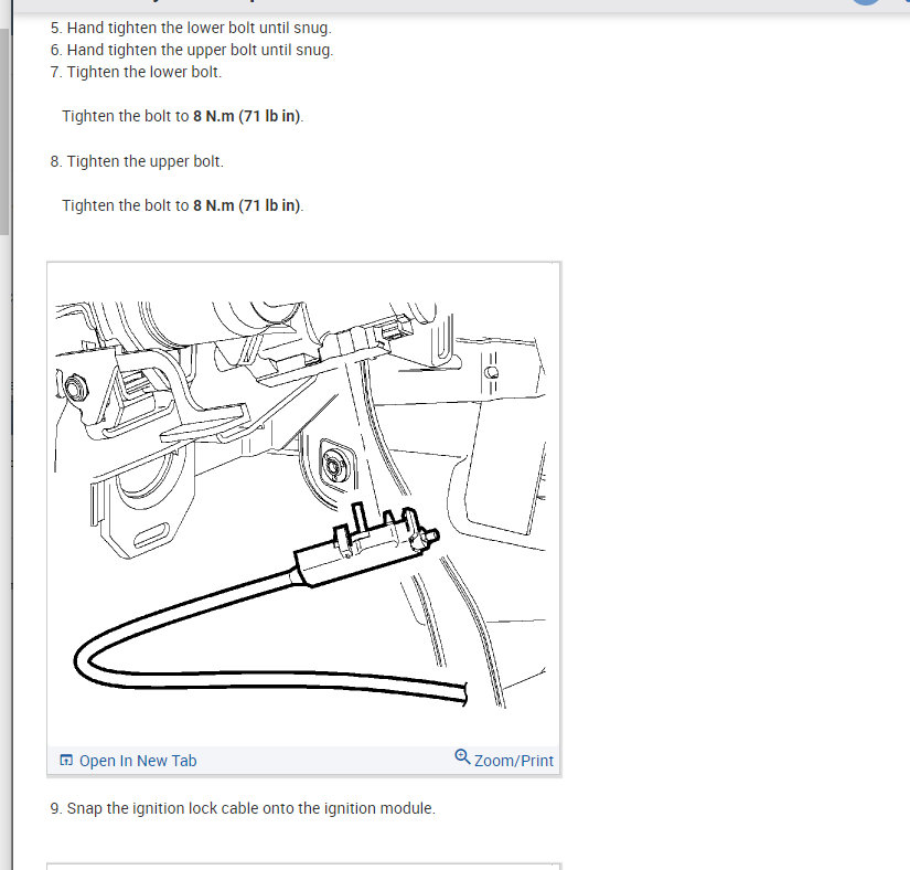

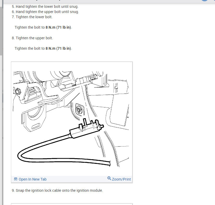

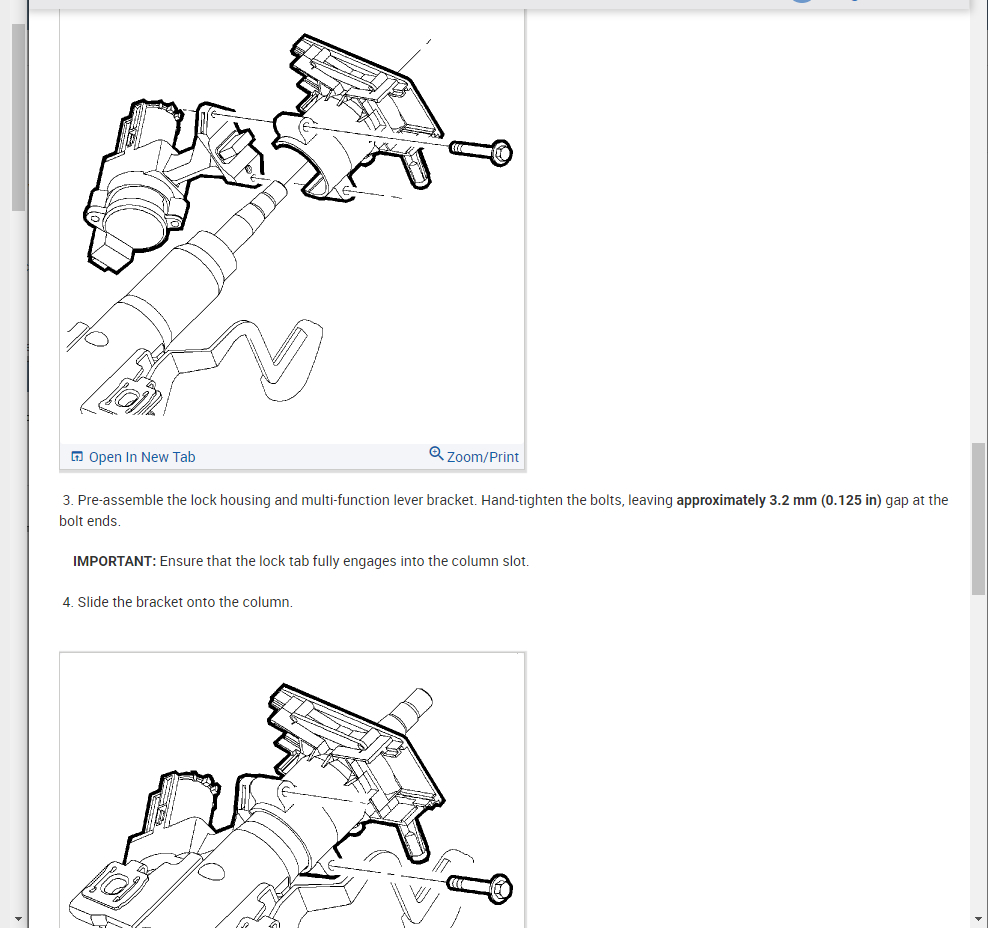

I drove to the gas station got gas and when I restarted car the radio was not working no lights or clock and no usual blinkers noise (blinkers were working i got out and checked). I did my errands starting and stopping the car for a time with no issue aside from no radio or blinker noise. Next morning I went to start car and it would not turn over check engine light would flicker with clicking noise without having key turned over then key would not release. Car would not start up with a jump. I have since gotten key out with ignition release button under steering column.
Dec 28, 2016 at 8:48 AM

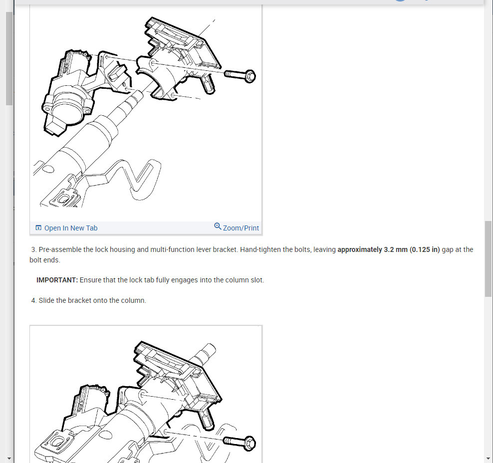

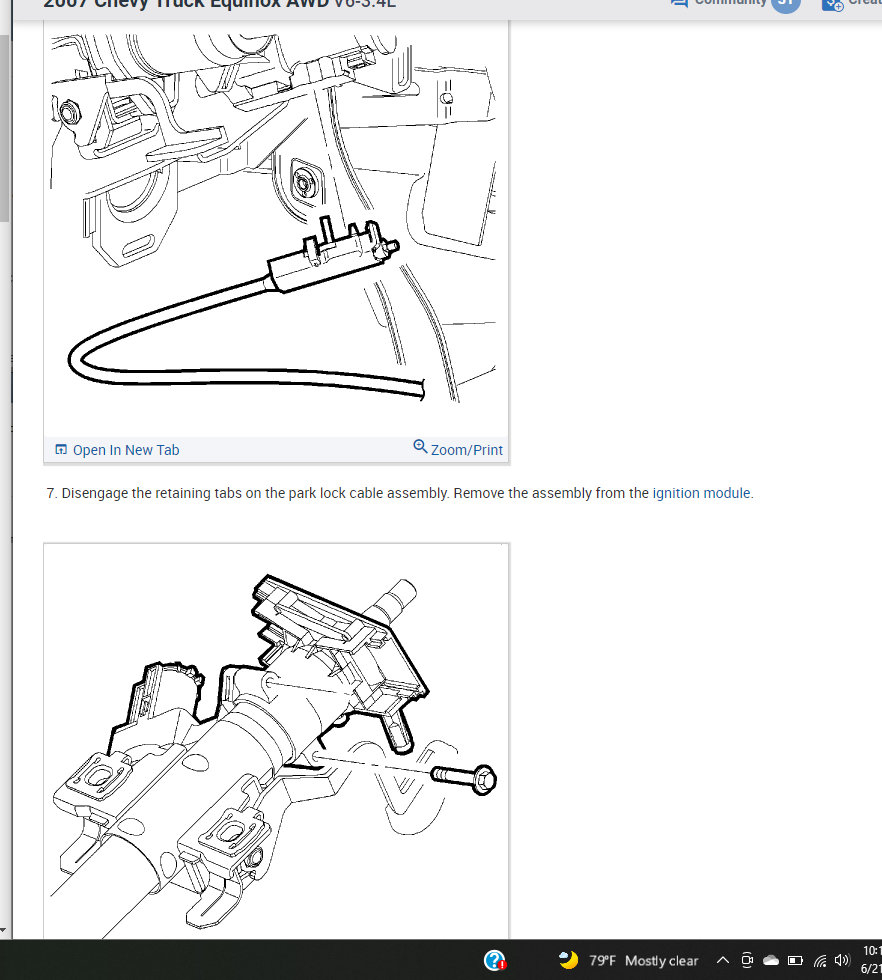

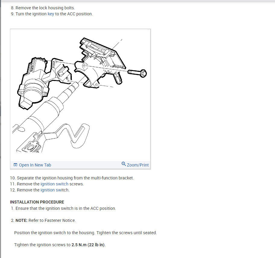

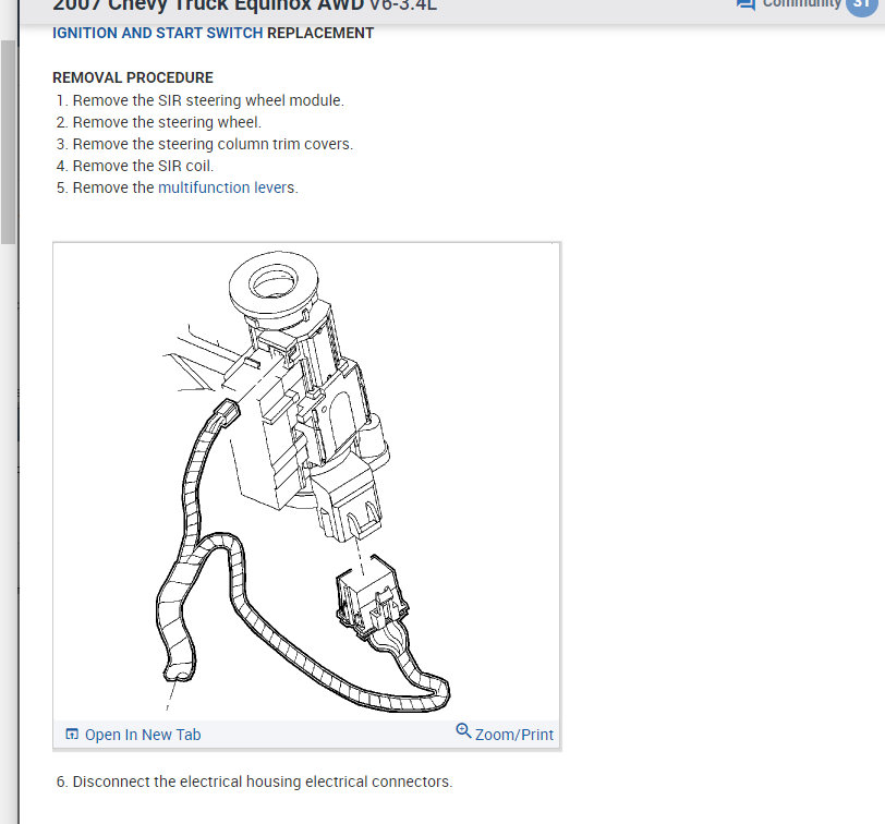

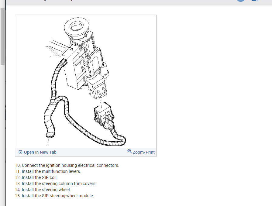

If the ignition was engaging the key not turning then the switch needs to be replaced.
If the key doesn't turn then here is a guide that will help with this issue:
https://www.2carpros.com/articles/ignition-switch-wont-turn-stuck
Please run through this material and then refer to the info below on how to replace the switch.
Let us know if you have other questions. Thanks
