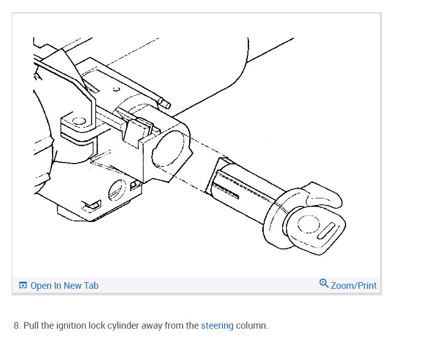

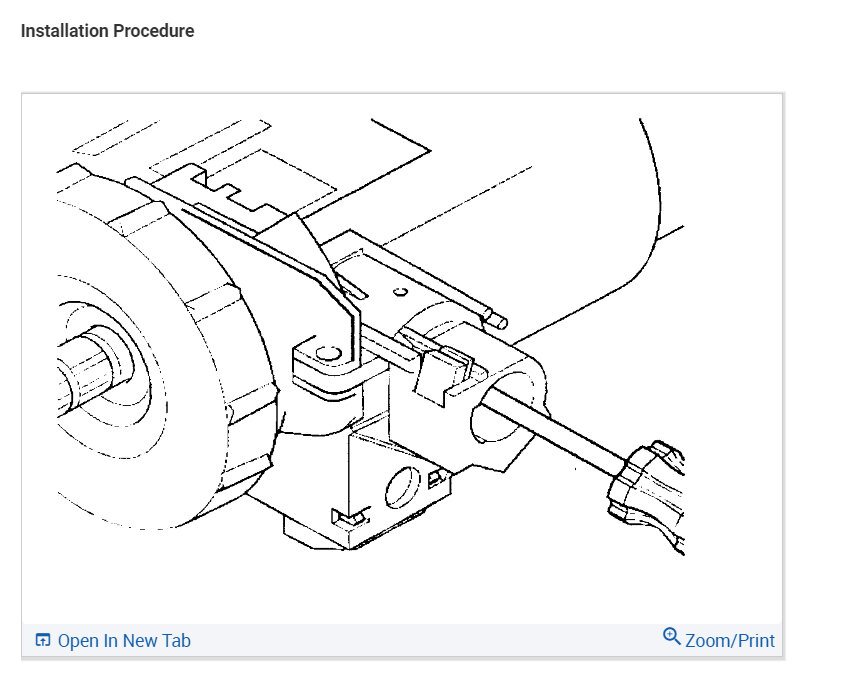

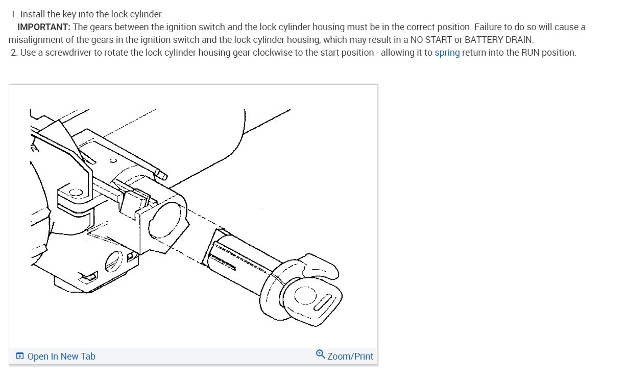

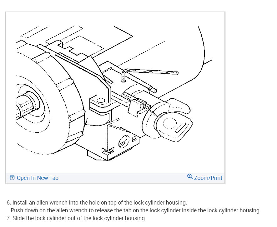

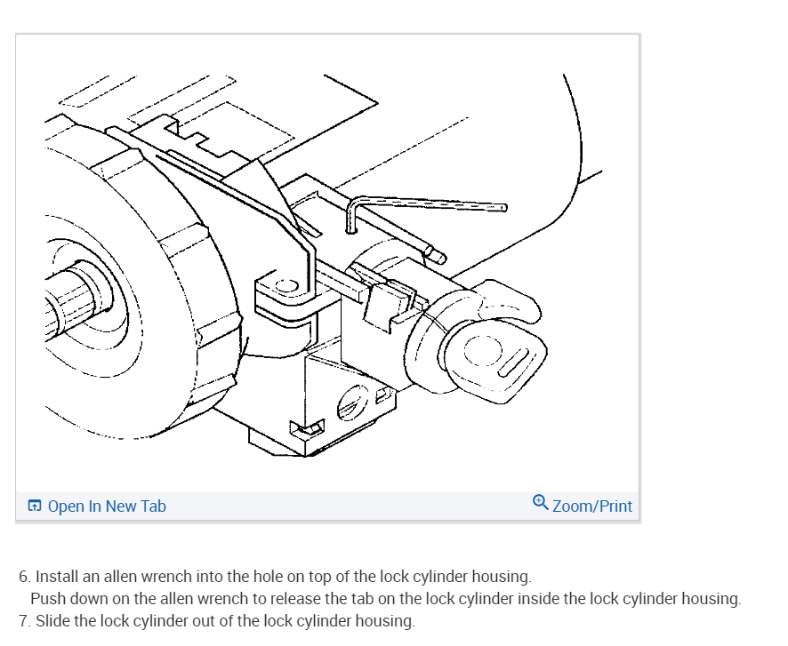

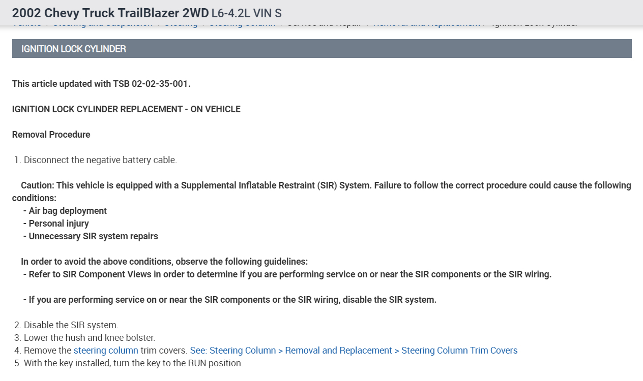

I don't see the images; can you please try again? In the meantime, here are the instructions on how to do the job so you can recheck your work. Also did you have the key coded to the car before you installed it?
Here is an important note when doing the job.
Important: The gears between the ignition switch and the lock cylinder housing must be in the correct position. Failure to do so will cause a misalignment of the gears in the ignition switch and the lock cylinder housing, which may result in a No Start or Battery Drain.
