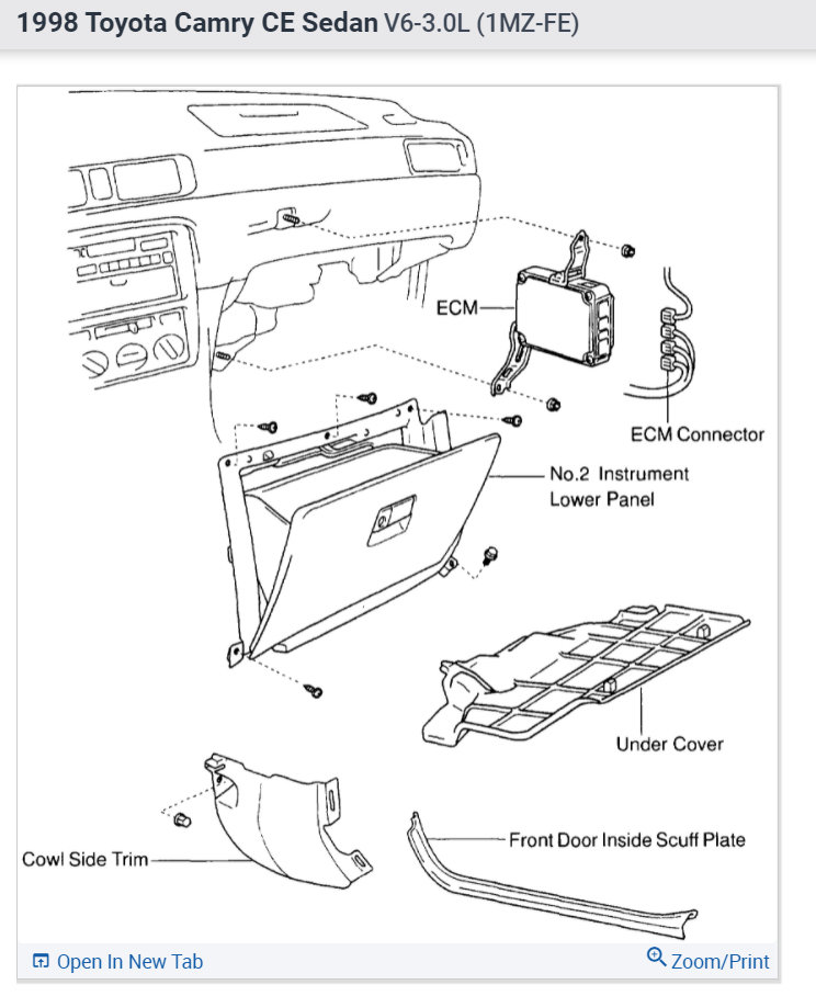

just replaced a bad ECM with a newly reprogrammed one to my VIN but need to reset immobilizer to work with new ECM.
Mar 16, 2022 at 12:56 PM
  • 55,433 POSTS
Yes you need to program the ECM to the ignition key for the ECM to work here are the instructions with diagrams below.

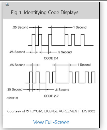

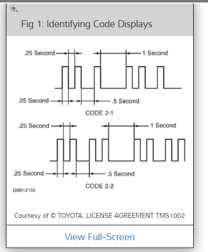

Once ignition key registration is under way, SECURITY indicator light should turn off. After ignition key registration is complete, SECURITY indicator light should come on steady. Remove ignition key.
If the registration was complete and system is operating normally, when ignition key was removed from ignition lock cylinder, the SECURITY indicator light should flash. If ignition key registration was not completed with Engine Control Module (ECM) in automatic registration mode, a code 2-1 will be displayed by SECURITY indicator light, and when inserting the already registered ignition key, a code 2-2 will be displayed by SECURITY indicator light. See Fig 1.

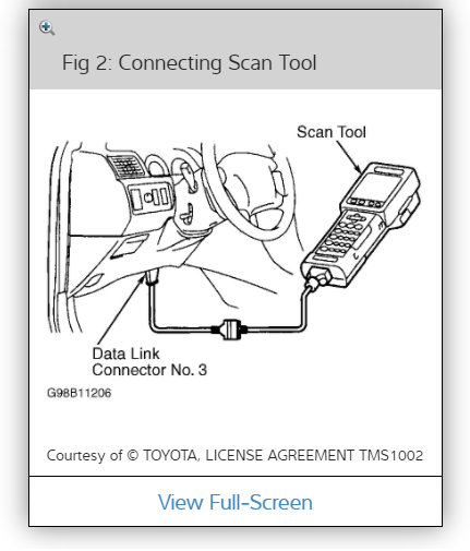

To complete automatic registration mode, depress and release brake pedal at least 5 times within 15 seconds, or request automatic registration mode completion by using Toyota scan tool connected to Data Link Connector (DLC) No. 3. See Fig 2.
