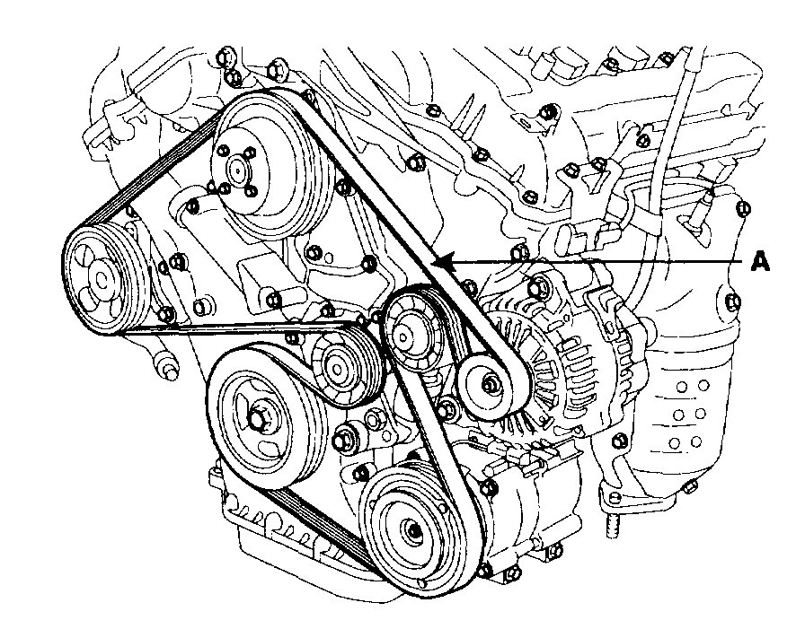

cant get serpentine belt on

First, I attached a picture showing how the belt should be routed. Make sure that is correct and make sure it isn't hanging up on a bracket or other component.
See Pic 1
If it is routed correctly, release the pressure from the automatic tensioner which should allow you to get the belt over the last pulley. Here is a link that describes the tensioner and how it works:
