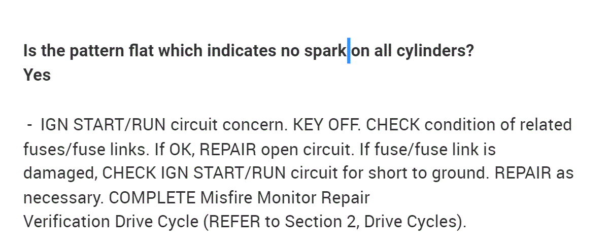

If it does nothing with starting fluid, it's likely ignition related. Take a look below at the first recommendations from the manual. Let me know if these are things you have already done.
Also, I realize you replaced the crankshaft position sensor. Was the original one also not sending an RPM signal?
See pic below.

Joe, yes, the original crankshaft sensor showed no RPMs. Today I got it to run on starting fluid.. I have put a noid led on injectors and they are pausing. I bought aftermarket one.. I'm going to clean old ones and reinstall I bet that I have more issues .. again Joe thank you for your knowledge it helped me to troubleshoot. Thank you
