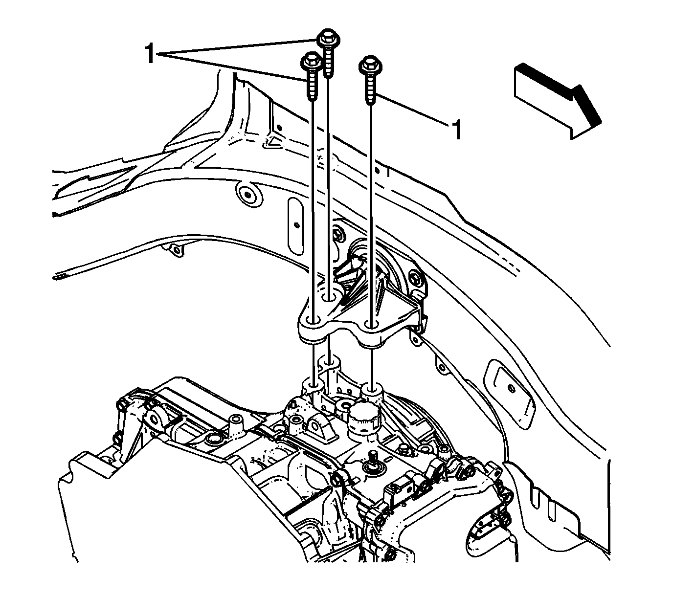

Transmission replacement instructions needed
2010 CHEVROLET EQUINOX
125,000 MILES • 2.4L • 4 CYL • 4WD • AUTOMATIC
JEDWHITING
I'm looking for a step-by-step guide to replace the transmission in my vehicle listed above.
Thanks

There are different transmission options. I will provide directions for both procedures. The attached pics correlate with the directions.
______________________________________
Trans 6T70 / 6Tt75
2010 Chevy Truck Equinox AWD L4-2.4L
Transmission Replacement
Vehicle Transmission and Drivetrain Automatic Transmission/Transaxle Service and Repair Removal and Replacement 6T70/6T75 - Automatic Transmission Transmission Replacement
TRANSMISSION REPLACEMENT
Transmission Replacement (AWD)
Removal Procedure
1. Remove the battery tray. Refer to Battery Tray Replacement (See: Battery Tray > Removal and Replacement > Battery Tray Replacement).
2. Remove the transmission range select lever cable and bracket.

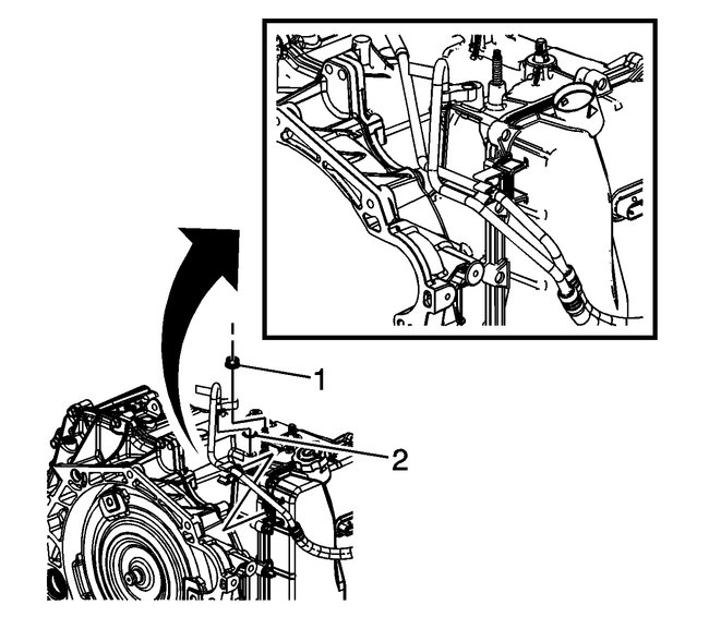

3. Drain the transmission fluid. Refer to Transmission Fluid Replacement ().

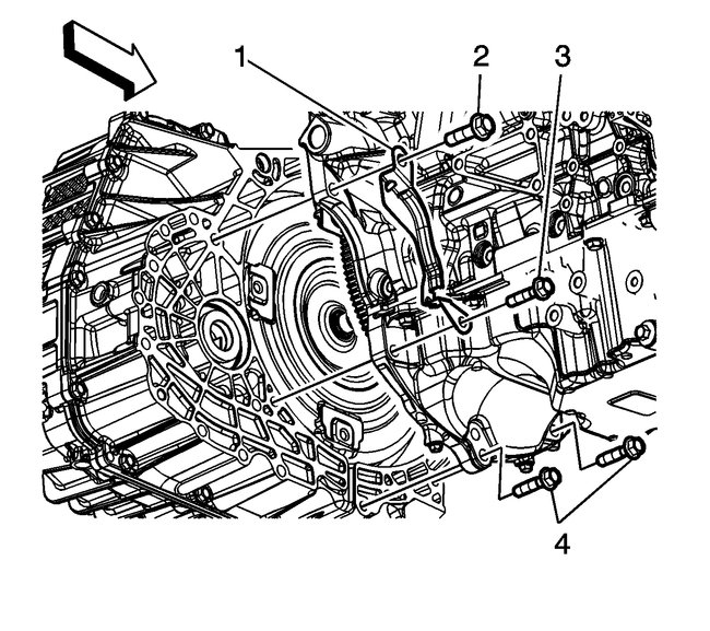

pic 1

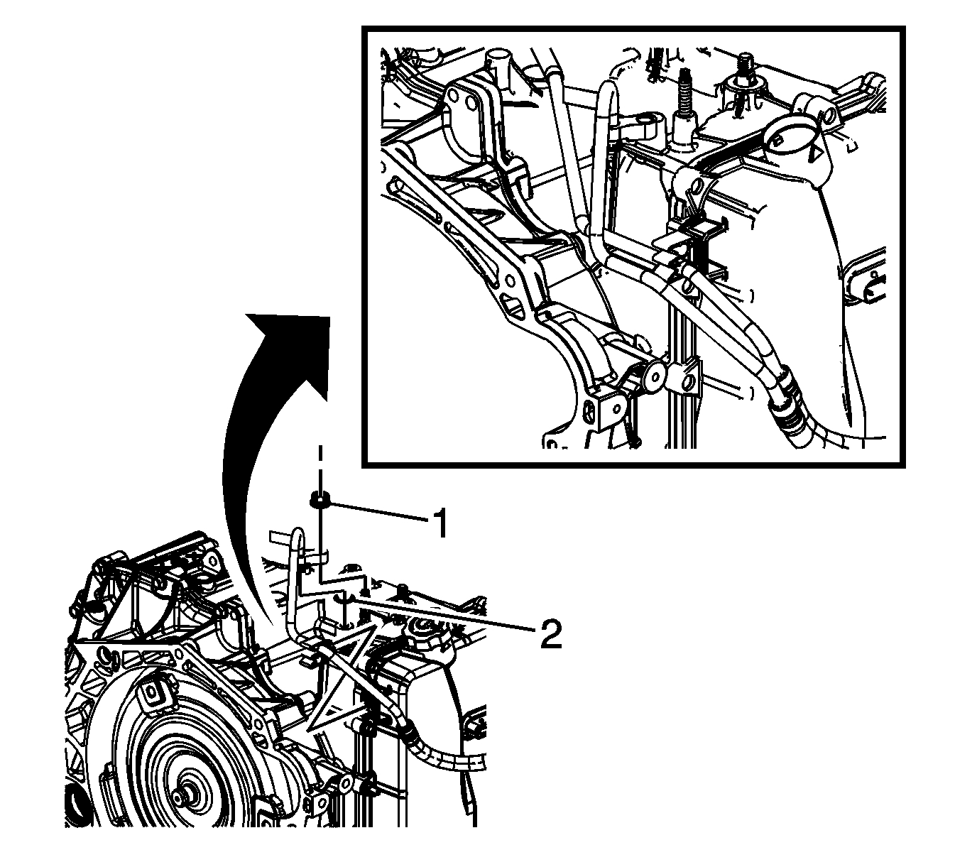

4. Remove the wire harness retainer (2) from the control valve body cover stud.
5. Disconnect the control valve body transmission control module (TCM) electrical connector (1).

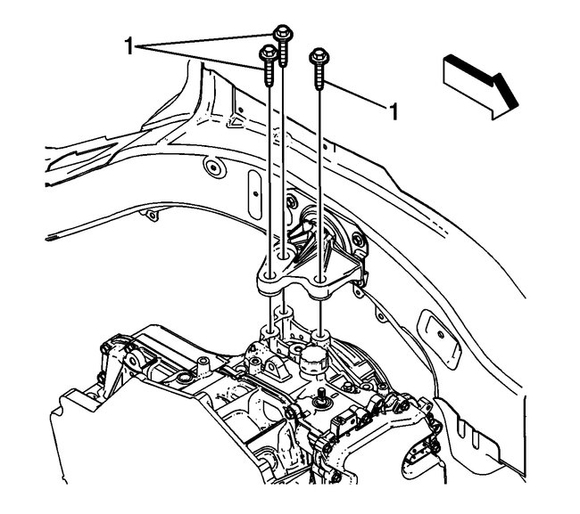

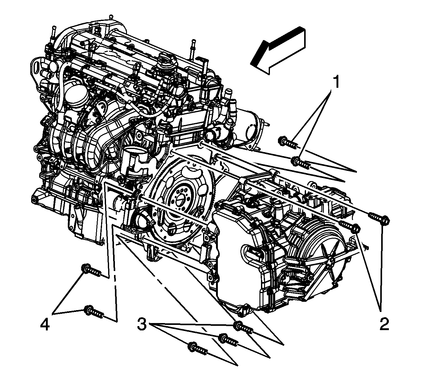

pic 2

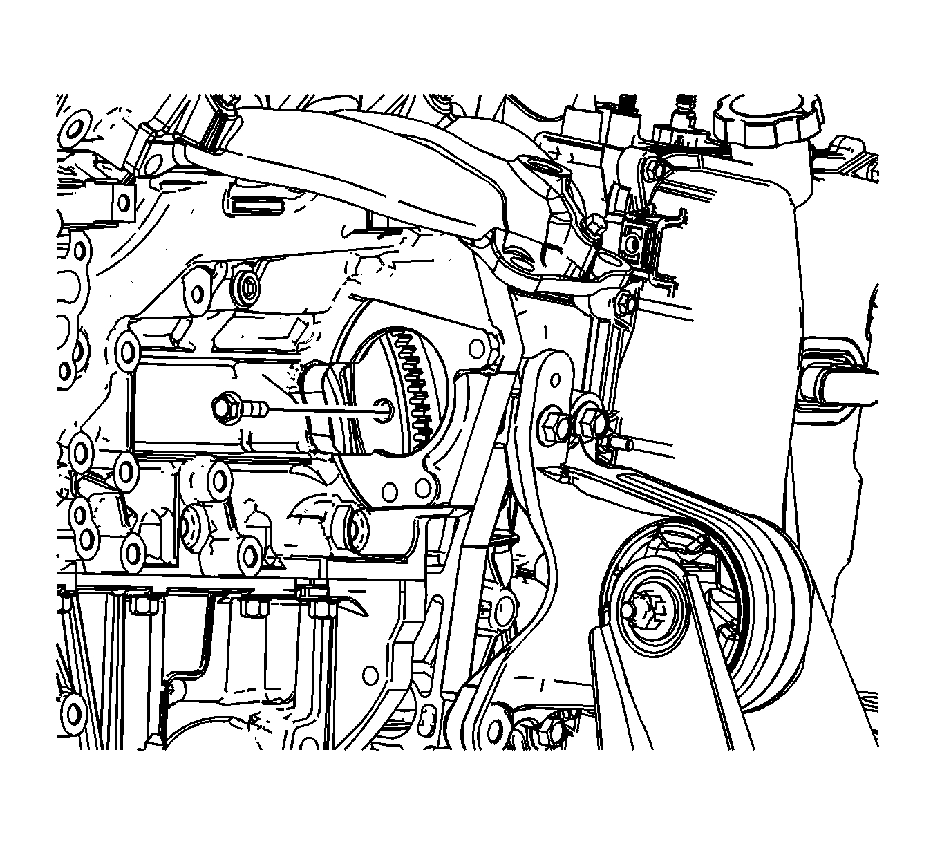

6. Remove the transmission fluid cooler pipe retainer nut (1).
7. Remove the transmission fluid cooler inlet hose and seal (2) from the transmission.
8. Plug and/or cap the hose and transmission to prevent contamination.

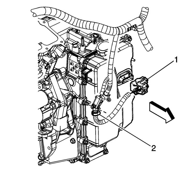

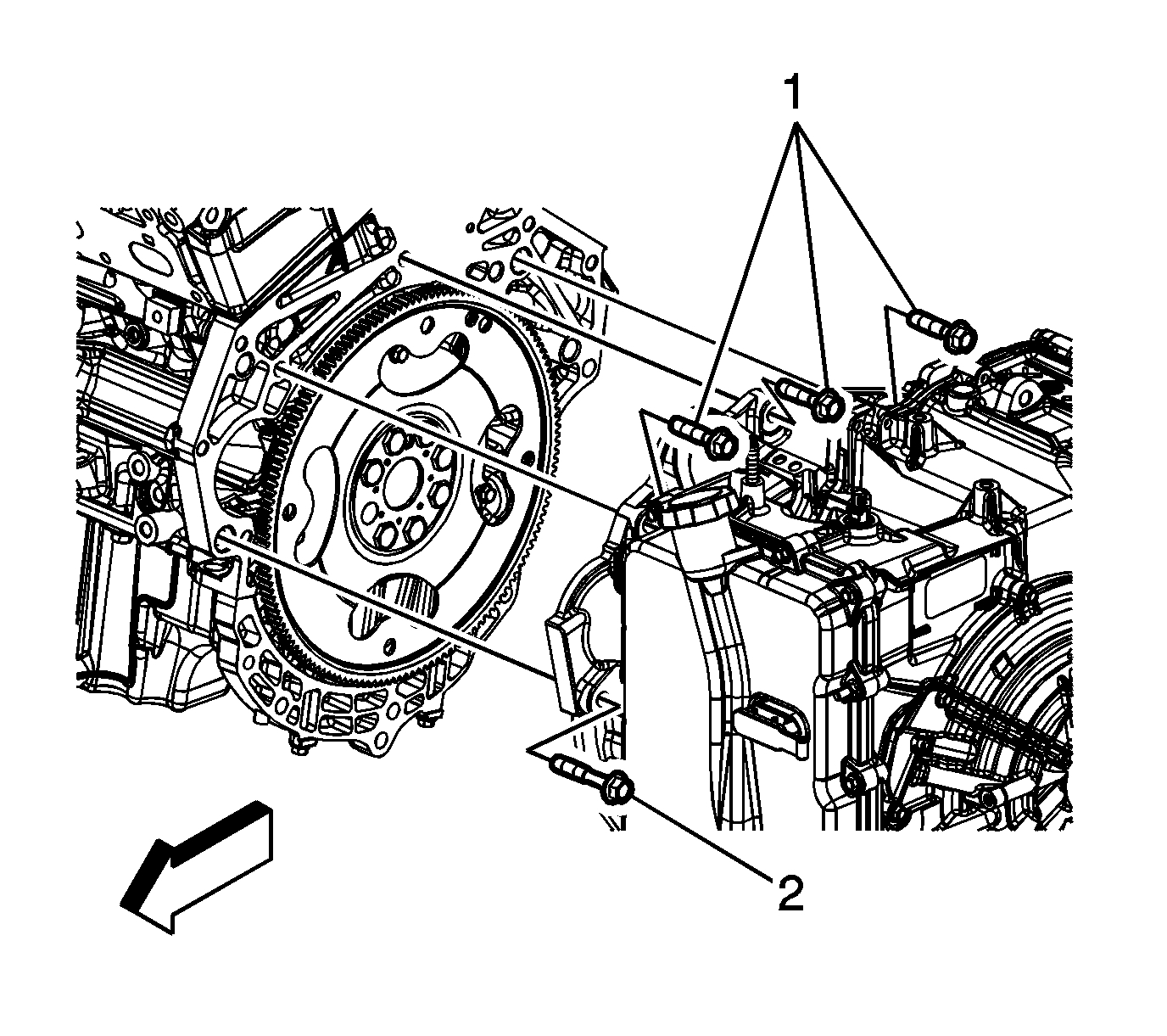

pic 3
9. Remove the transmission fluid cooler pipe retainer nut (1).
10. Remove the transmission fluid cooler outlet hose and seal (2) from the transmission.
11. Plug and/or cap the hose and transmission to prevent contamination.
12. Disconnect both pipes from the retainer.

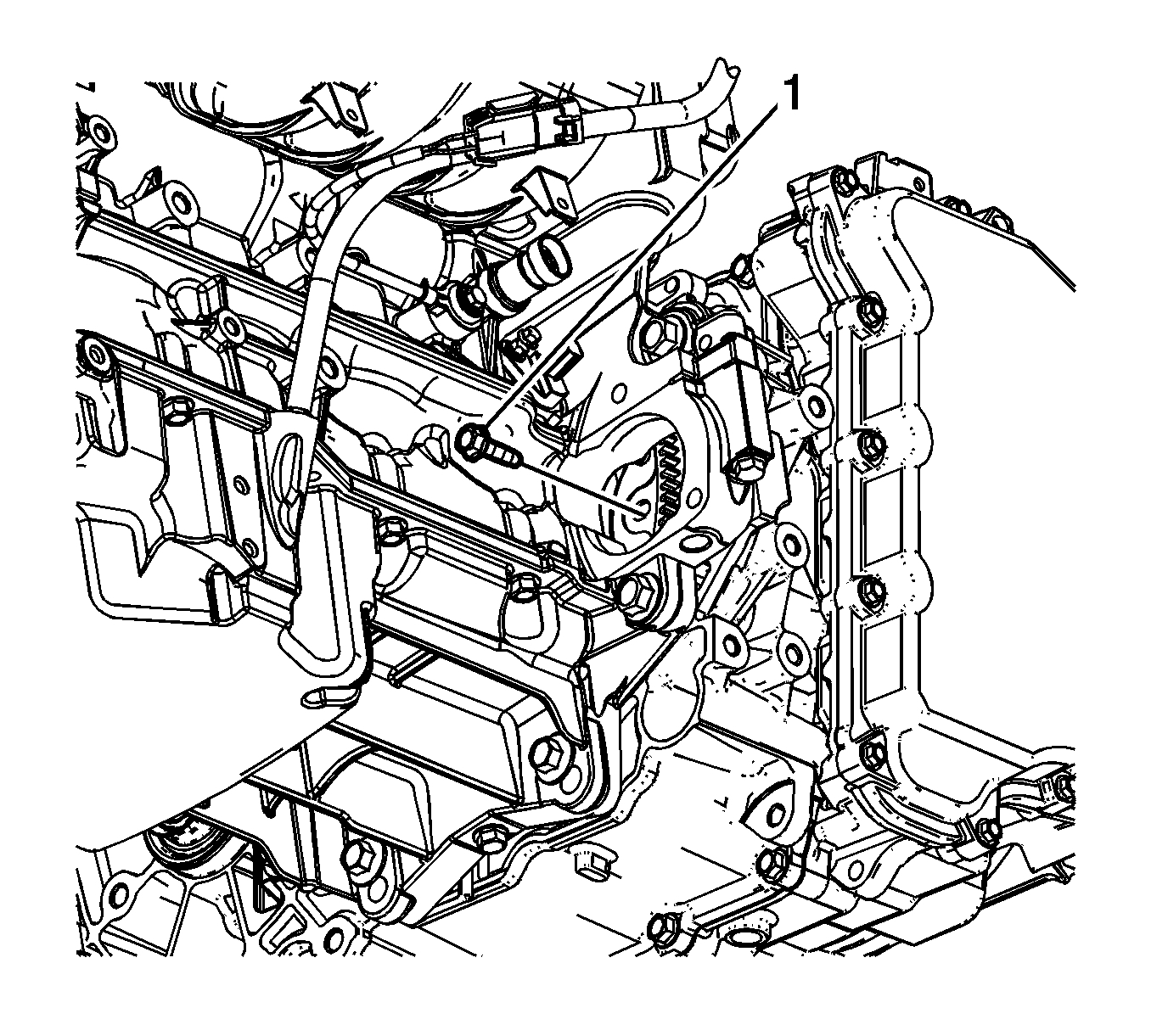

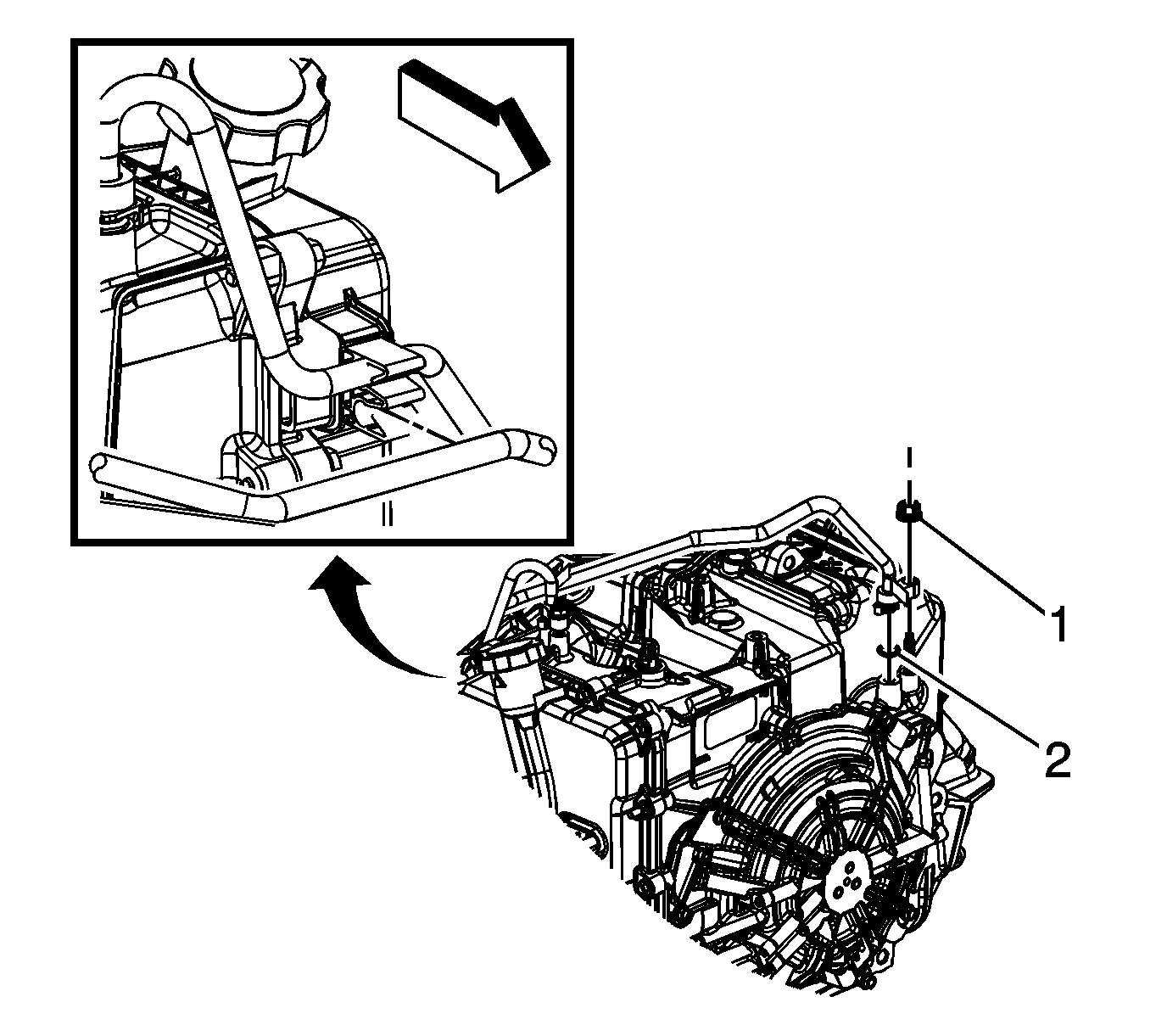

pic 4
19. Remove the upper transmission to engine bolts (1, 2).

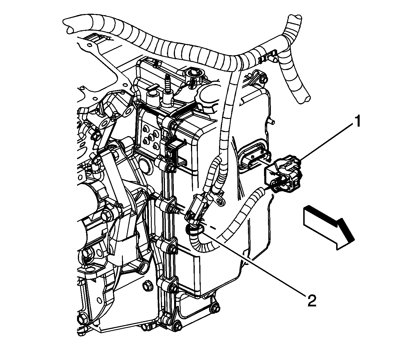

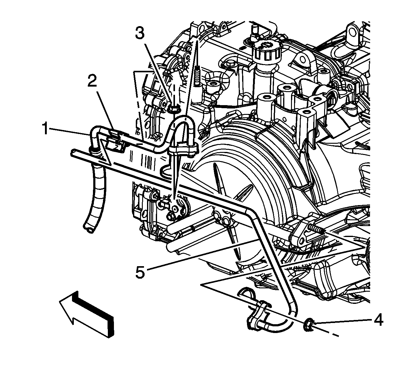

pic 5
23. Remove the starter. Refer to Starter Replacement (LAF) (See: Starter Motor > Removal and Replacement)Starter Replacement (LF1) (See: Starter Motor > Removal and Replacement).

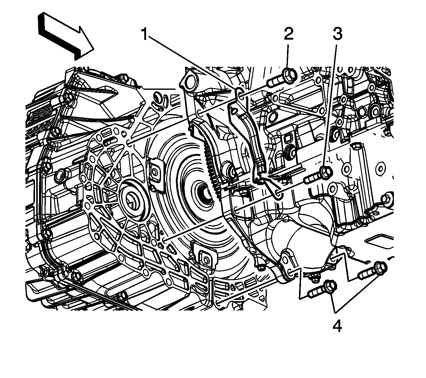

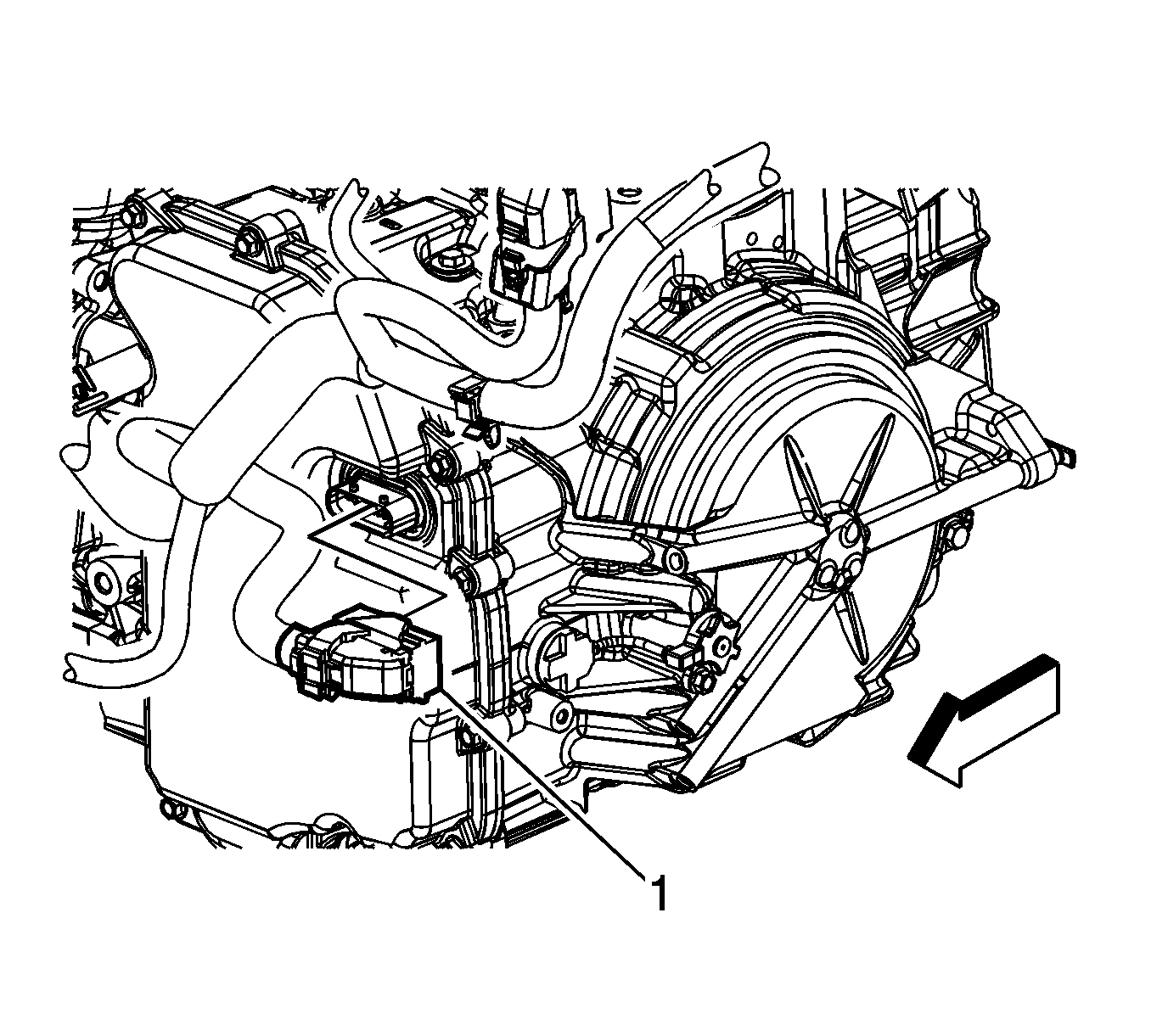

pic 6
26. Remove the flywheel inspection cover bolts (2, 3).
27. Remove the flywheel inspection cover (1).
28. Remove the remaining transmission bolts (4).
Note: Insure the torque converter remains securely in place on the transmission input shaft while separating and removing the transmission.
29. Separate the transmission from the engine.

22. Connect the control valve body TCM electrical connector (1).
23. Install the wire harness retainer (2) to the control valve body cover stud and tighten the nut to 12 Nm (106 lb in).
