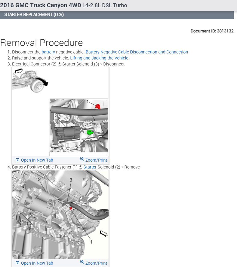

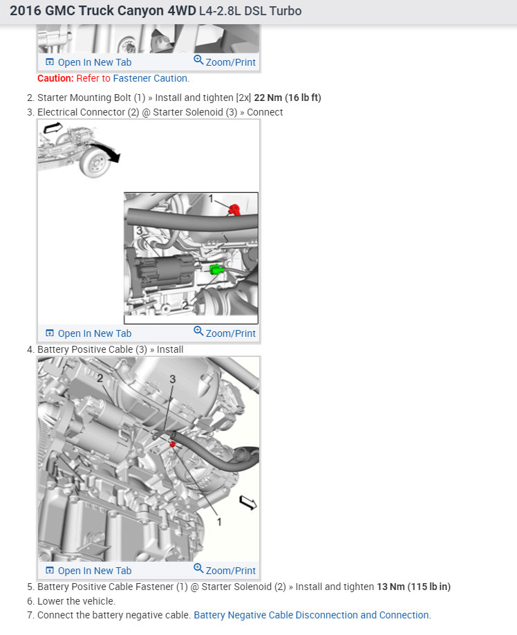

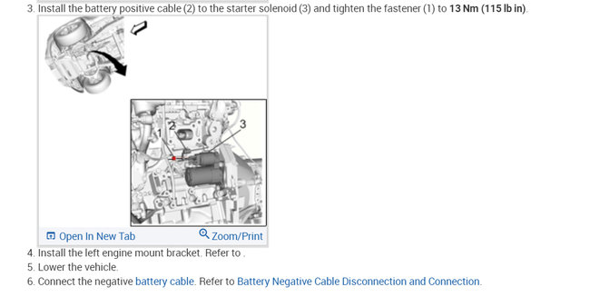

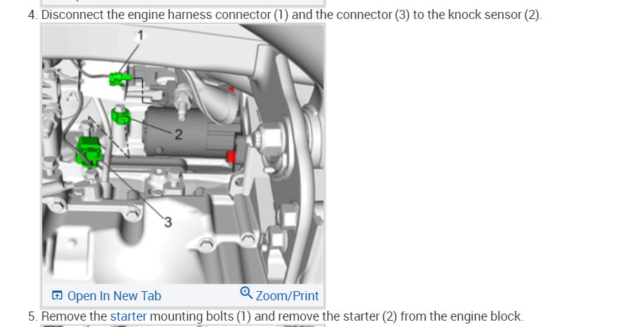

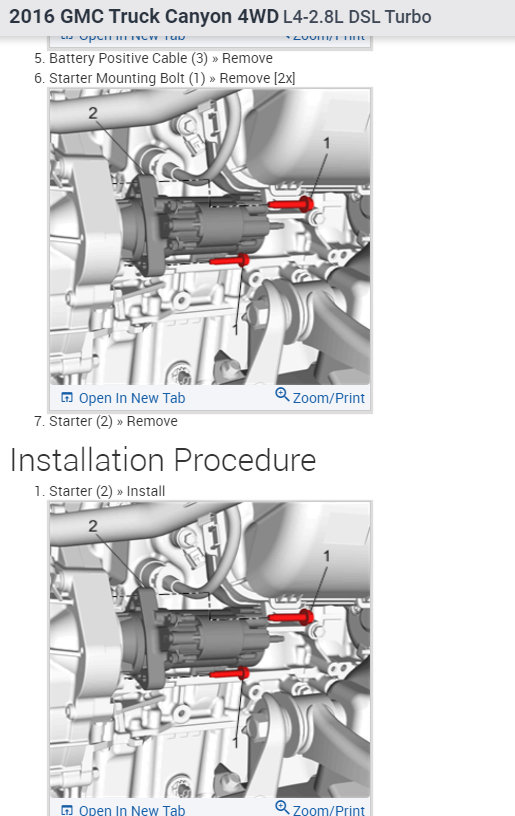

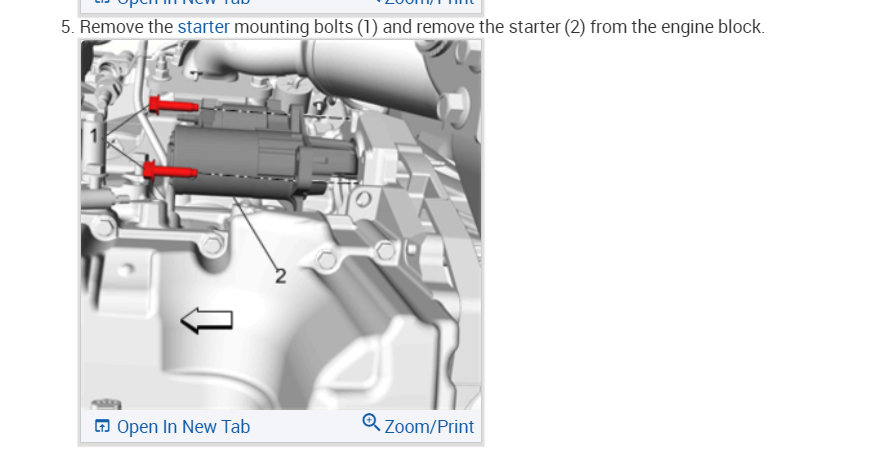

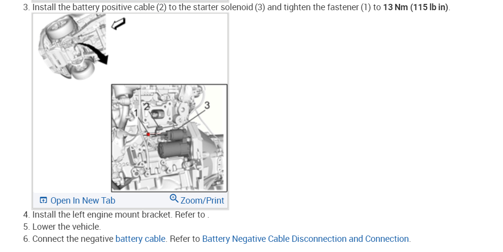

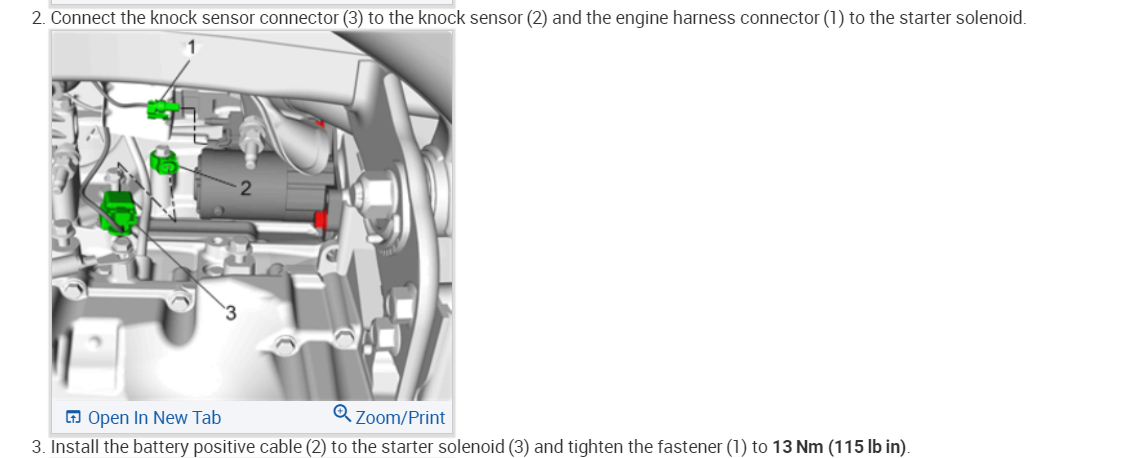

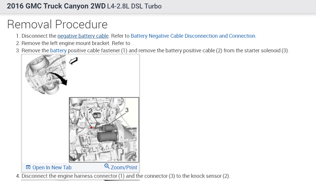

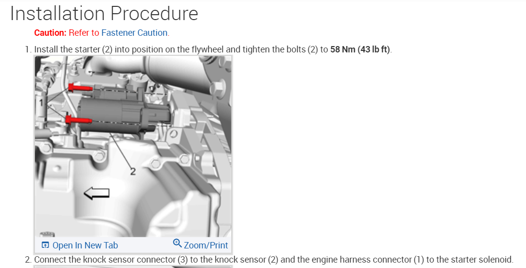

Here is a helpful generic guide on best practices with diagrams below to show you how on your car.
See attached for the starter replacement procedure. Let me know of any questions. Thank you.

Can you provide any further specific removal information on this vehicle?

Did you click on the diagrams in the above post? The guide is a generic instruction to help you see what you are getting into with the specific instructions in the diagrams below. I did notice not all diagrams were uploaded so I have reuploaded all diagrams for the starter replacement for your truck. Check out the diagrams (below). Please let us know if you need anything else to get the problem fixed.
