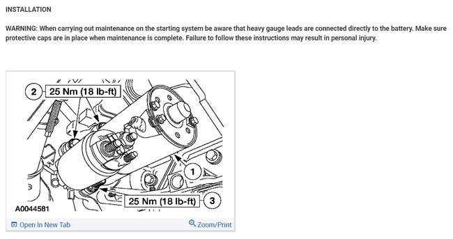

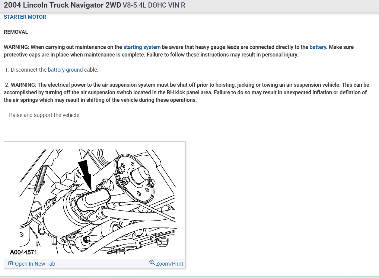

What tools are needed to replace the starter?
2004 LINCOLN NAVIGATOR
245,000 MILES
CODY MCCOY
Can you tell me the tools needed to do so?
Oct 9, 2023 at 2:58 AM
  • 55,421 POSTS

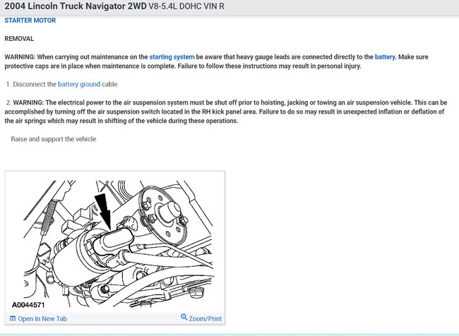

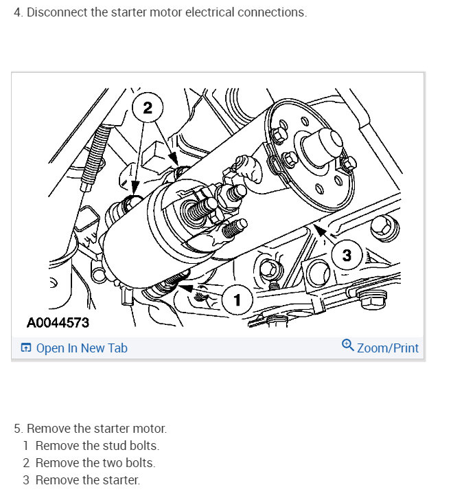

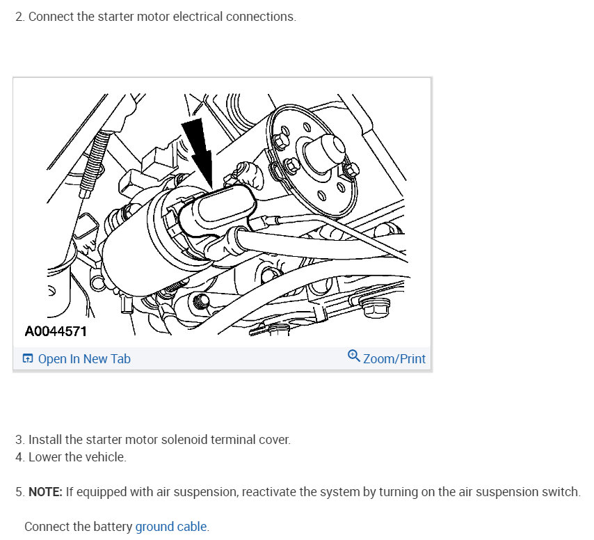

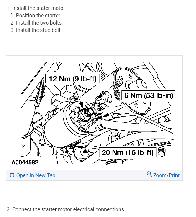

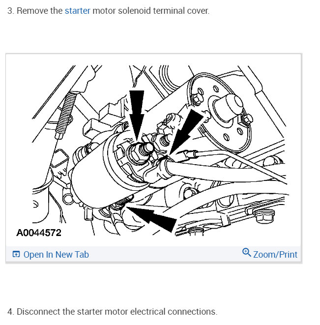

Sure, you will need 10mm and 13mm sockets and wrenches. You will need extensions as well. I would start by disconnecting the battery. Also, this guide can help walk you through the steps and I have included instructions in the images below for your car.
This video shows the job being done on a 5.4 liter as well, the tools should be the same.
