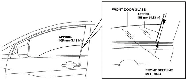

Yesterday the driver's outside door handle latch mechanism broke and handle is loose, won't open door. Door can still open from the inside.
Can you send me instructions on removing inside panel and then replacing or repairing mechanism?

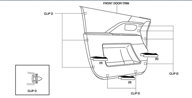

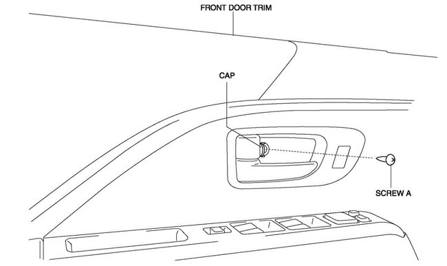

I would be happy to. First will be the removal process of the door panel. The attached pics will correlate with the directions.

2. Remove the caps then remove the screw A.
pic 1

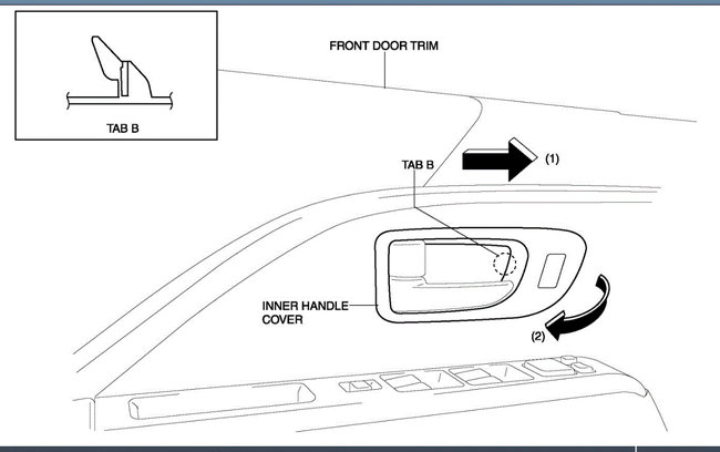

3. Pull the inner handle cover in the direction of the arrow (1), (2) shown in the figure, detach the tab B.
pic 2

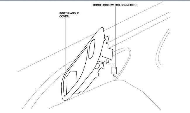

4. Disconnect the door lock switch connector, then remove the inner handle cover.
pic 3

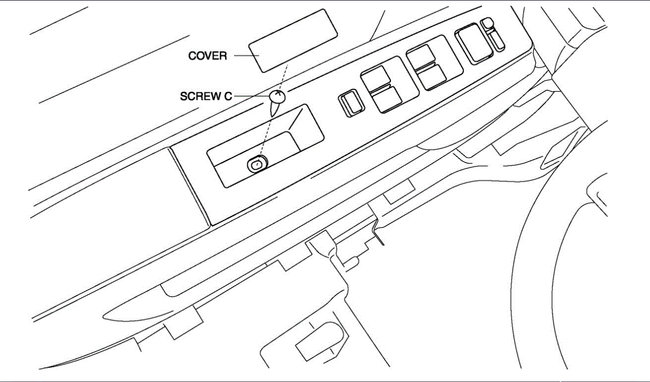

6. Remove the cover, then remove the screw C.
pic 4
7. Pull in the direction of the arrow (3), (4), (5) shown in the figure and remove clips D from the front door trim.
pic 5

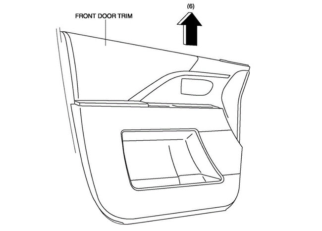

8. Pull the front door trim in the direction of the arrow (6) shown in the figure.
pic 6
9. Disconnect the driver-side power outer mirror switch connector and driver-side power window main switch connector.
10. Remove the front door trim.

Driver Side

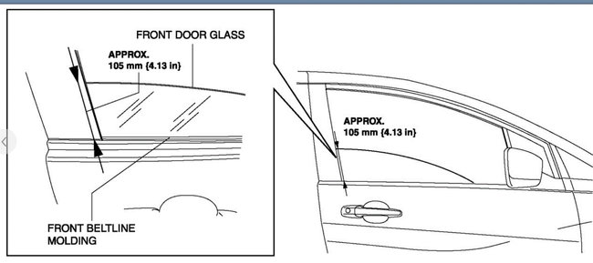

1. To access the glass installation bolt, adjust the position of the front door glass so that the height of the door glass towards the rear is approx. 105 mm {4.13 in}.
pic 7

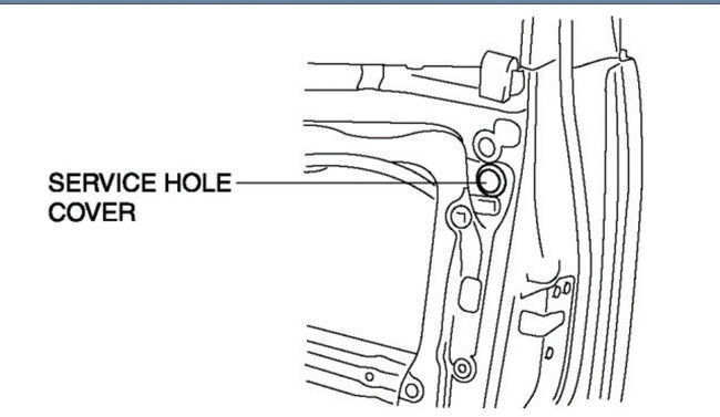

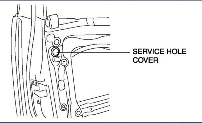

6. Remove the service hole cover.

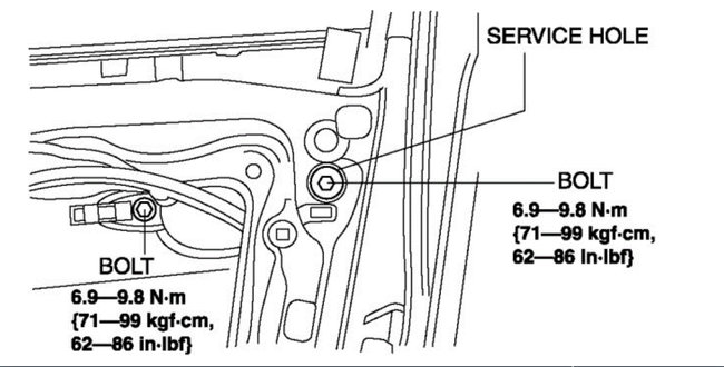

pic 8

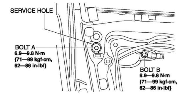

7. Remove the bolt A and bolt B.
pic 9

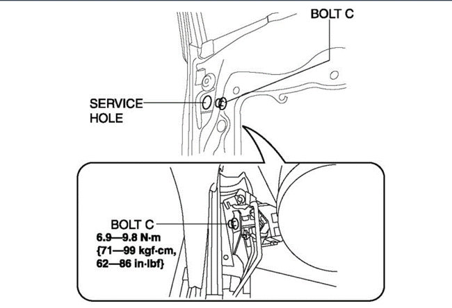

8. Remove the bolt C.
pic 10

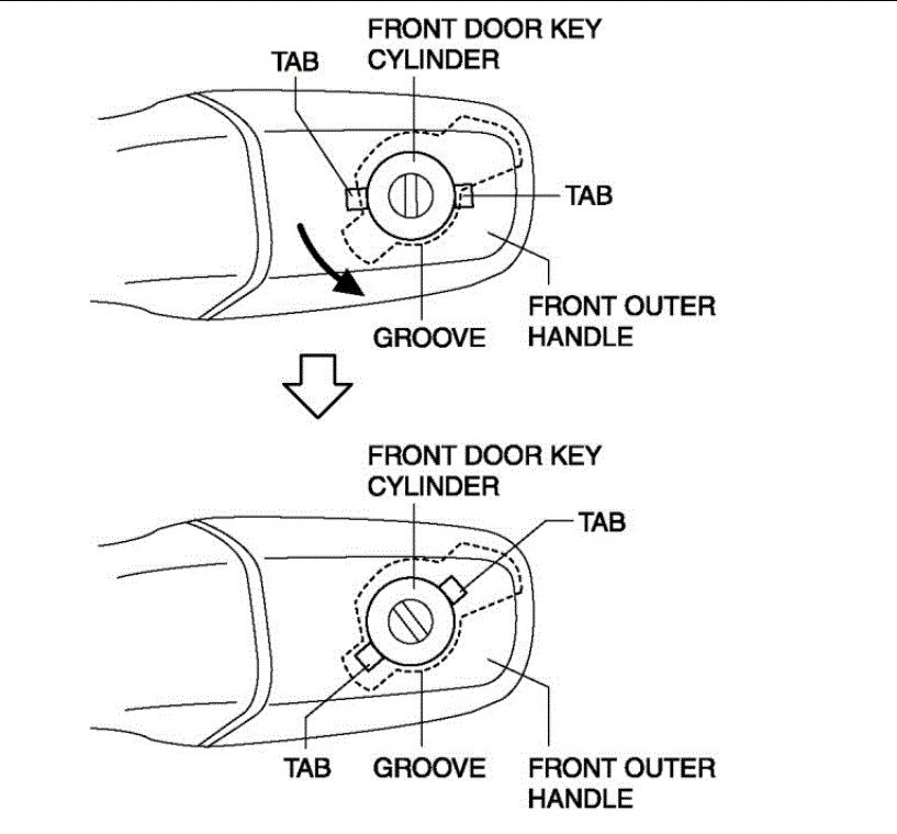

9. Rotate the front door key cylinder in the direction of the arrow, and then align the front door key cylinder tabs with the groove of the front outer handle.
pic 11
CAUTION:
- The front door key cylinder tabs are installed to the rear side of the front outer handle. If the rear side of the front outer handle is removed without aligning the groove of the front outer handle with the front door key cylinder tabs, the front door key cylinder tabs may contact the front outer handle and be damaged. Before removing the rear side of the front outer handle, always rotate the front door key cylinder and set the tabs out of the way.

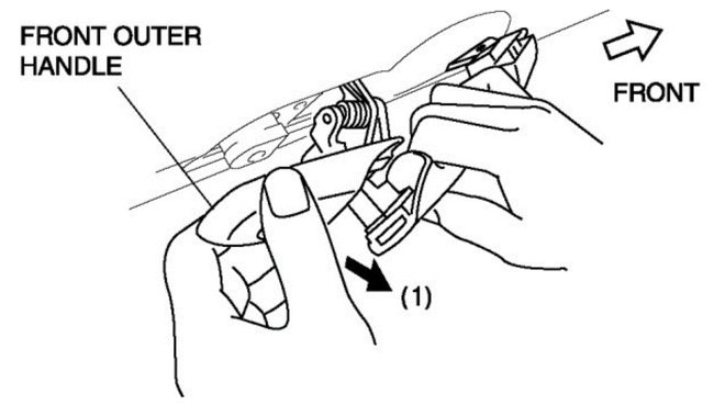

10. Secure the rear part of the front outer handle and, with the front outer handle lever pulled outward (1), remove the rear part of the front outer handle from the front door.
pic 12
pic 13

5. Remove the service hole cover.
pic 14

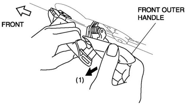

7. Secure the rear part of the front outer handle and, with the front outer handle lever pulled outward (1), remove the rear part of the front outer handle from the front door.
pic 16
