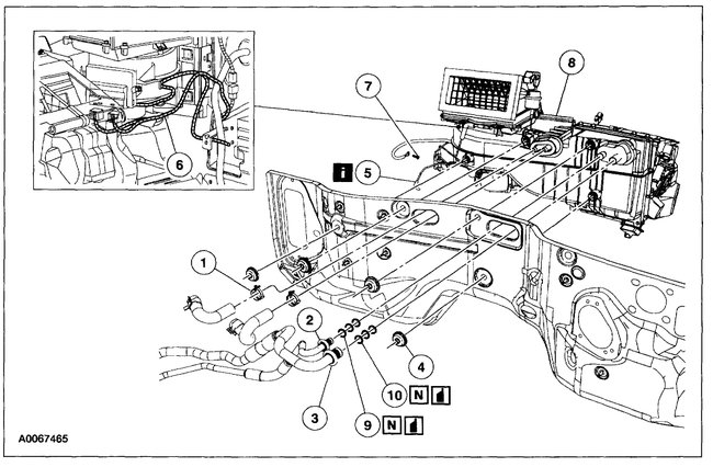

You will need to vacuum down and recharge the air conditioner system when doing the job. Start by disconnecting the battery. Here is a guide to show you what you are in for when doing the job.
https://www.2carpros.com/articles/replace-heater-core
and
Here is what it will be like for your car (below)

Explorers are always fun. It takes a trade technician about 6-7 hours. First you disconnect the battery, drop the steering column, remove the center console, remove the dash. Then you can see the case, but you still can't get to it. Then you have to recover the refrigerant from your A/C system and remove the case. now you can separate the case and remove the heater core. Sounds like fun doen't it?!? Good luck. Let me know if you have any more questions. I'll be happy to guide you through it. I've done it quite a few times myself. My first one took about 9 hours.

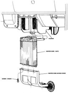

Here is a generic guide to help you step by step with instructions in the diagrams below to show you how on your car.

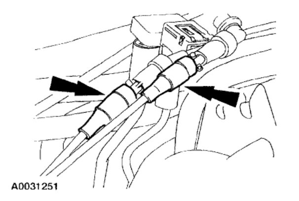

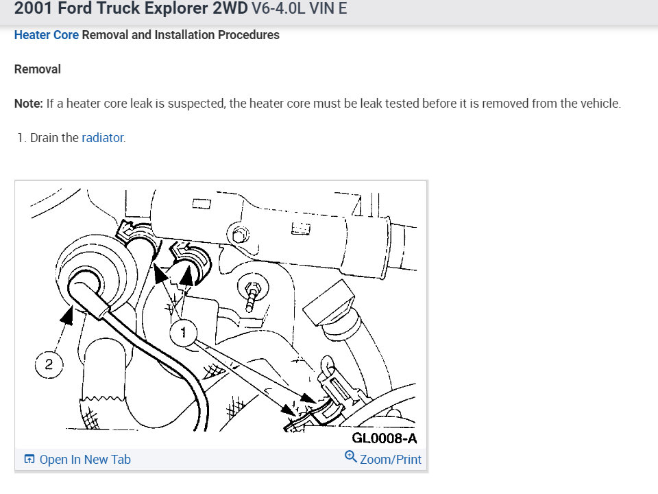

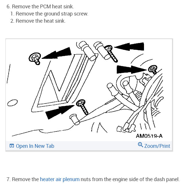

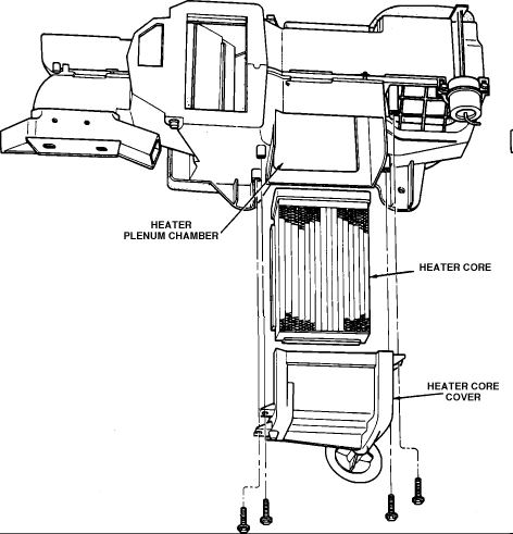

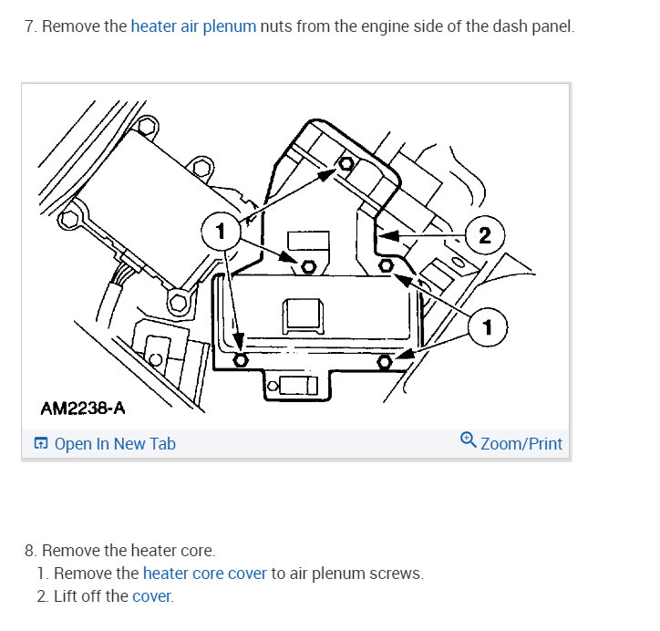

Heater Core Removal and Installation Procedure
Please check out the images below.
Removal
Note: If a heater core leak is suspected, the heater core must be leak tested before it is removed from the vehicle.
Drain the radiator.
Remove the heater water hose.
Squeeze the clamps and pull the hoses off.
Disconnect the vacuum hose from the water control valve.

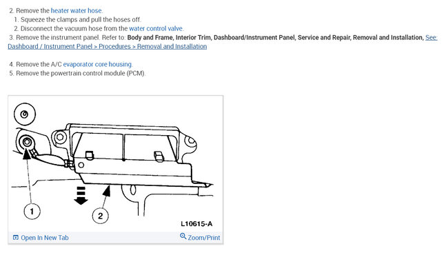

Remove the instrument panel. Refer to: Body and Frame, Interior Trim, Dashboard/Instrument Panel, Service and Repair, Removal and Installation, See: Body and FrameInterior Moulding / TrimDashboard / Instrument PanelService and Repair
Remove the A/C evaporator core housing.
Remove the powertrain control module (PCM).
Remove the PCM heat sink.
Remove the ground strap screw.
Remove the heat sink.

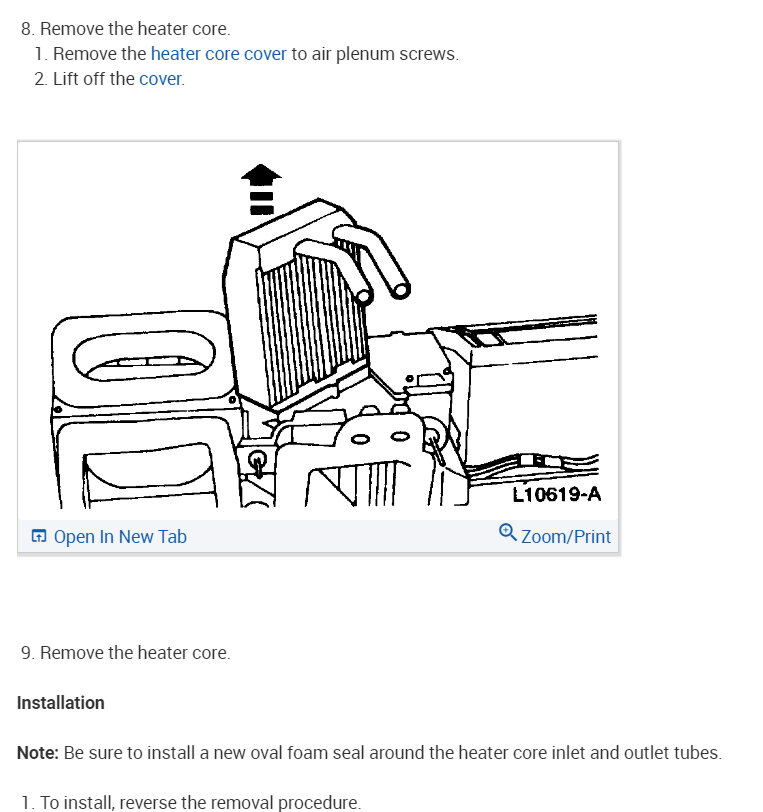

Remove the heater air plenum nuts from the engine side of the dash panel.
Remove the heater core.
Remove the heater core cover to air plenum screws.
Lift off the cover.
Installation
Note: Be sure to install a new oval foam seal around the heater core inlet and outlet tubes.
To install, reverse the removal procedure.
Check out the images (below). Let us know how it goes

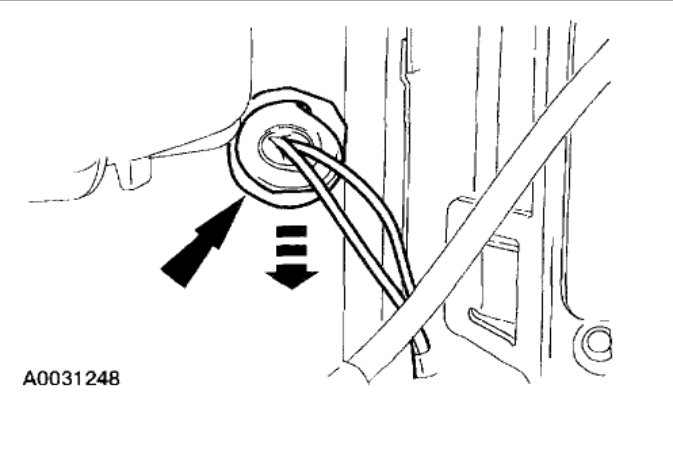

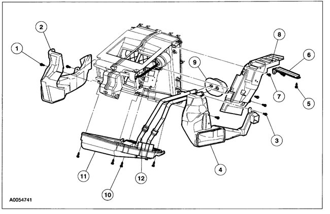

Removal
Heater Core
Allow the engine to cool. Following all safety precautions and using a thick cloth, turn the radiator cap slowly to the first stop. Step back while pressure is released. When the pressure is released, tighten the radiator cap on the radiator.
Disconnect heater hoses from heater core tubes and plug the hoses.
In passenger compartment, remove four screws attaching heater core access cover to plenum assembly. Remove access cover.
Pull heater core rearward and down, removing it from plenum assembly.

I was able to get this from the internet for you. THis is an involved process, and I recommend getting a good repair manual. They offer them on line at this site.
Here is what I found for you:
When draining the coolant, keep in mind that cats and dogs are attracted by the ethylene glycol antifreeze, and are quite likely to drink any that is left in an uncovered container or in puddles on the ground. This will prove fatal in sufficient quantity. Always drain the coolant into a sealable container. Coolant should be reused unless it is contaminated or several years old.
Fig. Fig. 2: From inside the engine compartment, disconnect the heater hoses from the core fittings ...
Disconnect the heater hoses from the heater core tubes and plug hoses.
In the passenger compartment, remove the four screws attaching the heater core access cover to the plenum assembly and remove the access cover.
Fig. Fig. 3: ... then, in the passenger compartment, remove the under dash cover retaining screws ...
Fig. Fig. 4: ... and allow the cover to drop down. If necessary, you can remove the cover if it is in your way
Fig. Fig. 5: Remove the heater core access panel attaching screws ...
Fig. Fig. 6: ... then remove the cover by pulling downward and straight back to disengage the drain tube (arrow)
Pull the heater core rearward and down, removing it from the plenum assembly.
Fig. Fig. 7: Pull the heater core rearward and down to remove it from the plenum assembly
To install:
Position the heater core and seal in the plenum assembly.
Install the heater core access cover to the plenum assembly and secure with four screws.
Install the heater hoses to the heater core tubes at the dash panel in the engine compartment. Do not over-tighten hose clamps.
Check the coolant level and add coolant as required. Connect the negative battery cable.
Start the engine and check the system for coolant leaks.
