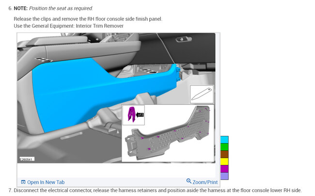

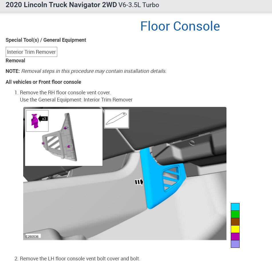

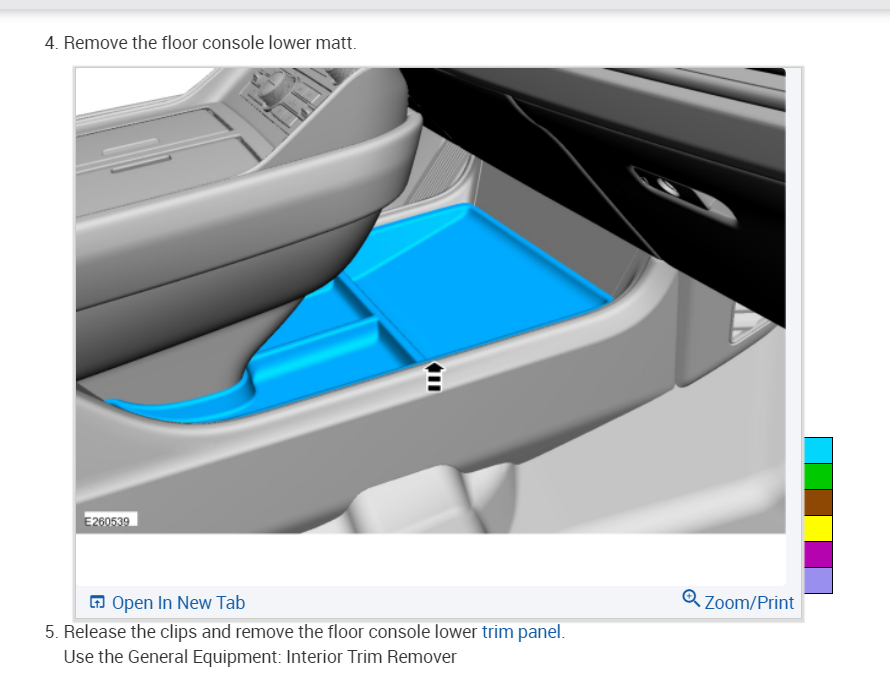

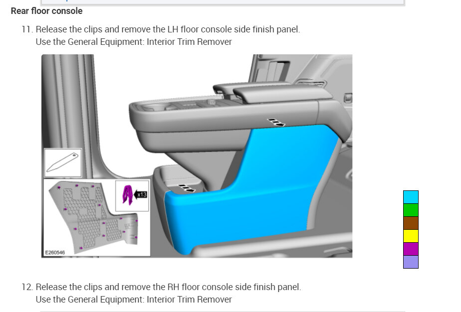

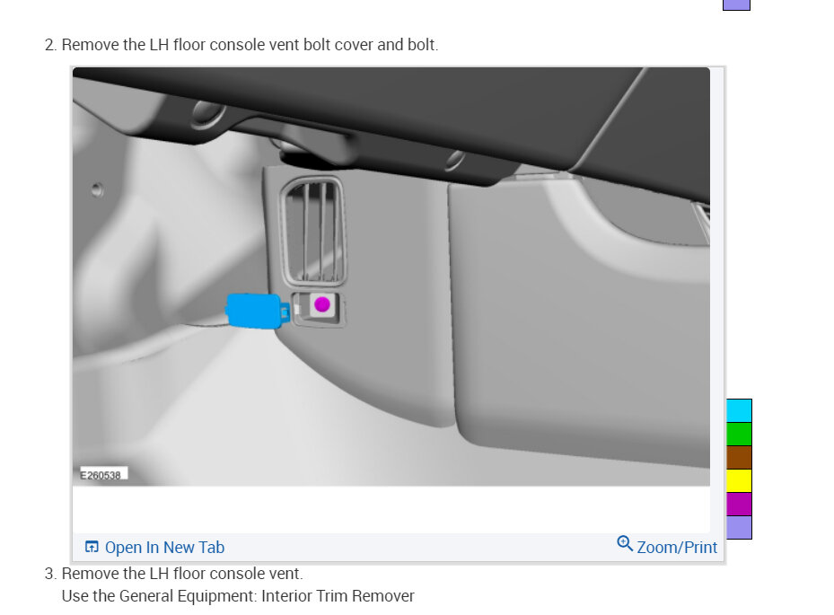

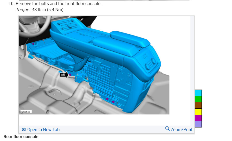

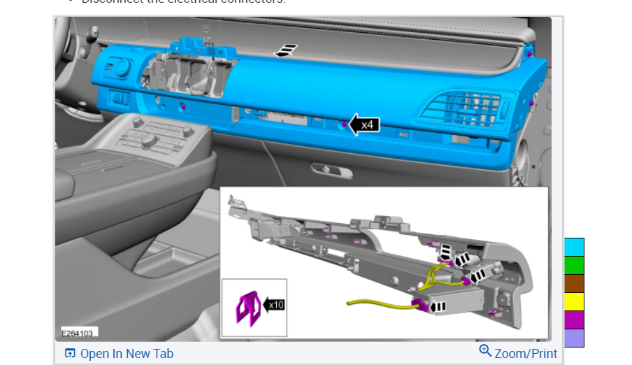

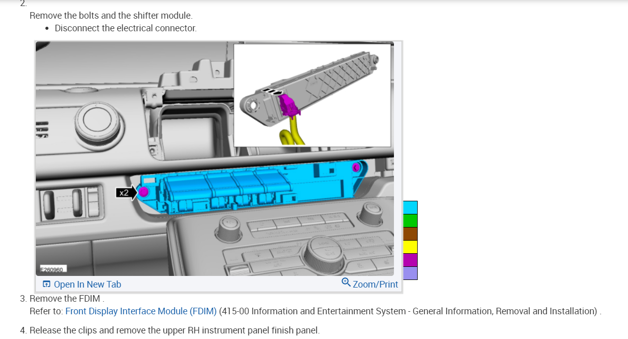

There is no problem. I need to remove the top of the front console to install some wiring for ham radio equipment.
Apr 16, 2023 at 8:35 AM
  • 55,433 POSTS

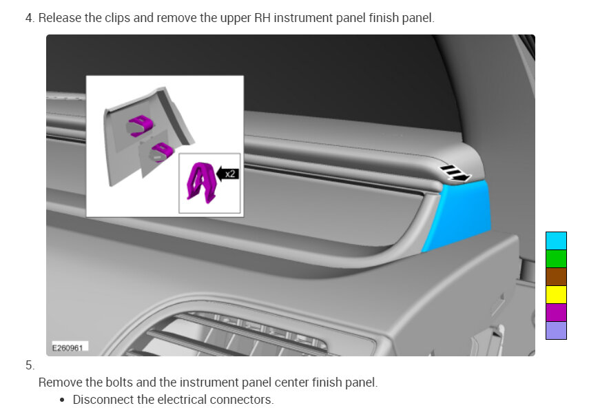

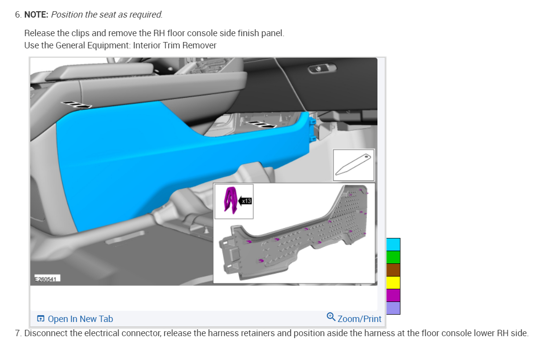

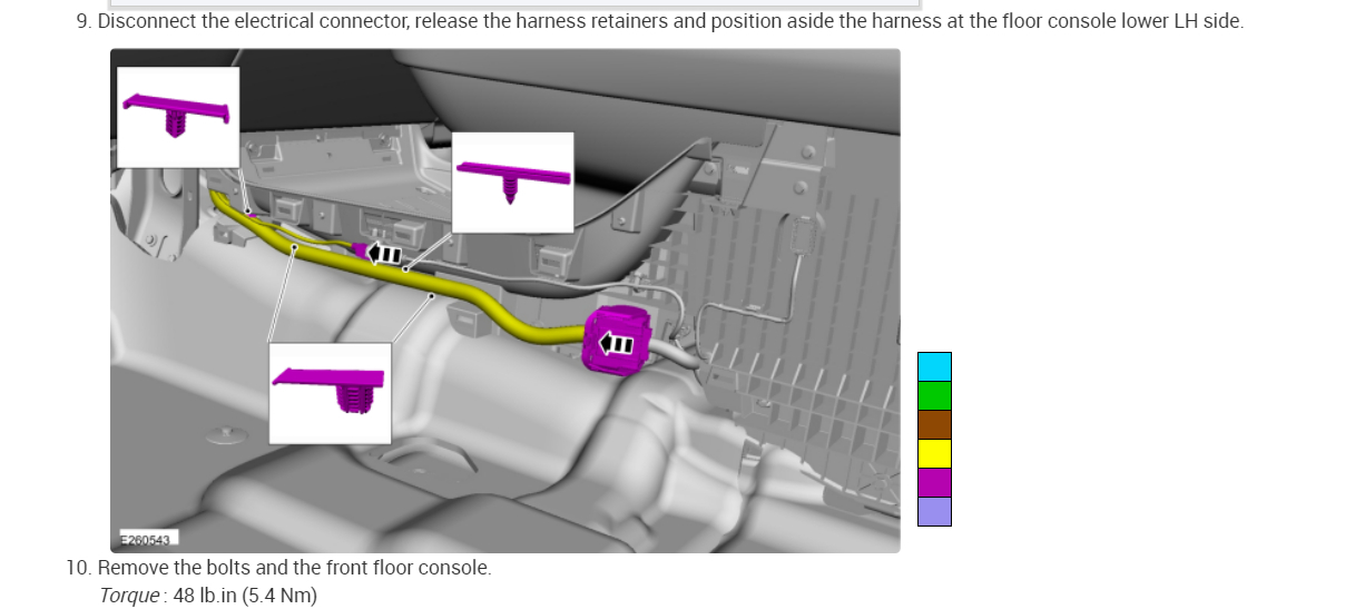

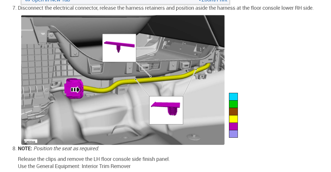

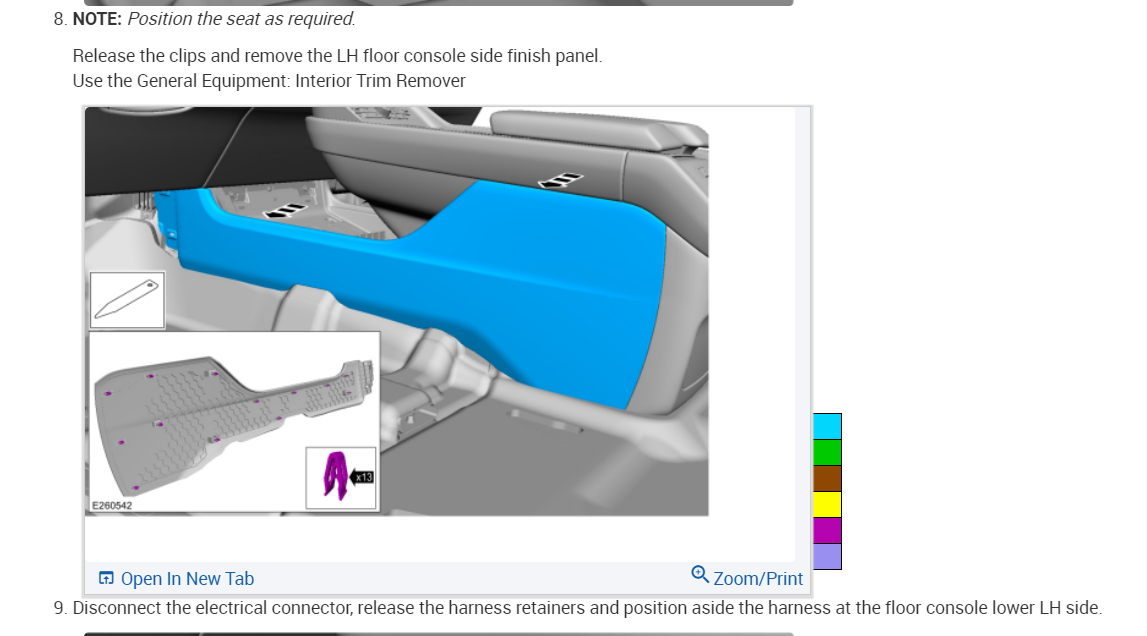

Yep, here are the instructions on how to remove the upper trim panel for the dash and how to disassemble the center console. Check out the images (below). Please let us know if you need anything else to get the problem fixed.
Apr 17, 2023 at 5:00 AM
MZAMBORY
I have sort of asked this question before a Ken L sent me some great information on this just excellent, but it did not describe taking the top trim off where the cupholders, mode selector switch and storage doors are, and the A/C and blower controls are heat cool seat switches etc. I do
not want to break any of the plastic parts. thanks in advance for any help you can give to me on this matter Thanks again, Michael Z
