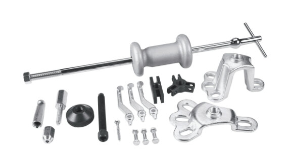

When you get to the point that everything is out of the way and the axle is ready to come out, using a slide hammer with a hook will make life easier. I will add a picture for you of this. If you don't have one, most auto parts stores rent them.

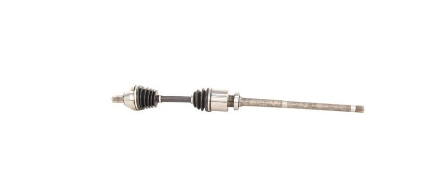

I would leave it together, jack the front of it up, turn the key on so the steering wheel is unlocked and put your hands on the passenger side at 9 o'clock and 3 o'clock and push the tire in like it would be if you were turning left. Once you have it pushed in rotate the tire and see if you can see the axle popping or moving.
Unfortunately, I don't have a lot of information for this vehicle so if you could take some pictures of the axle in a couple of different spots, I can help you better. For example, where the snap ring is, where it goes into the differential, where it goes into the hub. That would help me to help you. Sometimes with vehicles like Land Rover and other higher end vehicles information is hard to find.
I am adding a picture of a passenger front axle. Can you tell me if this is what yours looks like?

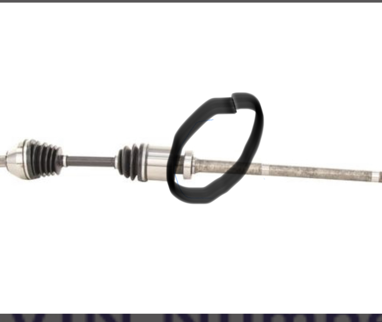

I added a picture of where the snap ring is, usually they are on the outside of the carrier support in the middle, but this snap ring is on the inside of it right where i circled. Not sure how it prevents the axle from coming out being on the inside.

Yes, that snap ring will need to be removed. I think it is more to keep the bearing in place in the support. Honestly, vehicles are way over engineered these days. I swear sometimes I think they just want to make things difficult for fun.

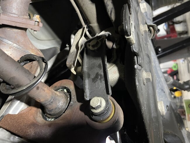

Snap ring is out, now axle not coming out, I don't want to pull on it and end up with a broken inner boot I guess, not enough room to insert a fork or a prier, I'll see what I can do.

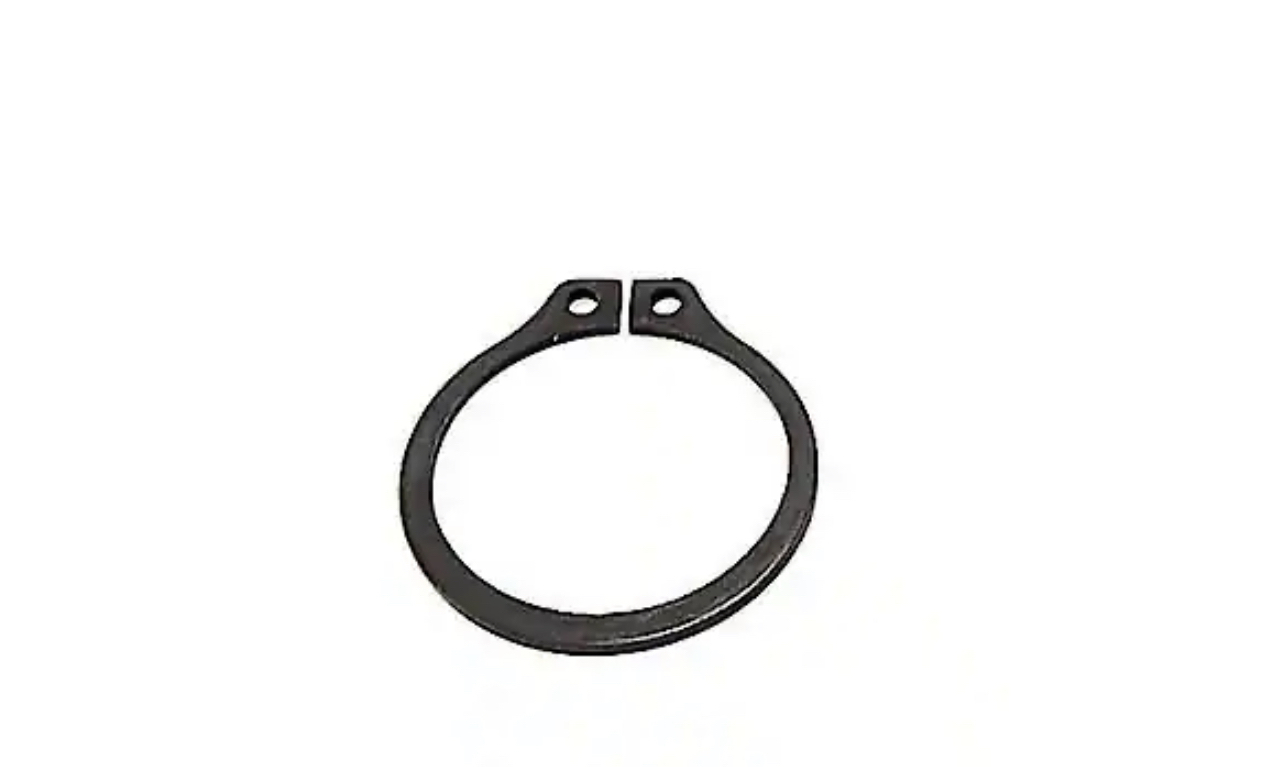

Can you find me the part number for the snap ring that holds the bearing on the carrier? Can't find it any where.

Absolutely. Let me see what I can find for you. You might need to call the dealer with your VIN for this particular part.
Thank you,
Brendon
May 19, 2023 at 2:26 AM
BRENDON S
  • 653 POSTS
Hello BHAMDOC1973,
I have looked everywhere, and I can't find a part number for it either. I can find the bracket but no snap ring. Sometimes they group parts together so the snap ring might only be available with the bracket.
I don't see why they would do that, but a lot of manufacturers do it.
A lot of times the bearing won't come out bracket and you need to replace it anyway in order to do the axle.
Your best option in my opinion is grab your VIN and call a local Land Rover dealer parts department. A Jaguar dealer might have access to Land Rover parts as well if you can't find a Land Rover dealer. They more than likely have it in stock.

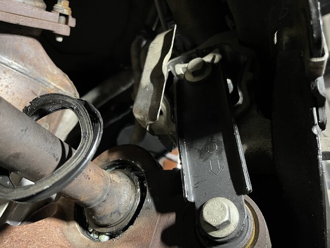

I tried and tried it's not coming out. The boot separated in middle so am stuck with half shaft and bearing in there. Hammered the bearing and where the old boot attaches no success. Used forks, pry bars nothing is moving. I wanted to do like i did with a Mazda i have and remove it with the bracket but the idiots who designed it designed it with 4 bolts one of them tucked under the part where the boot attaches.
May 28, 2023 at 7:22 AM
BHAMDOC1973
  • 2,007 POSTS
After banging on the bearing for hours between breaks, i was like there was no way this thing is not budging a milli, so i found out there were 2 hidden bolts that create a half circle around the bearing, the bracket is so rusty it is so hard to make it out, 2 10 millimeter bolts, removed Nd the whole thing popped out in 2 seconds. I need to pay more attention to the design next time i do something like this.
May 28, 2023 at 9:26 AM
BHAMDOC1973
  • 2,007 POSTS
It was a little painful putting the half-circled mount back on, so if anyone is doing this, remove the small transfer case mount and the its a piece of cake. I am surprised it fixed the issue. I don't understand how an axle can cause such binding, also at 85,000.
