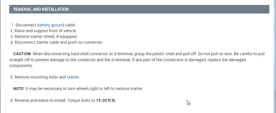

How to pull out starter? can't reach top bolt.

Below is the info out of the manual that doesn't help with the top bolt but is still useful info.
