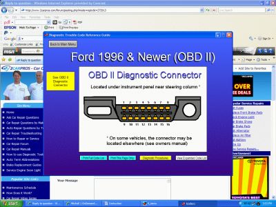

Depends on if the 95 has OBD I Or OBD II connector. OBD I covers 92-94 and some 95 OBD II 95-96 and up. If both have the connector under the hood that looks like this on drivers inner fender.
https://images.2carpros.com/forum/automotive_pictures/62217_Ford_1.jpg
Then probably yes! if the 95 has a connector inside the car under the dash that looks like this, then no.
https://images.2carpros.com/forum/automotive_pictures/62217_Ford96_1.jpg

actually my 94 has the under dash connector same as the 95. what about a p.i. ecm ? thanks

If the connectors are the same should not be a problem to swap them.
