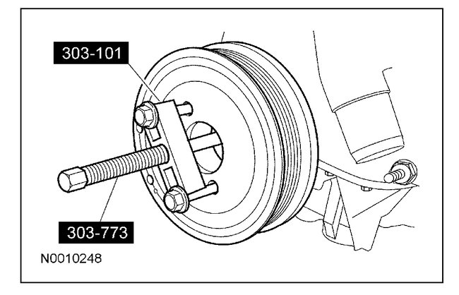

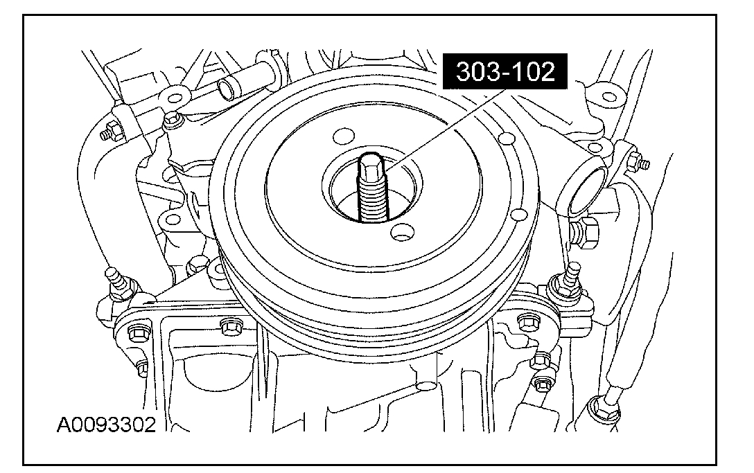

Cannot remove. I bent puller and broke 8mm bolt. any suggestions?

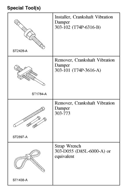

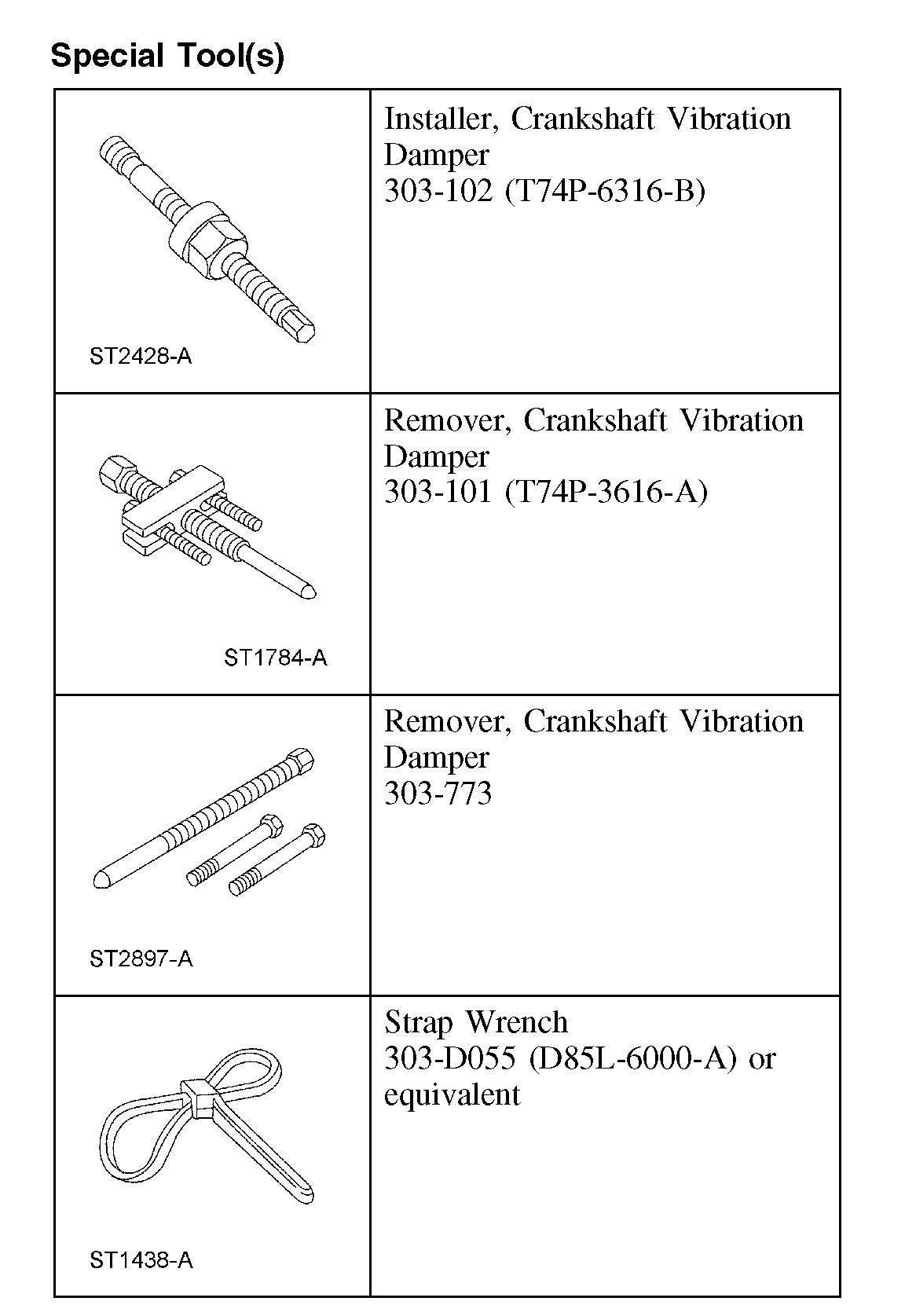

What type of puller are you using? Take a look through these directions. It is specific to removal of the pulley on your vehicle. Let me know if this is what you are using.
Crankshaft Pulley
Picture 1
Picture 2
Picture 3 imageOpen In New TabZoom/Print

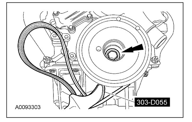

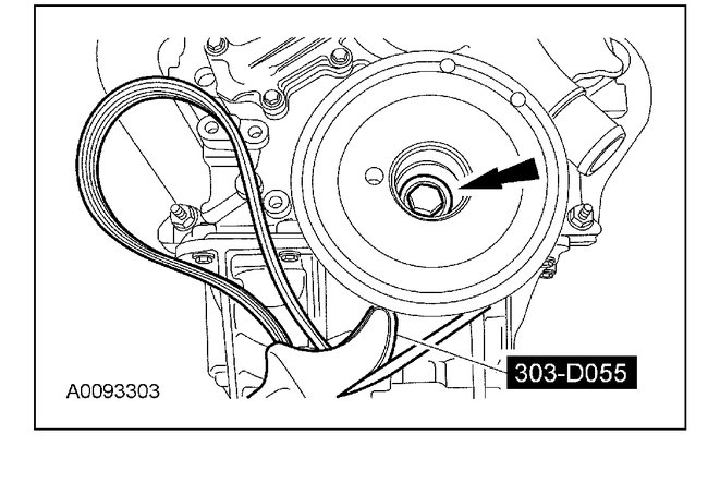

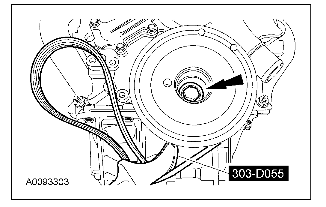

Using the special tool to hold the crankshaft pulley, remove the bolt.
Picture 4

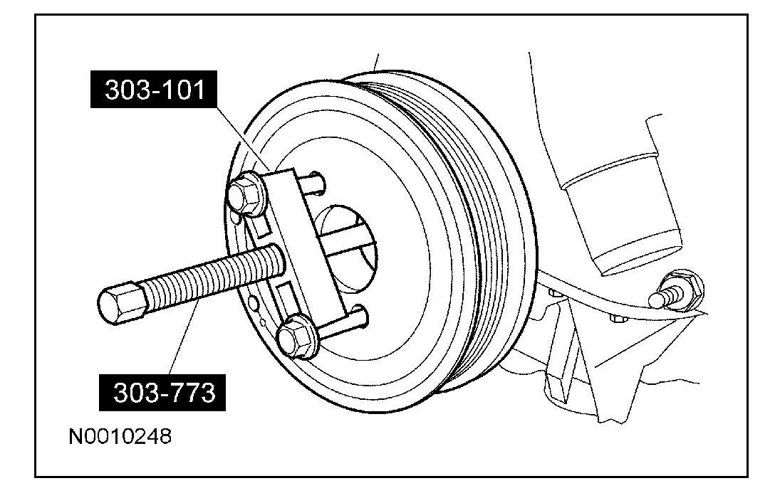

Install the crankshaft pulley bolt 2 to 3 turns. Using the special tools and the two 8-mm bolts, remove the crankshaft pulley.
^ Discard the crankshaft pulley bolt.

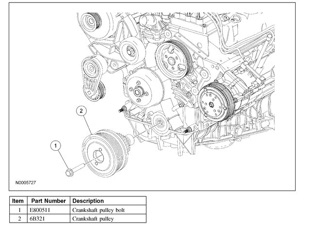

1. Using the special tool, install the crankshaft pulley.

If it doesn't come off, wait until there is extensive pressure on the puller and tap lightly on the main center bolt on the puller. The vibration will often times cause it to come off
