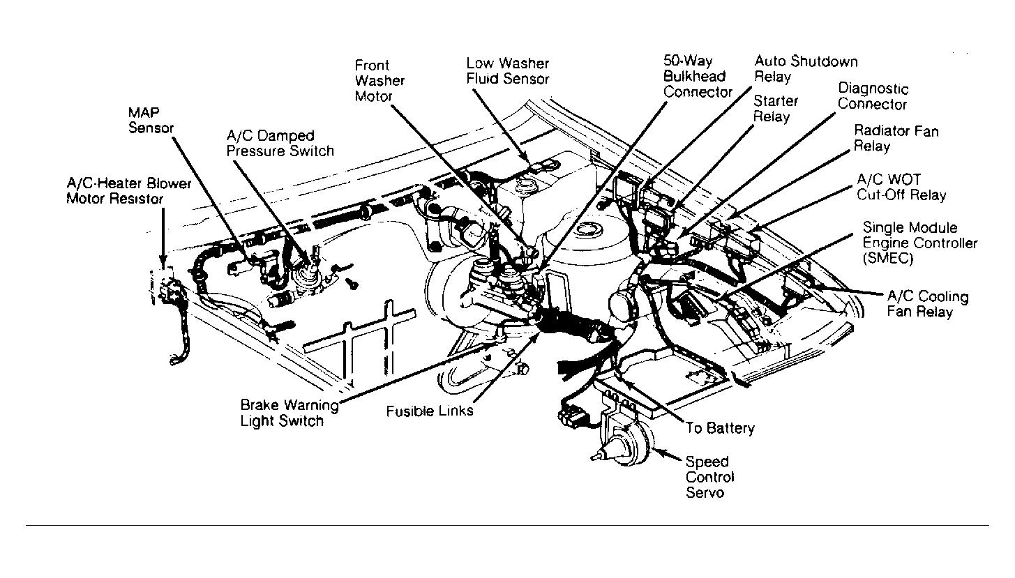

Can you led me to a diagram of the location of the fuel pump relay and a diagram of all the relays. Just changed the wire harness and now I am either not getting fuel and possible ignition control module need to know. I have plenty of fuel going to the injectors but I have no spark at all. At this point I should give you a little background, about three months ago the engine caught fire on the drivers side it destroyed the harness on that side along with the ignition control module the battery since then I have changed the entire wire harness under the hood, changed the ignition control module and all the relays, air cleaner housing, battery and holder, and now I have no spark to the plugs at all. I had changed the coil and seems to have been the problem but with old one it would try to start but just would not catch. What do you suggest trying to do next? Is there a way to check the ignition control module? How to test it?

No fuel pump relay. The pump gets its 12 volts from the automatic shutdown, (ASD) relay which also powers up the injectors, ignition coil pack, and the alternator field. The easiest way to see if the circuit is working is to measure the voltage on the dark green/orange wire at the coil pack or any injector. I prefer to use a test light so I can see it from inside the van.
You should see the 12 volts appear for one second when you turn on the ignition switch, then it will go back to 0 volts. That proves the ASD relay is okay and the Engine Computer has control of it. You should also hear the hum of the fuel pump for that one second. What is important is if that 12 volts comes back during cranking. Most commonly for crank/no-starts, it will not, then you will have no injector pulses and no spark. About five percent of the time the 12 volts will come back during cranking. In that case you have a fuel supply or an ignition problem, but not both.
When the ASD relay does not turn back on during cranking, the two common suspects are the crankshaft position sensor and the camshaft position sensor. If one of those failed, you might get lucky and have a diagnostic fault code to tell you which circuit to diagnose, but the absence of a fault code doesn't guarantee the sensors are working properly.
If you have not read the fault codes yet, that should be the first step in the diagnosis, and that must be done before the battery is disconnected or run dead. Doing so will erase the codes, then that valuable information will be lost.

The test you are asking about is the ASD relay test I described. Do not be fooled by fuel pressure. While it is possible that is working, be aware that fuel pressure will appear to be normal due to the fact the pump runs for one second when you turn on the ignition switch. Given the recent history, you could indeed have just an ignition system problem, but way too many people get stuck on the first thing they find missing and fail to see the additional symptoms. Also, the crankshaft position sensor is on the driver's side, rear of the transmission, right below the end of the rear cylinder head. Both of those sensors often fail by becoming heat-sensitive, so this becomes an even better suspect related to a fire.

The diagnostic connector on 1995 and older models is close to the left hood hinge. It looks like about a 1 1/4" square plug with one corner cut out of it. There is six terminals in it, and they are not all positioned the same way, but they are all the same size and shape. I have an 1988, and 1989, a 1994 daily driver, and a 1995. On two of them the plug is hanging loose just in front of the left strut tower. Two of them have the plug clipped into a protective cover that is attached to the inner fender.
