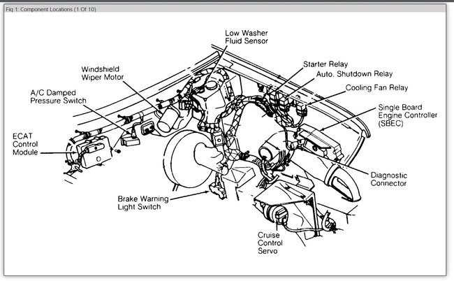

Dose anyone know where the fuel pump relay is on my 1991 dodge caravan (3.3 L V6)? I have looked on the drivers side fender and it is not there, I have called the dealer and ask them, they say it is on the firewall with one screw holding it on and gave me a part number, but I can not find that relay anywhere. It is not in the fuse panel ether. please help I am pulling my hair out over here.
Feb 8, 2008 at 9:18 AM
  • 55,273 POSTS

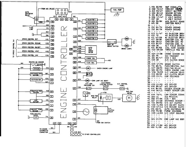

There is no fuel pump relay per say because it is control by the ASD relay located under the hood
Here is a wiring diagram notice the fuel pump in the right upper corner.
Here is a guide to help you test the relay
Please run some tests and get back to us so we can continue helping you.

1998 Dodge Caravan 4 cyl Two Wheel Drive Automatic 130000 miles
Where is it found and what does it look like>
May 12, 2017 at 12:04 PM (Merged)
BMRFIXIT
  • 19,053 POSTS
Under hood near battery in the fuse AND relay box
MOMMOMPOPPIE
where is the fuel pump relay on the power distribution center on 1996 dodge caravan
ERNEST CLARK
  • 1,730 POSTS
second from the bottom on the left.
CARADIODOC
  • 34,369 POSTS
Second from the end, next to the automatic shutdown relay. It's the middle of the three smaller relays.
