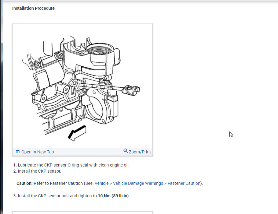

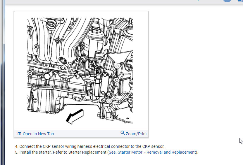

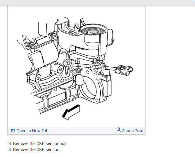

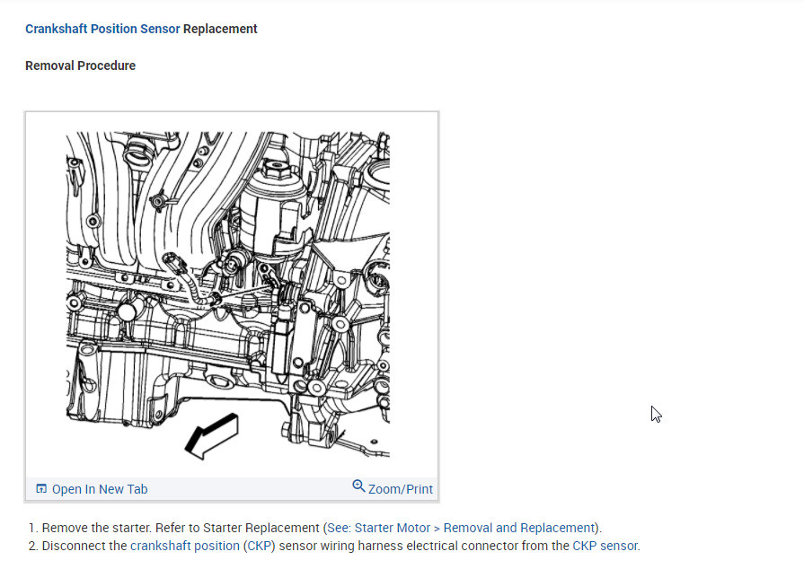

I have seen some sensors that are just not built correctly so I would start with returning this sensor and have them exchange it. Then make sure the sensor is not for another engine and they looked it up wrong. Looks like the sensor for the 2.0L and 2.2L are the same 12588992, but this just seems like the sensor is functioning but with these odd issues it is like the sensor is providing irregular information. If the replacement sensor does the same thing or other issues that were not there, I would suggest changing supplier of the sensor.
I am attaching the process for the sensor in case you need this. Also, if other visit this page they have it as well.
Let us know what happens and we can go from there. Thanks
