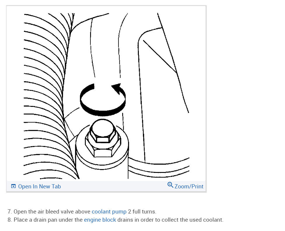

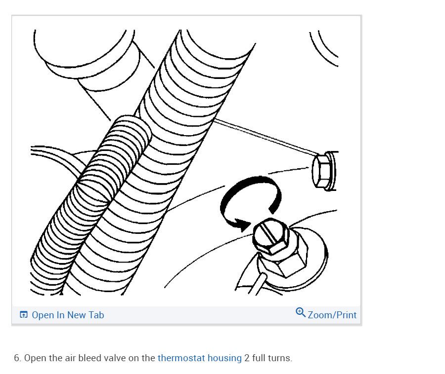

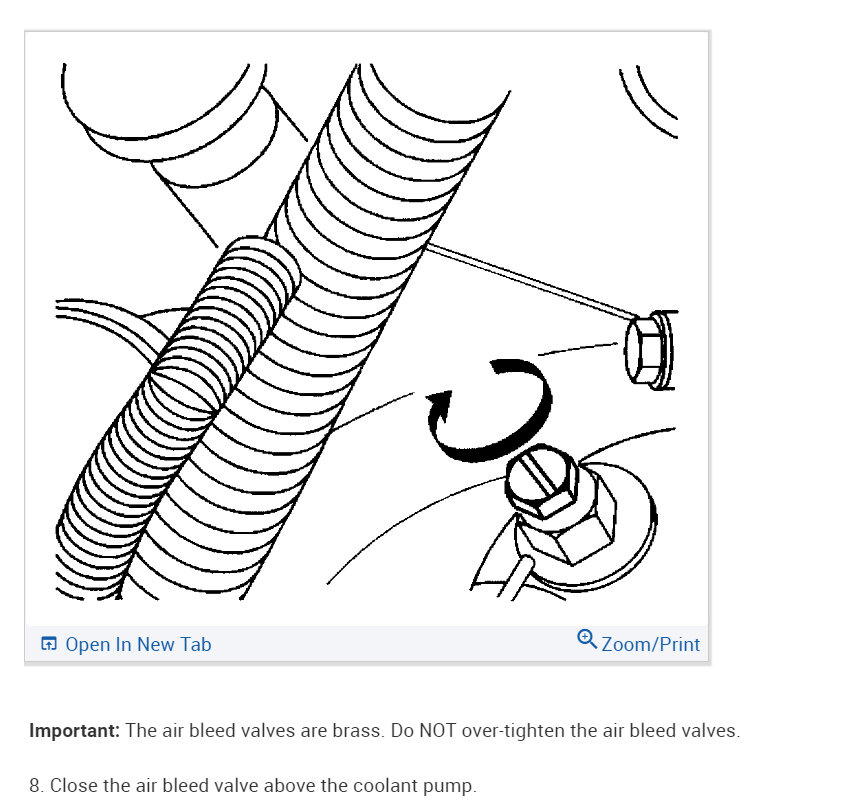

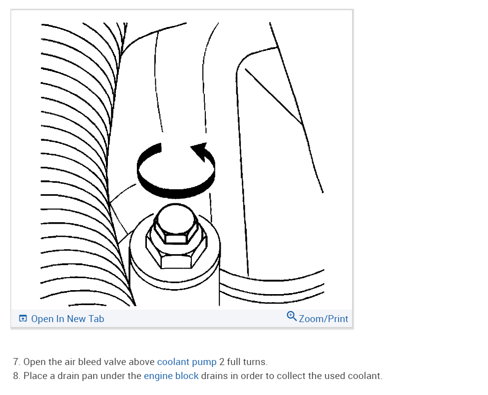

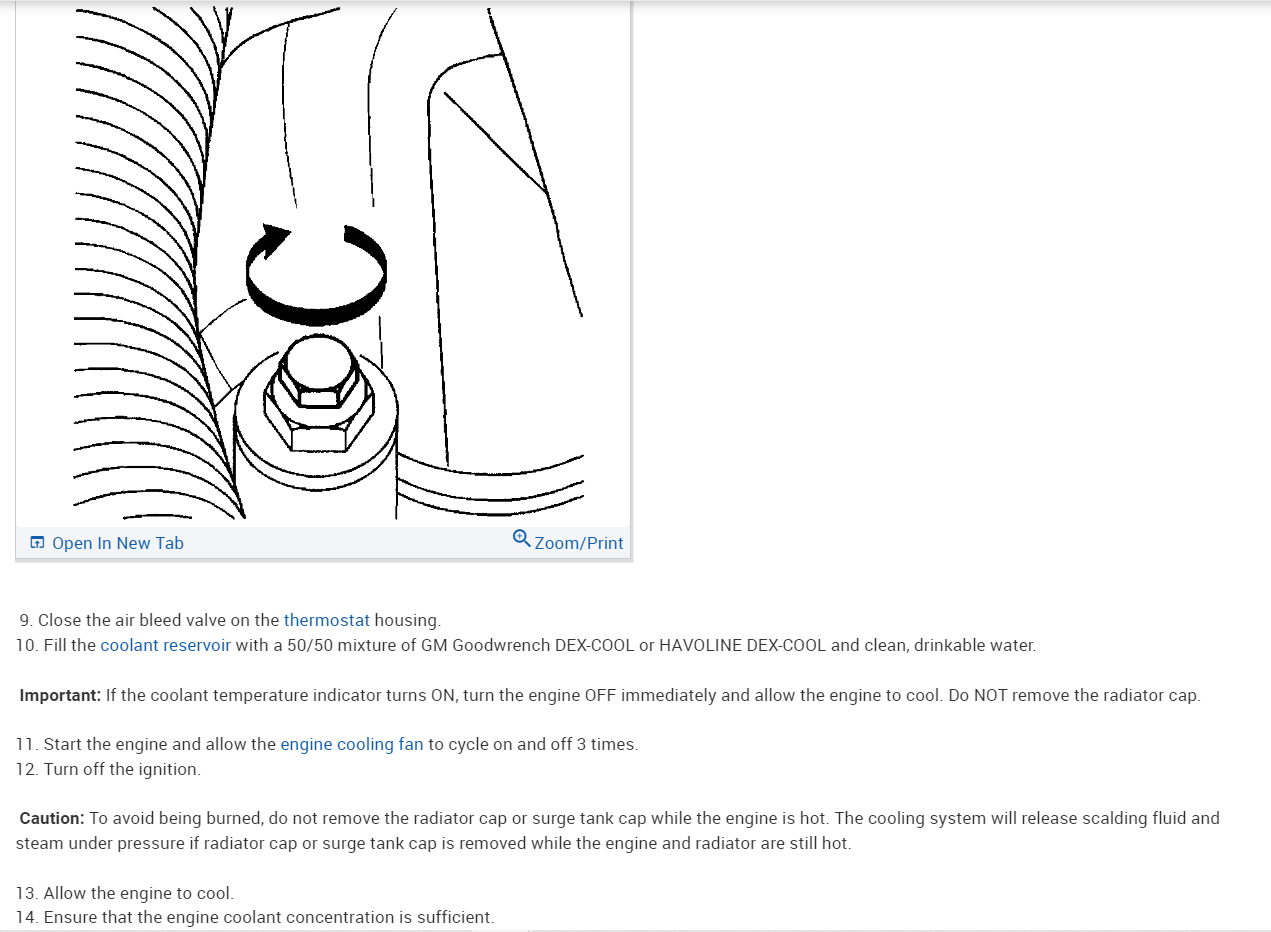

Hello, there looks to be two coolant air bleed locations on this vehicle. The one you know about and then one above the coolant (water) pump. I'll post a diagram of the instructions. There are also vacuum kits you can buy for helping to make sure all the air is out of the system. But I think trying to bleed the system by having both bleeders open when the vehicle is cold in the morning will help..
These steps are not in the exact order only because the steps in between are just the different coolant types and closing the drain on the bottom of the radiator.
but I usually do this when the vehicle is cold, that way there's no opening things when the system is under higher pressure and comes shooting out all over the place.

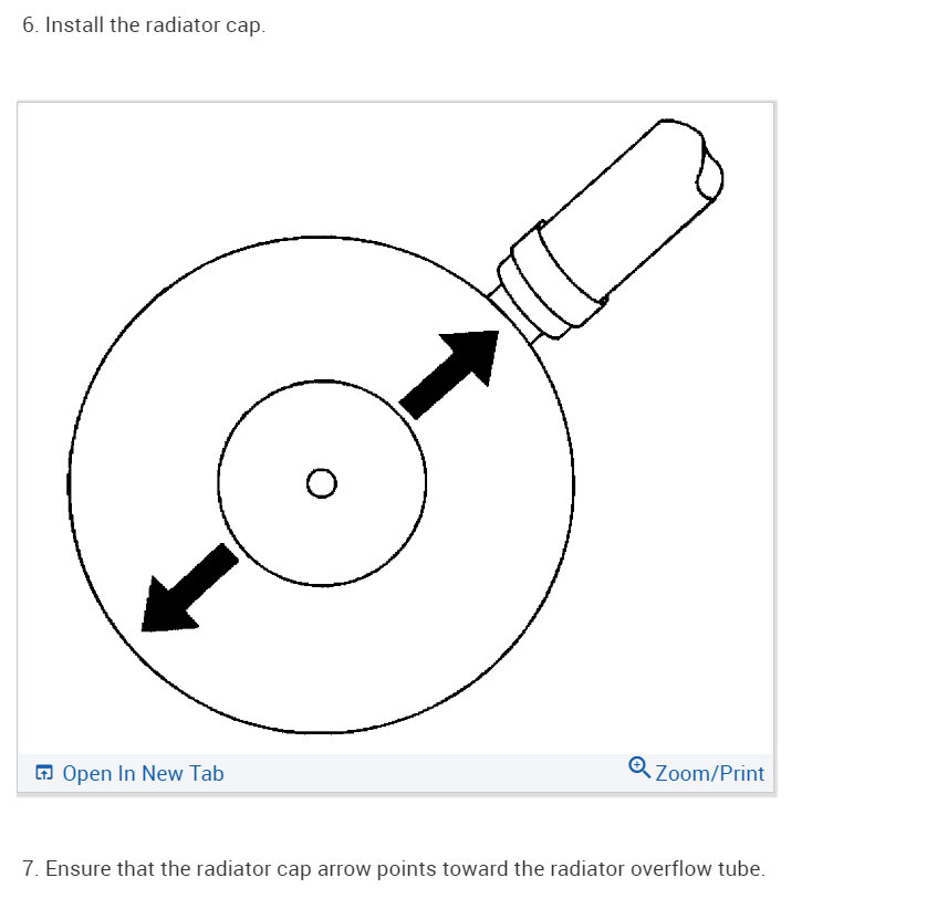

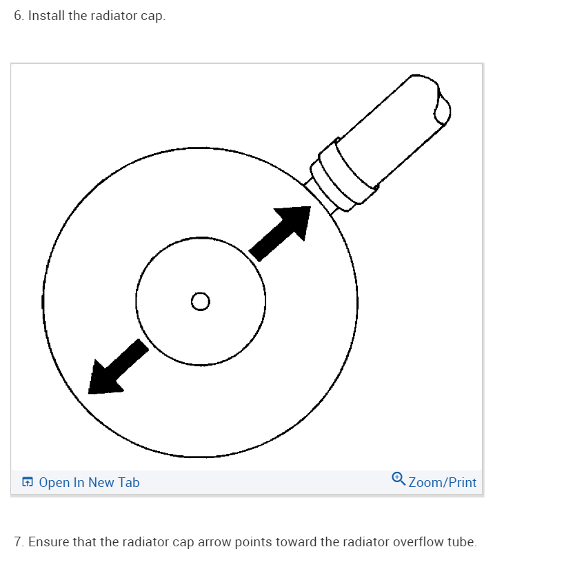

With the system filled, it is still cold and both bleeder screws have been opened and closed in order after the cap is on (and make sure you put the cap on correctly with the arrow facing the overflow tube).
You shouldn't have too much air building up like that. If you still do, I would wait until it cooled down enough that it's not going to shoot hot coolant everywhere, maybe the next day, and run the vehicle with the cap off, and watch for any bubbles or sign that there may potentially be a head gasket issue. That would be the next concern if pressure is building up so high that the coolant hoses start to expand so much.
Here are a couple guides to help:

It depends on the height of each bleeder, it looks like by the service information they need to be done in that order, as for why there was a pressure difference, I am not exactly sure.

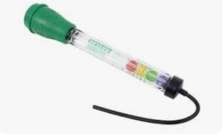

If you want to clean out the cooling system, you can do it section by section, such as taking the hoses off the radiator and flushing it with fresh water, allow it drain completely once youre getting clean water back out and you are sure any build up has been cleared out. But something to keep in mind if you use a water hose to flush these systems out is the cooling system is only designed to run at usually 15-18psi max, it will say the max pressure on the radiator cap most times, so you dont want to over pressure it or you will end up with leaks in either the radiator or heater core. I regulate the water pressure way down when flushing a heater core for example. And when flushing the engine block, you will not always be able to get all the water out that you flush with due to sections of the water jacket in the engine block not always the lowest point, so its good to have a coolant tester that will tell you the ratio of coolant to water once you start to refill it with fresh coolant. That way the mixture is not too much water or too much coolant.
Heres a picture of one that has different colored markers in it which will float at various levels to indicate the correct amount of coolant to water ratio. And a guide to flushing and refilling the system. But I would avoid those stop leak products, finding the leak and repairing it will prevent future issues..
