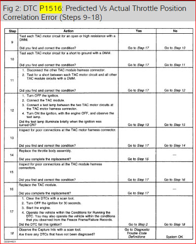

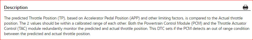

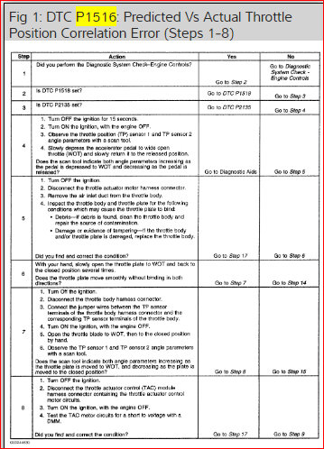

I have a problem with a P1516 code. I did replace the gas pedal accelerator, the throttle body wires harness and the throttle body. It is still doing same thing. What should I do next to get it done?

I've attached three pictures for you to view hoping it helps you diagnose your trucks problem. I've attached a tutorial showing how to test wiring.
Hope this helps and feel free to ask any questions if needed.Thanks for using 2CarPros.
