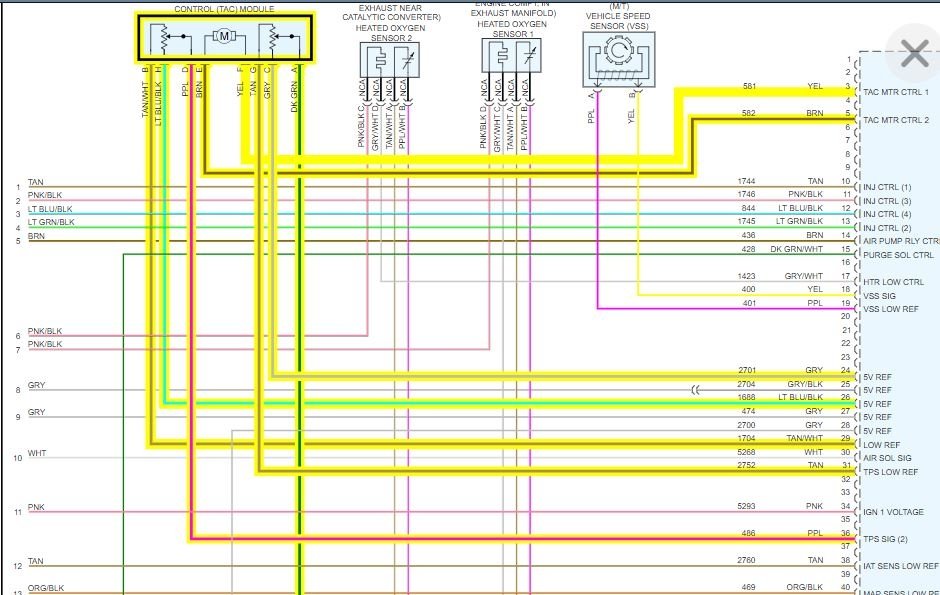

My problem start when I changed the cigarette light fuse and after that give me the reduce power engine and the code p0456 the throttle body I change it and the pedal throttle sensor too. The problem continues. If some body knows how resolve that problem let me know because I do not know what to do please.

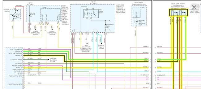

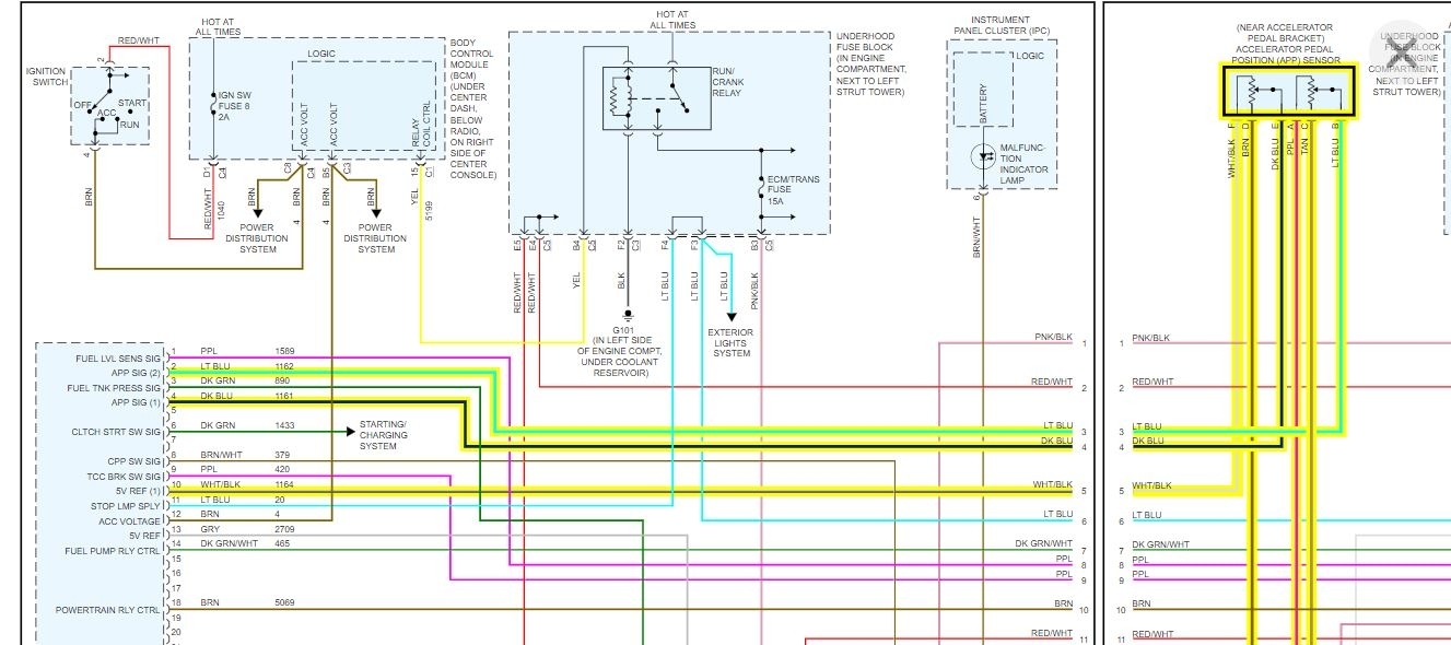

Did you verify any voltages from the throttle body to the pedal sensor?
I attached a wiring diagram for you to view. We need to do some basic voltage checks for this issue.
https://www.2carpros.com/articles/reduced-power-limp-mode
https://www.2carpros.com/articles/engine-has-low-power-output
I attached wiring diagrams of the throttle body and the pedal sensor. We need to verify the reference and signal voltages being sent to the ECM.
