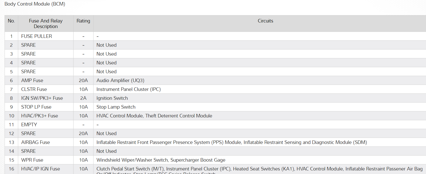

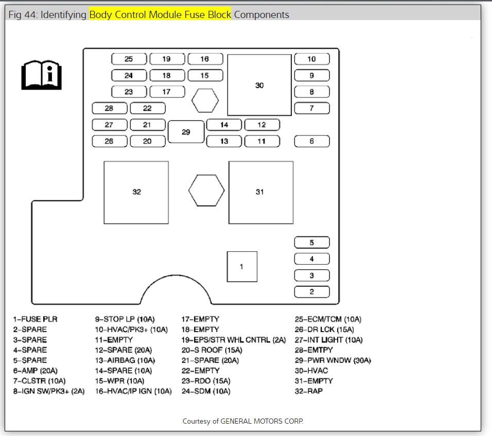

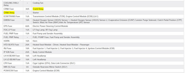

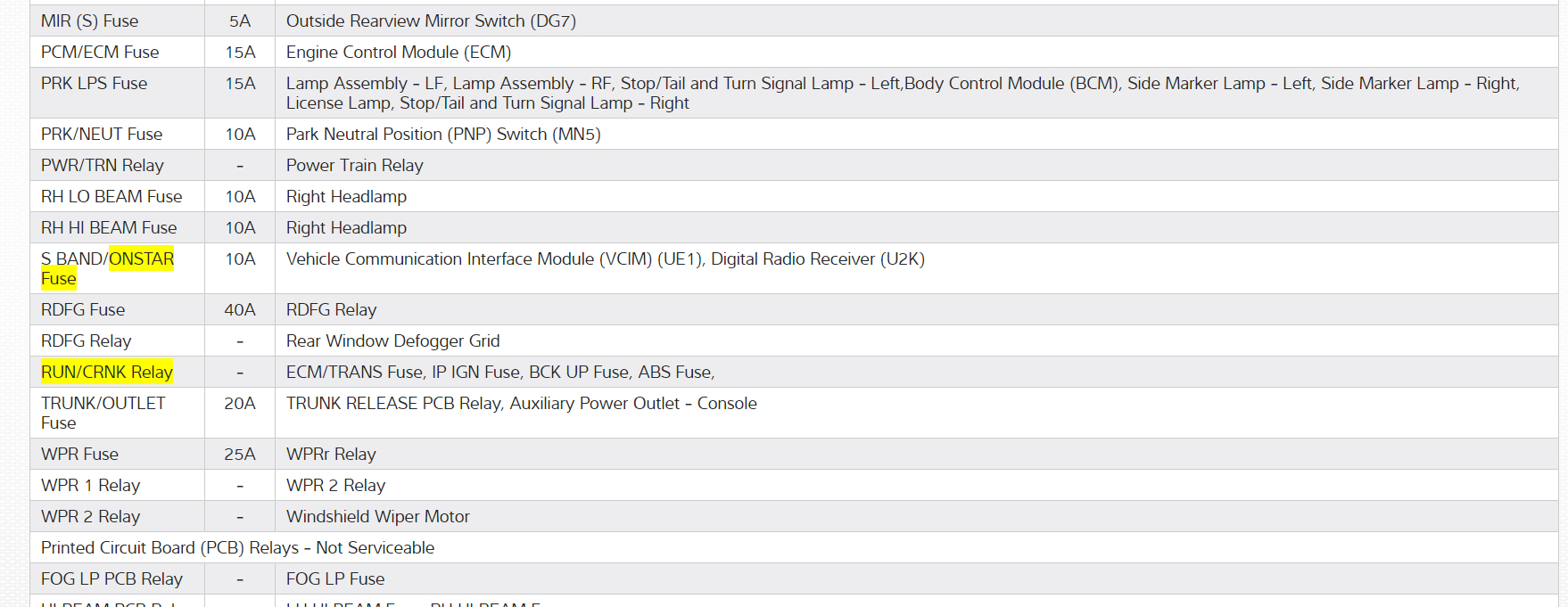

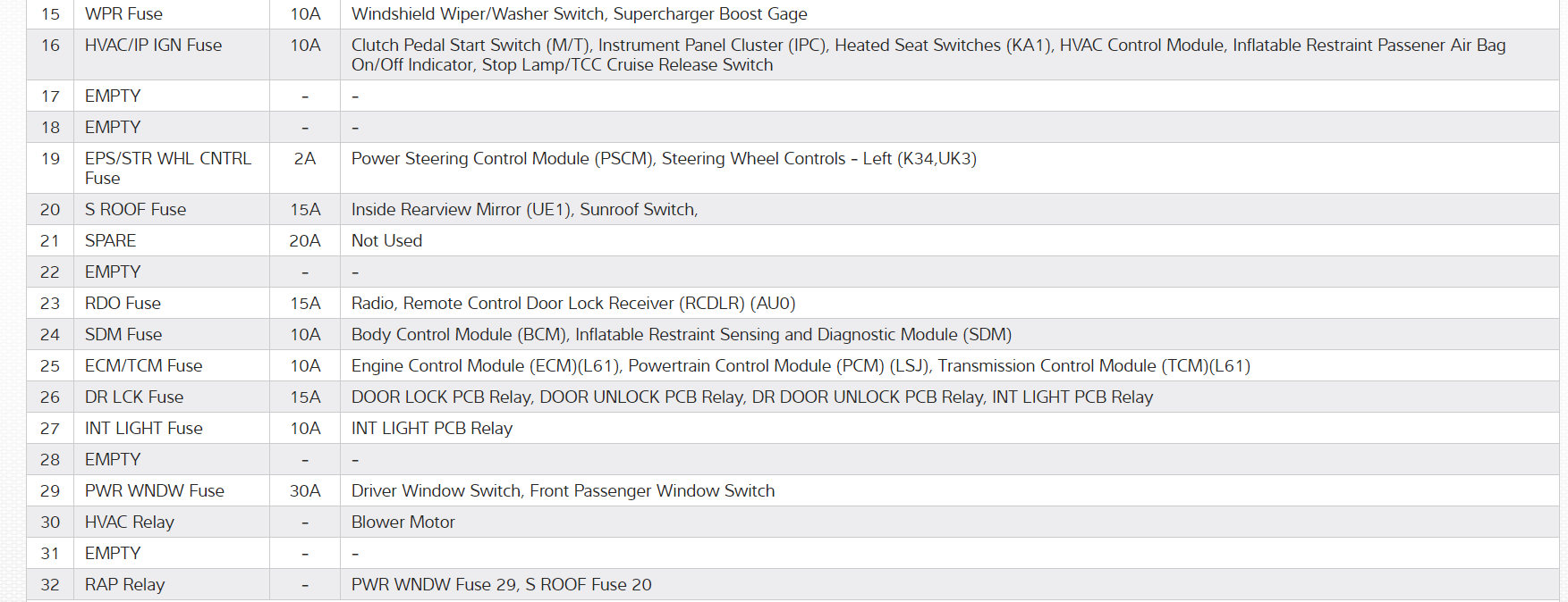

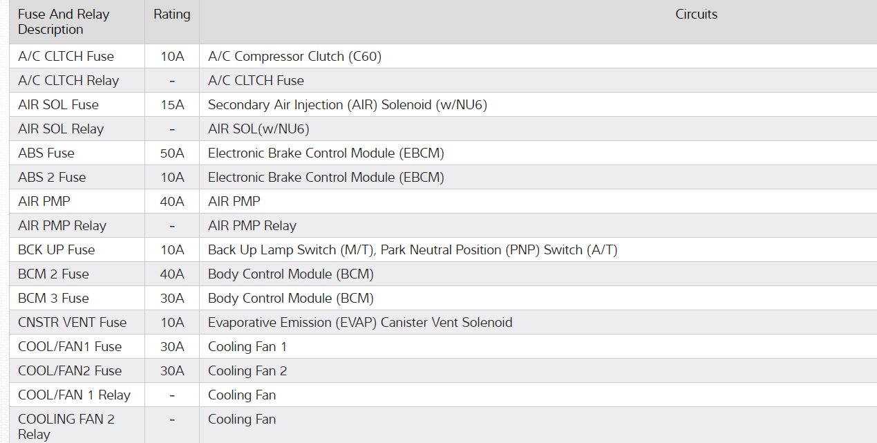

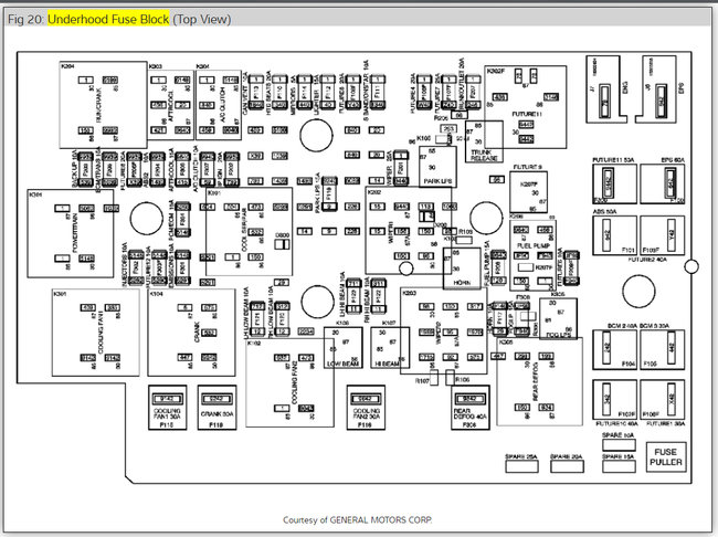

iI have a check engine light on and i hooked up my scanner to read the error code. The problem is the scanner does not power up so i checked between pins 16 (+V) and pin 4 (GND) and got no voltage reading on the vehicle connector. I tried the scanner in another vehicle and it works. Does anyone know where the voltage originates from?
Thanks
May 19, 2009 at 8:32 AM
OBXAUTOMEDIC
  • 3,711 POSTS

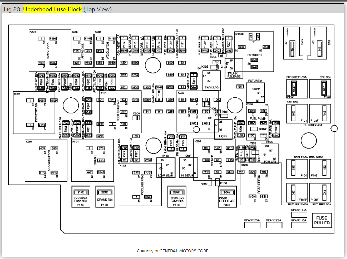

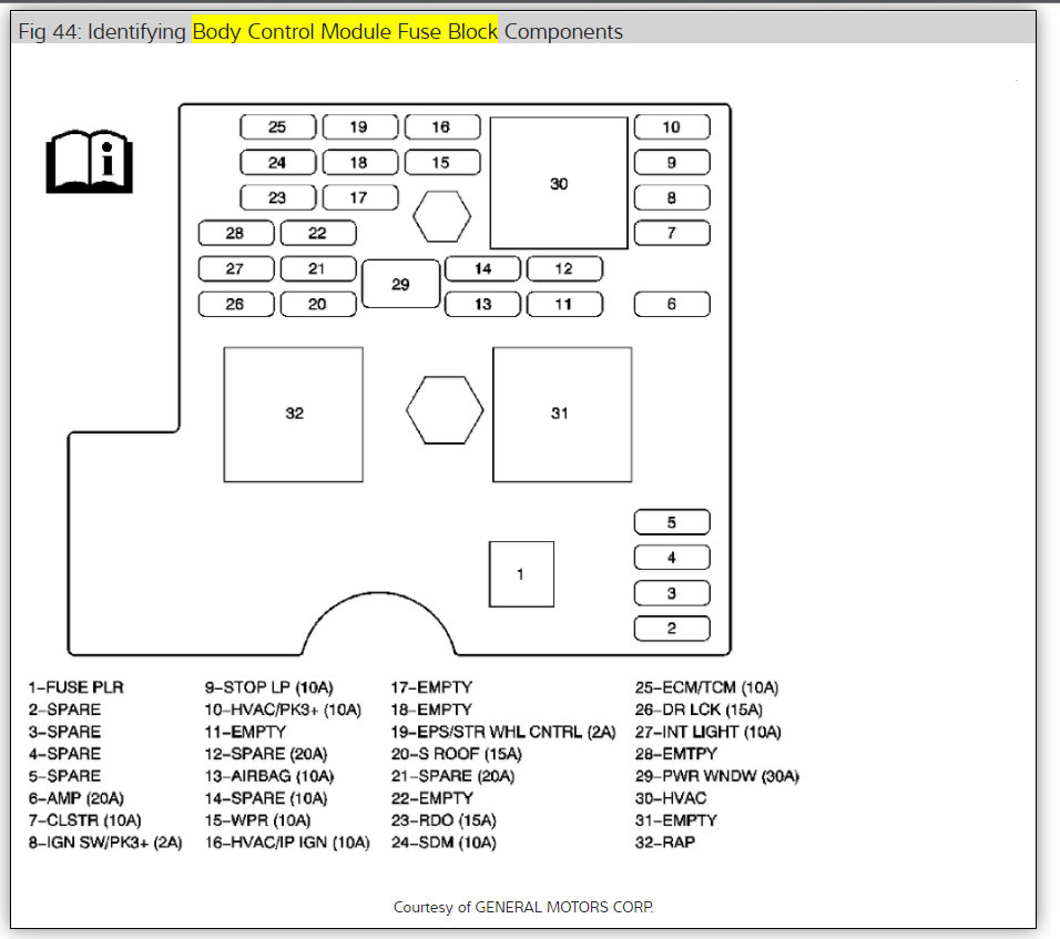

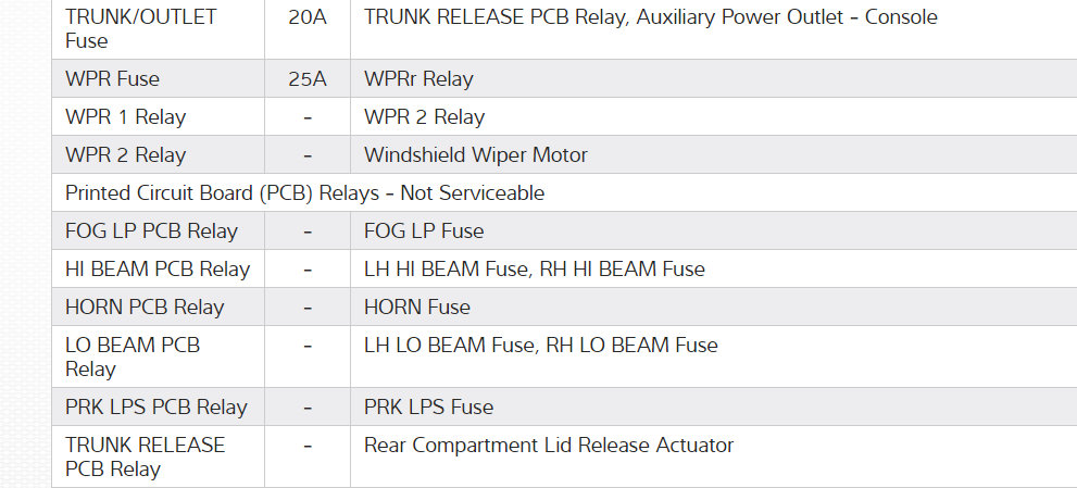

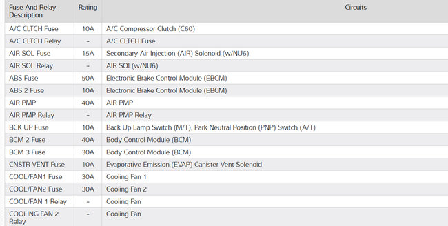

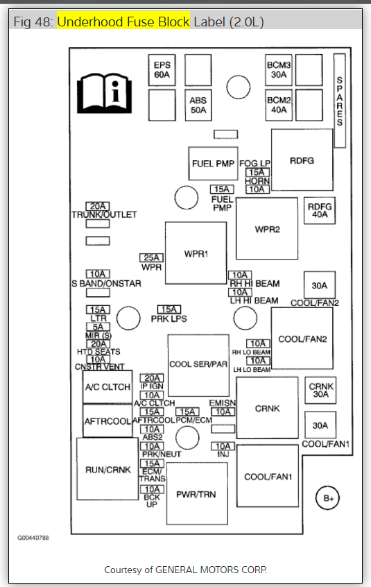

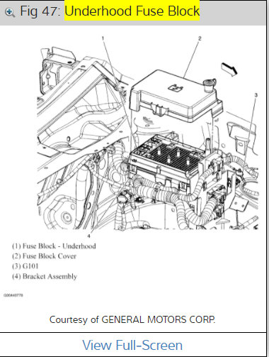

Check your fuses. Here is a guide to help and the fuse location in the diagrams below.
Check out the diagrams (Below). Please let us know what you find.
May 19, 2009 at 8:49 AM
FRANMOSSO
  • 5 POSTS
I checked every fuse under the hood and inside the car and all were good. A diagram would be awesome. Thanks

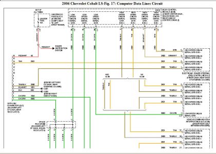

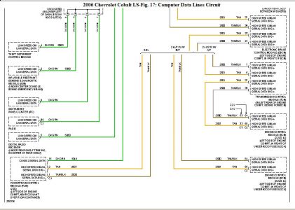

Here is the Schematic for the DLC... I will also email it to you for easier reading. I cannot find the Fuse Block Diagram for Fuse Locations....
https://images.2carpros.com/forum/automotive_pictures/188069_06Cobaltls22LDLCSchem_1.jpg
https://images.2carpros.com/forum/automotive_pictures/188069_06Cobaltls22LDLCSchem1_1.jpg

OK, i found the fuse that powers the scanner and replced it. Now when i hook up the scanner, it trie to link with the car but keeps comming up with link failure. Any ideas?
Jun 4, 2009 at 5:56 AM
OBXAUTOMEDIC
  • 3,711 POSTS
[quote:a70799cda2="franmosso"]OK, i found the fuse that powers the scanner and replced it. Now when i hook up the scanner, it trie to link with the car but keeps comming up with link failure. Any ideas?[/quote:a70799cda2]
With ignition off test for an open between the DLC terminal 2 and the terminal on the PCM harness connector that contains the class 2 serial data circuit.
post results....
Jun 5, 2009 at 9:26 AM
FRANMOSSO
  • 5 POSTS
Thanks, it was the PCM that was bad had to get a rebuild unit cost 156.00 all fixed up
