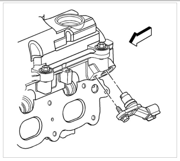

Im have a similar problem with my 05 cobalt im getting P0340
P0601 as the codes any ideas on how to fix it
+1
Thursday, February 1st, 2018 AT 5:26 PM
KEN L
  • MASTER CERTIFIED MECHANIC
  • 48,289 POSTS

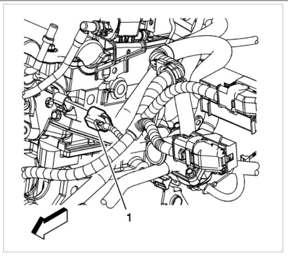

This will be a camshaft angle sensor that is not working right. Here is a guide to help you see what you are in for when doing the job.
https://www.2carpros.com/articles/camshaft-angle-sensor-replacement
Here is where is is in your car
Friday, February 2nd, 2018 AT 11:33 AM

Im in the engine compartment of my car and im not seeing the sensor anywhere
Wednesday, February 7th, 2018 AT 12:05 PM
MECHANICALIDIOT
  • 15 POSTS
Just change the sensor and the problem still is happening
