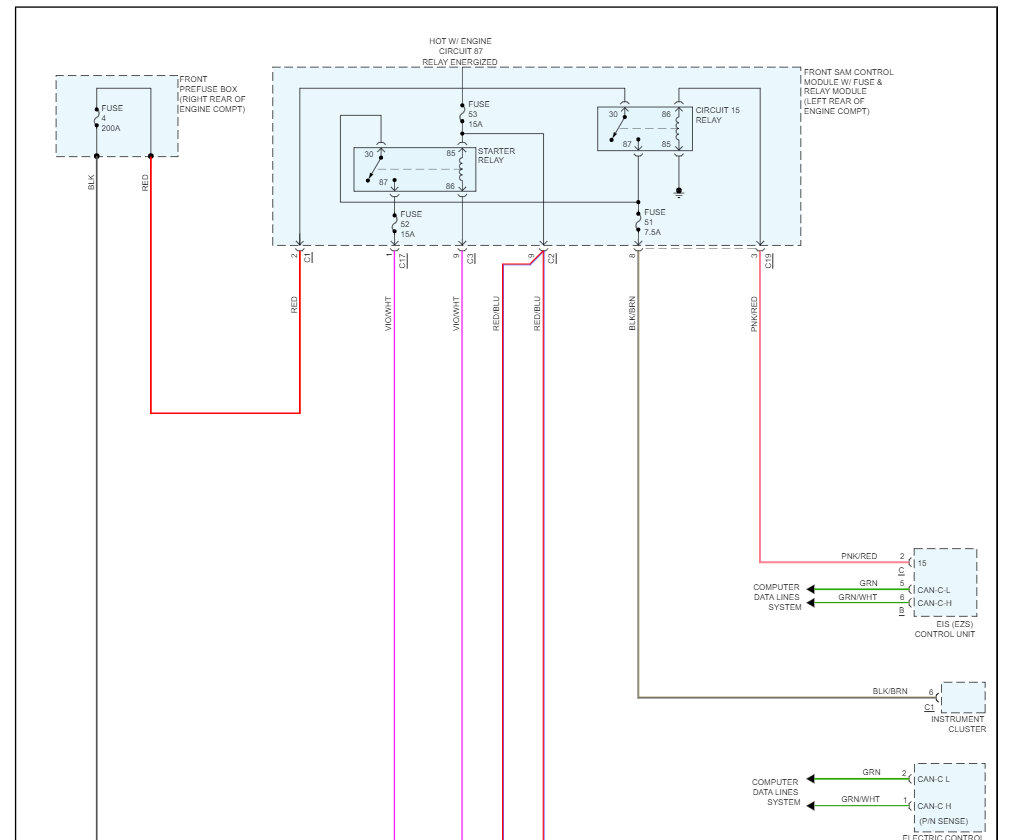

When starting engine cold after a few minutes when coolant temp gauge is about one third the red coolant temperature light comes on and engine shuts down and fuse 54 blows. Then it has no crank and no start. Replace fuse 54 and blows again when turning key to on position. I replaced coolant temperature sensor and thermostat housing and still the same. Disconnected the battery for an hour then connect and it will start and shut down again with temperature light on. No codes on scanner.
Sep 17, 2023 at 3:07 AM
  • 55,381 POSTS

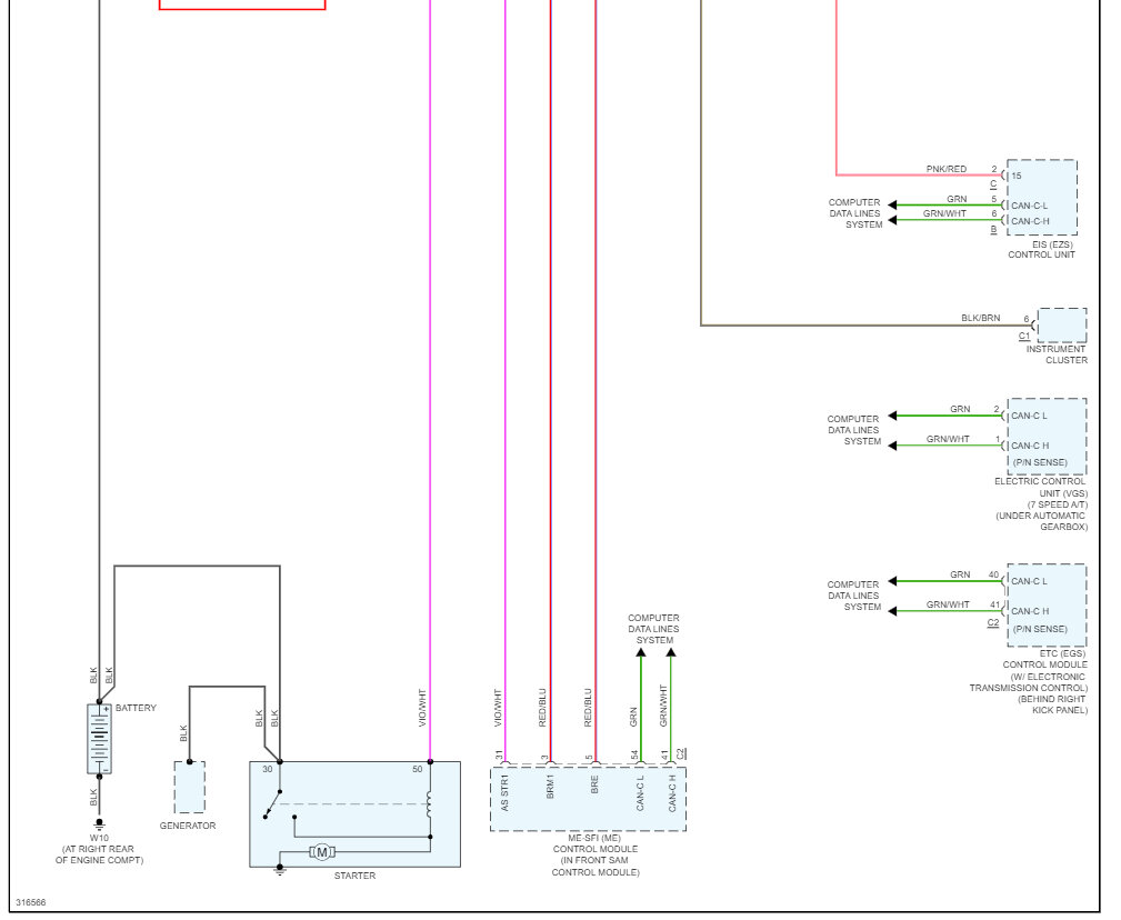

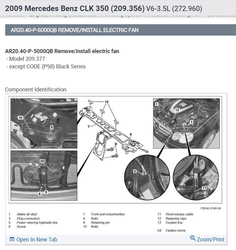

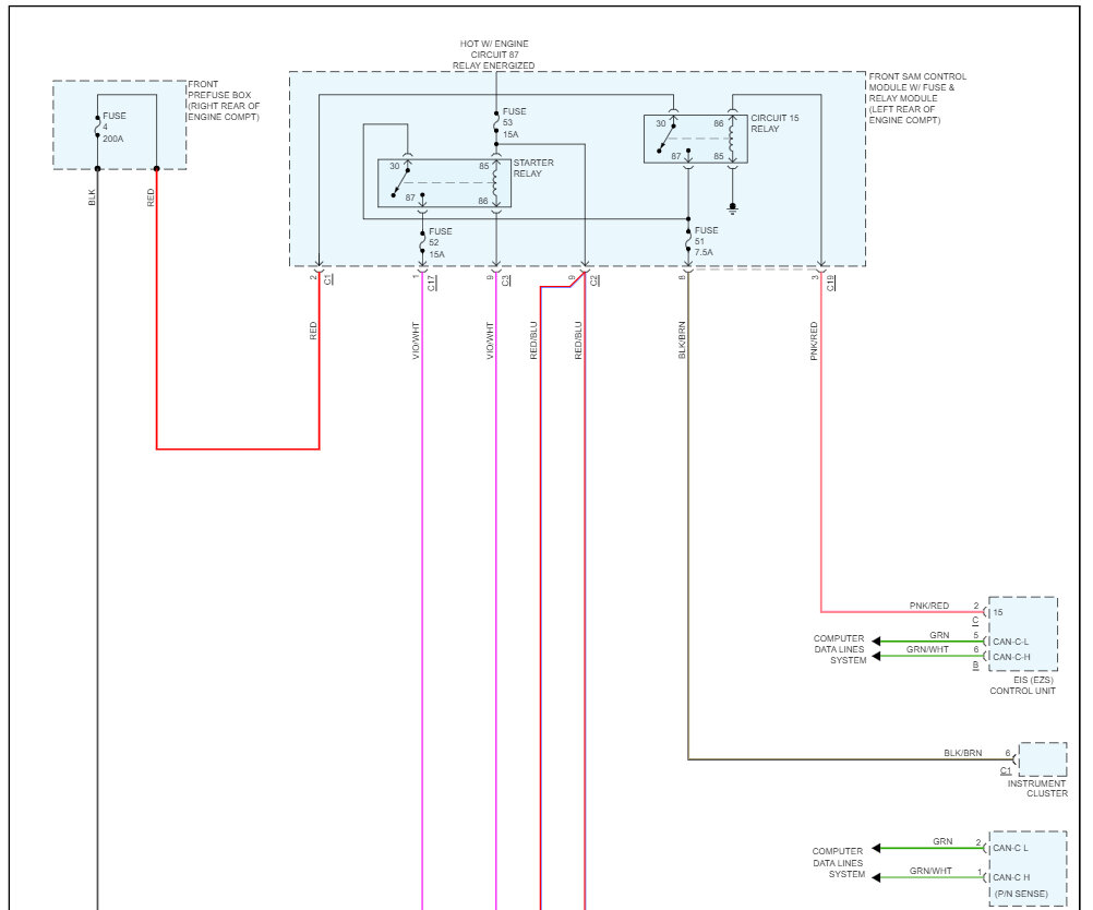

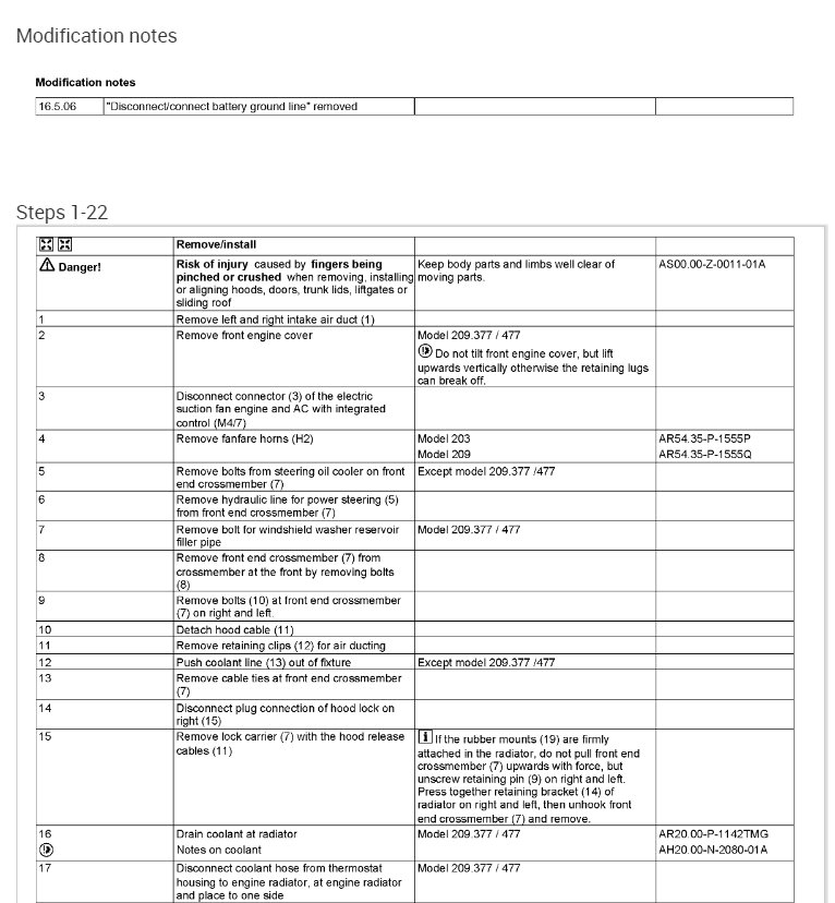

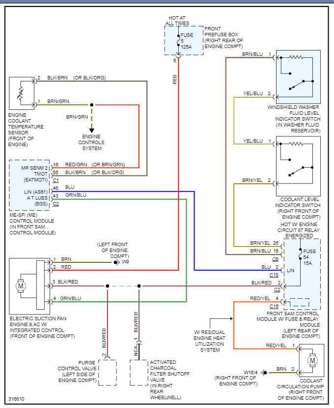

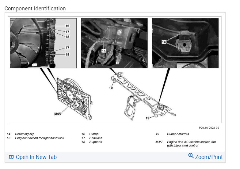

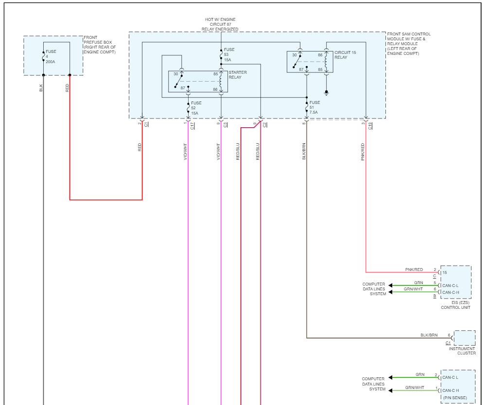

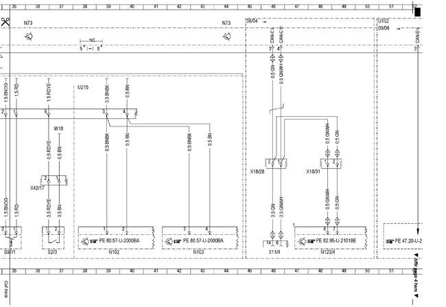

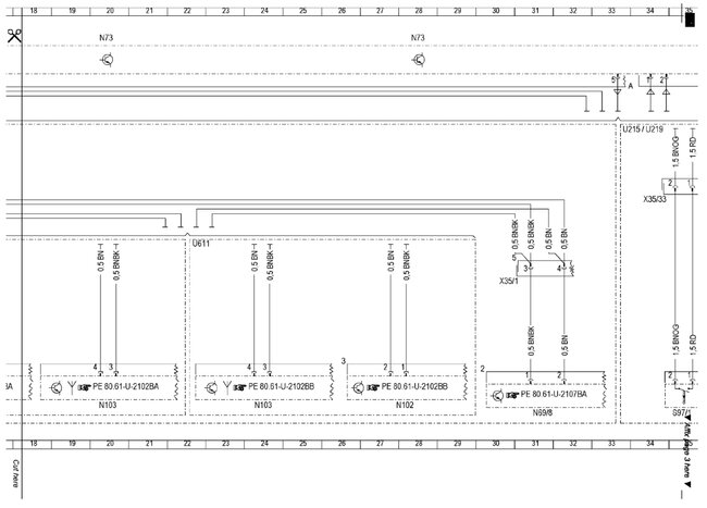

Yep, this happens when the radiator cooling fan has gone out. here are the wiring diagrams for the fan and fuse #54 so you can see how the system works and I have included how to change the fan assembly out. Check out the images (below). Please let us know if you need anything else to get the problem fixed.

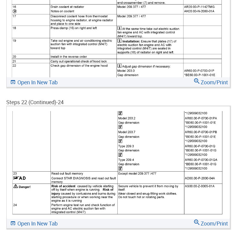

The fan has a simple power and ground connection which powers and grounds the motor, they vary the small ground wire to the module to control the fan speed. I would check the main ground and power and if okay replace the fan module/motor.
This guide can help and use the wiring diagrams above:

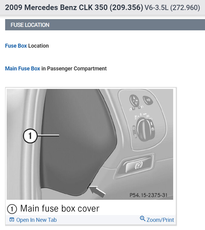

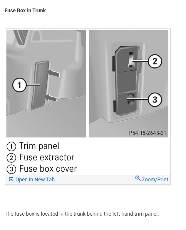

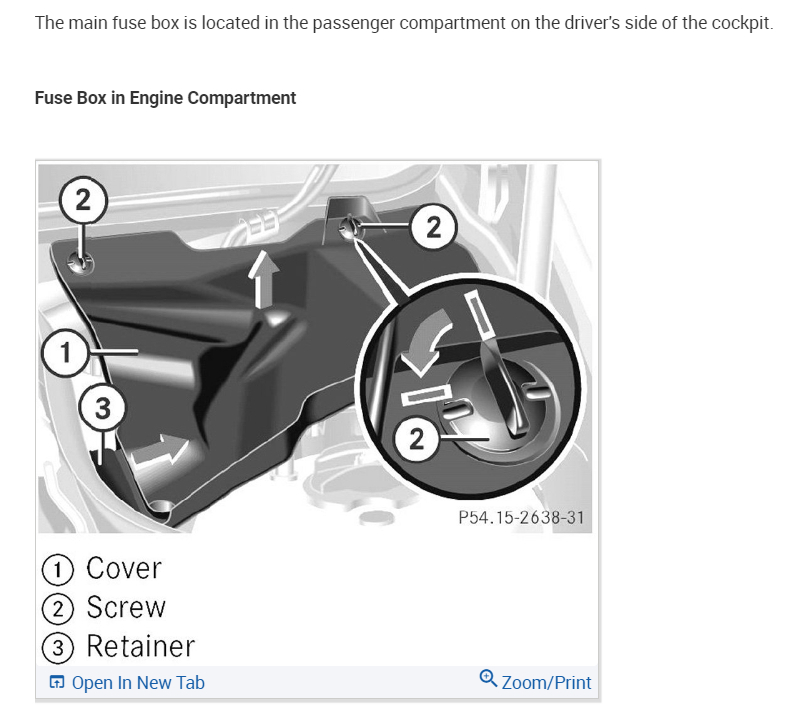

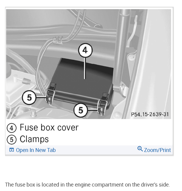

It sounds like you popped a fuse, I would use this guide and check all fuses I have also included the fuse locations.
test the fuses with the system on. Check out the images (below). Please let us know what you find.

Checked all fuses one at a time and all good. Did a volt and ohms check on relays in engine compartment and checked good for starter, air pump, seq asg pump, term 15r, term15. Also checked in trunk the relays for fuel pump, term 15, term 15r. Also, good. I don’t know where the pre fuses are . I think where the battery jump connection is with the red cover. Are there some pre fuses there to check ?

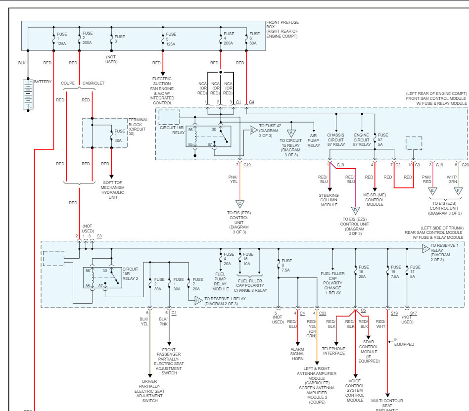

With the key on do you have power at fuse #5 in the under-hood fuse panel and fuse #54 on the front sam control fuse panel? Here is the main power distribution. You may have popped the front SAM controller. Check out the images (below). Please let us know what happens.
Sep 26, 2023 at 4:22 AM
HAL1958
  • 89 POSTS
Fuse 5 is in the trunk and my car does not come with that fuse, it’s empty. I check the power to fuse 54 under hood with key in second position and no volts. Is there a pre fuse that protects the front SAM that i can check? Also, how can I remove the SAM to check the circuit board? It looks like the wiper motor arm is in the way. Also how do I check the ECM? I heard they have problems with capacitors that go bad, and car will be dead. These parts are expensive, so I want to make sure it’s bad before I replace them. I want to do all the necessary troubleshooting first.
Sep 27, 2023 at 2:49 AM
  • 55,381 POSTS
Hmm, it looks like the info is incorrect, fuse #5 is for the fan control module and fuse 6 should be 60 amp but by the image you provided the fuse is 20 amp? Is this a Euro car?

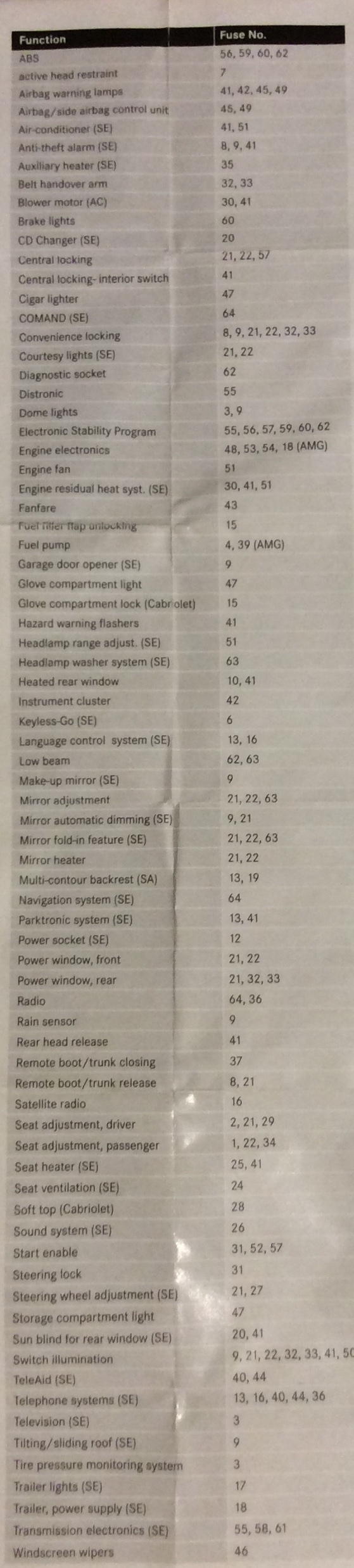

No, it’s not a Euro car. It’s called the Grand Edition model because it was the last year for clk350. I’m not sure if it’s a little different than the base model. I removed the front SAM and checked the circuit board, and it looks like new. Wiring and fuses all look good also. Part # is 2095452801. Part # of the ECM is A2721531092. Are there some prefuses that go to the front SAM? How can I check to see if it’s the ECM or the front SAM causing my no crank no start no sound?
Sep 28, 2023 at 9:19 AM
HAL1958
  • 89 POSTS
This is the fuse chart that came with the car.

Okay, it this point we should run the codes for the CAN which will tell us if the SAM or PCM is not working. You can get a CAN scanner (Controller Area Network) which will work on most cars from Amazon.

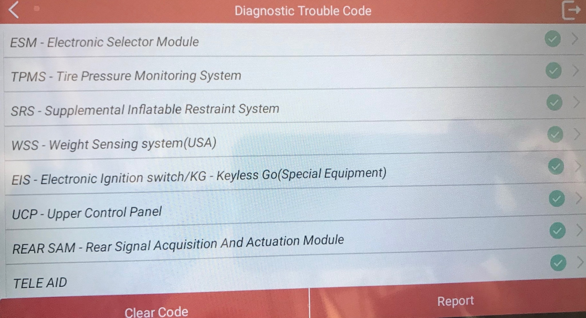

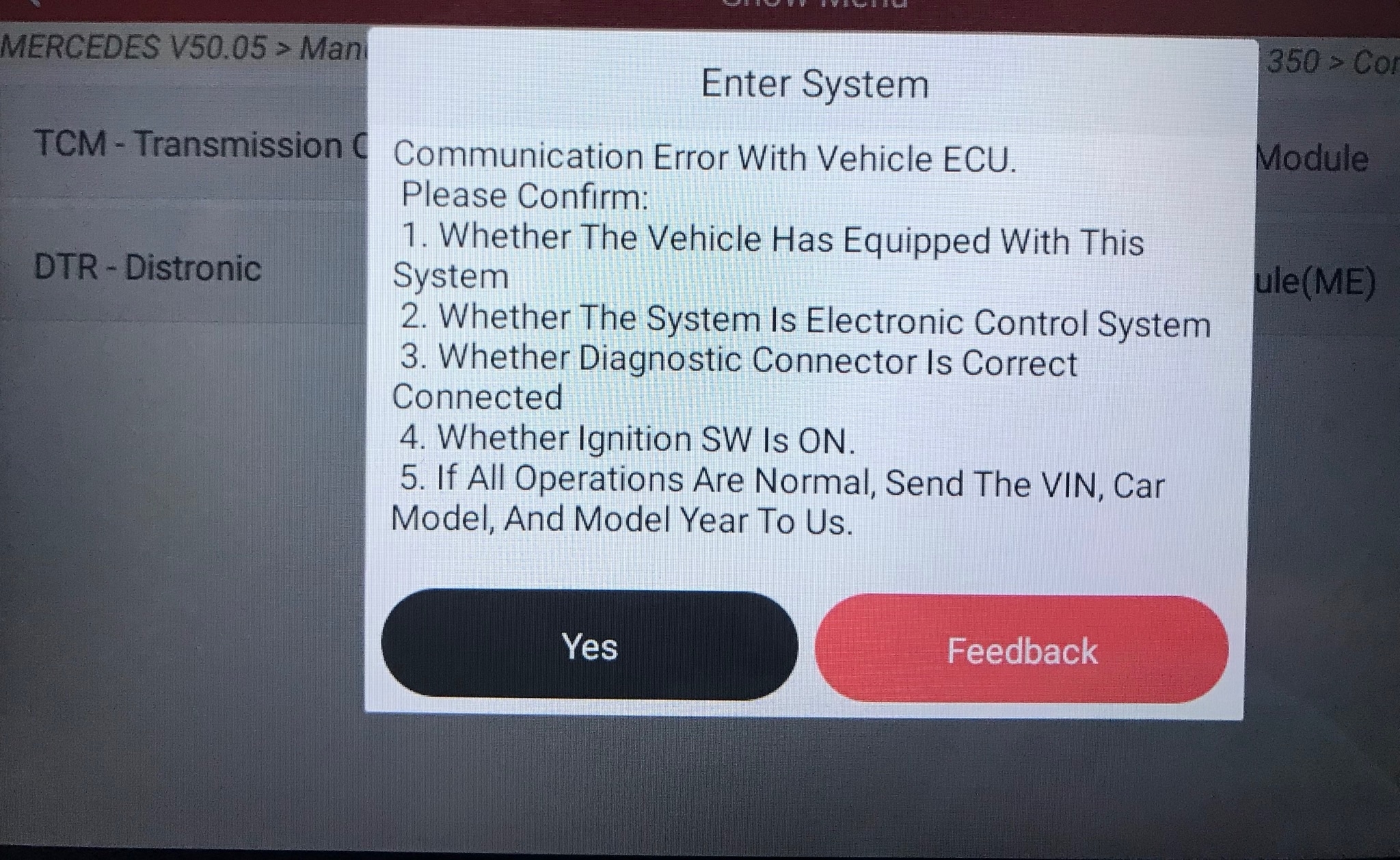

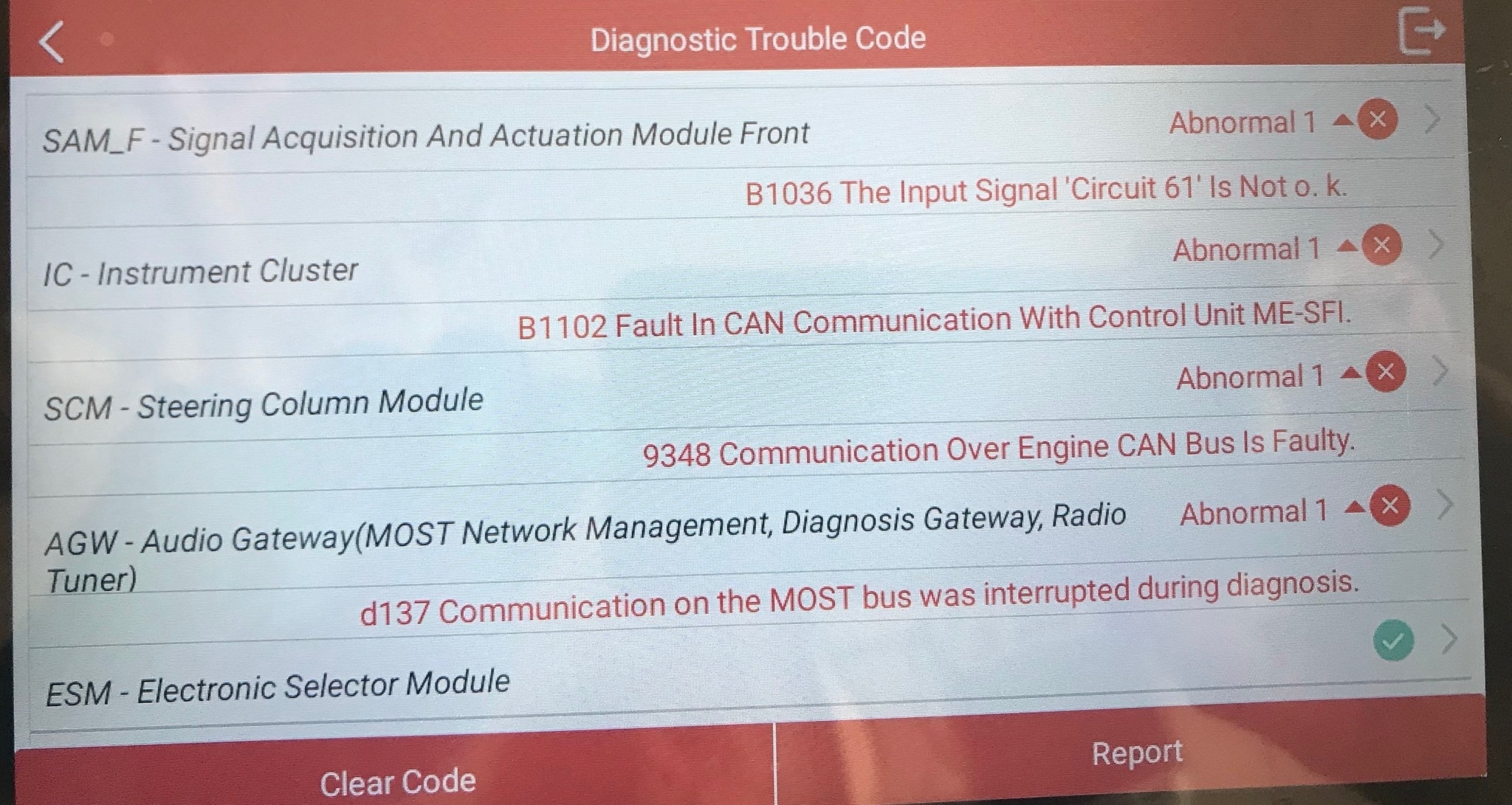

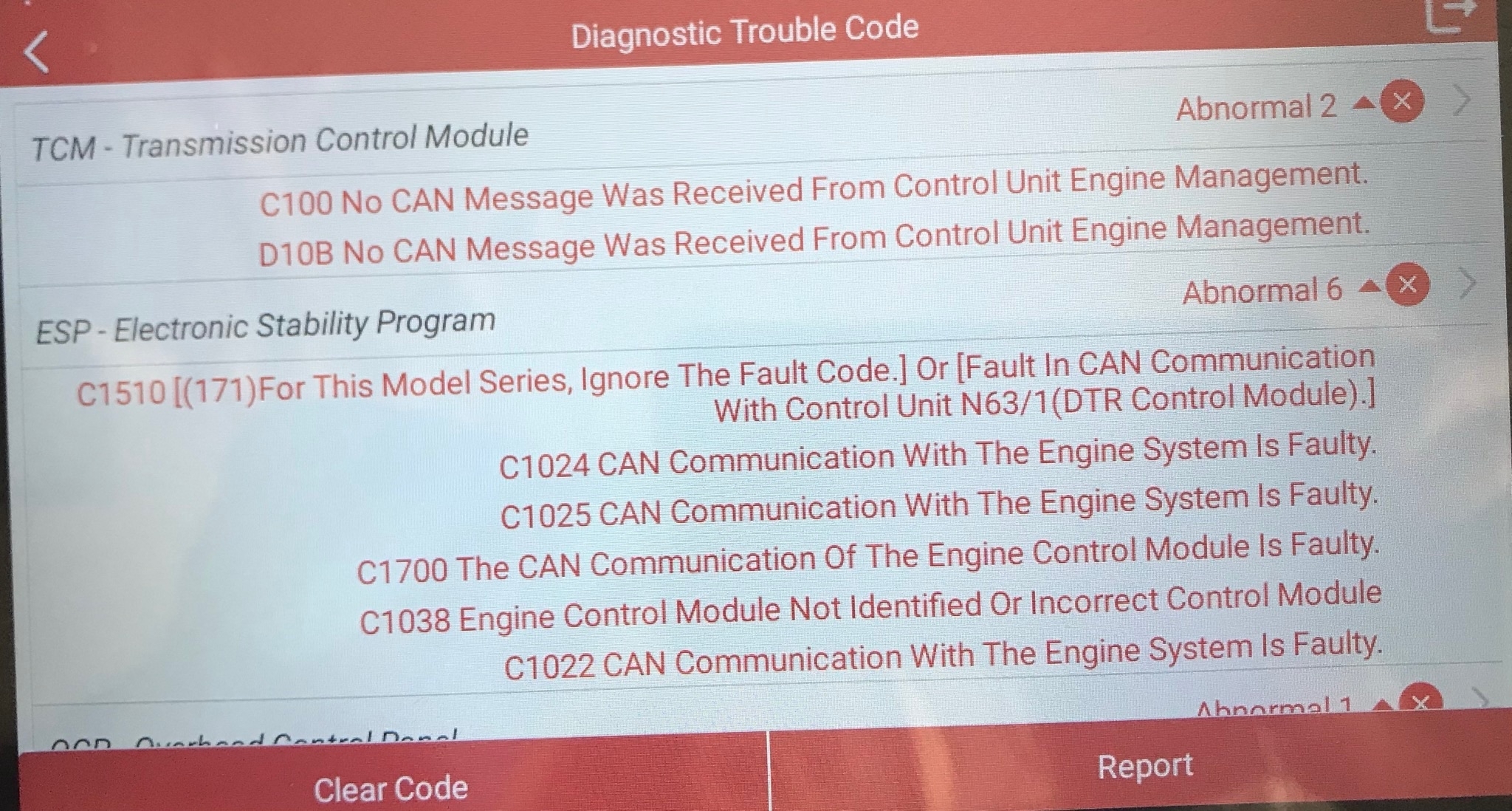

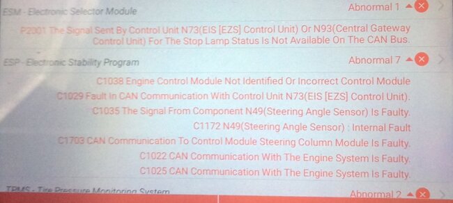

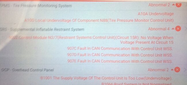

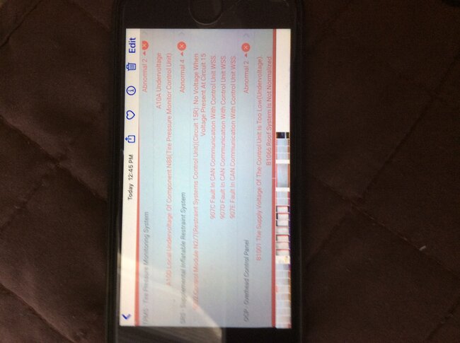

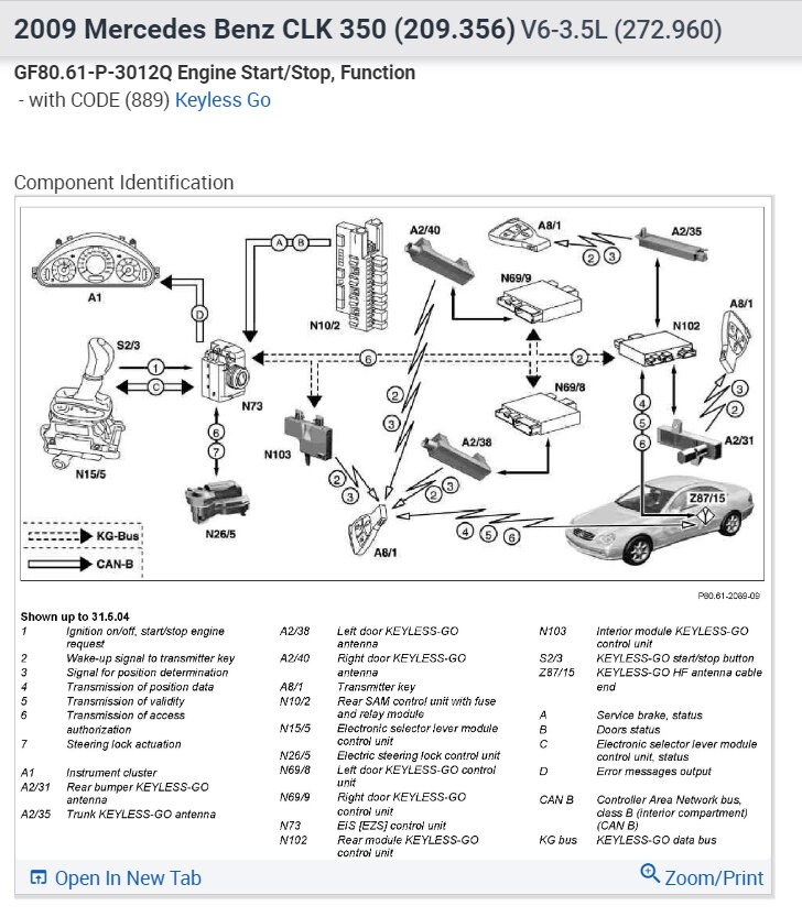

These are the codes i got using Launch 919x reader. Let me know if there are more checks i can do with this scanner to find problems. I would like to try the least expensive repair first that may fix my problem. I’m enclosing pictures of the screen codes.
Oct 7, 2023 at 11:34 PM
  • 55,381 POSTS
You got some codes there :) The majority of them seem to point towards the bad engine control module. But I did see a code for the circuit 87 which feeds the controller. Does the engine run? If so, I would clear the codes and then turn the key on without starting the engine to see if any come up. Also, can you remove the front SAM control wiring connectors to see if there is any corrosion? Also, you might be able to open the unit up to see if it smells burnt.

No engine does not run. No crank, no start, only dash lights. With the key in start position no fuel pump sound or no starter clicking. The radiator fan still comes on high speed with key on and shuts off with key in off position. Replacing fan, I think was a waste of money. I checked the front SAM connector pins each one and circuit board and no corrosion. I opened ECM and board has no corrosion. I cleared all codes and then rescanned. I enclosed the pictures of codes. The ECM doesn’t show up in scan this time. When I tried to enter ECM in control units it showed communication error. Are there some checks i can do to see if ECM is sending signals to start car?

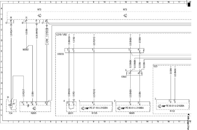

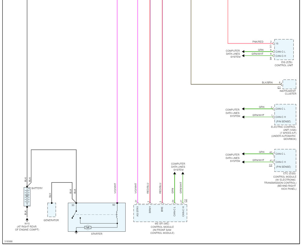

I don't see the images? also testing the ECM can be difficult I would remove it and send it in for evaluation. Here are the starter wiring diagrams so you can see how the system works.
Oct 11, 2023 at 12:37 AM

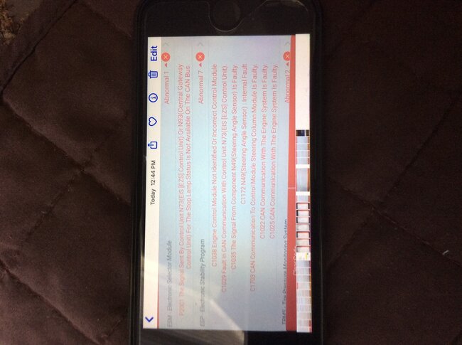

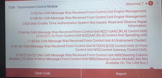

Last scan pictures after clearing all codes and key in 2nd position. Is there anything i can do with my scanner to get the ECM to reset so the scanner can communicate with it?

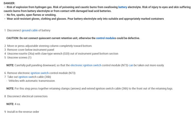

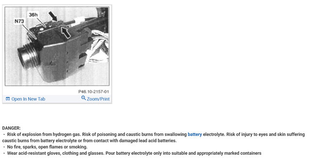

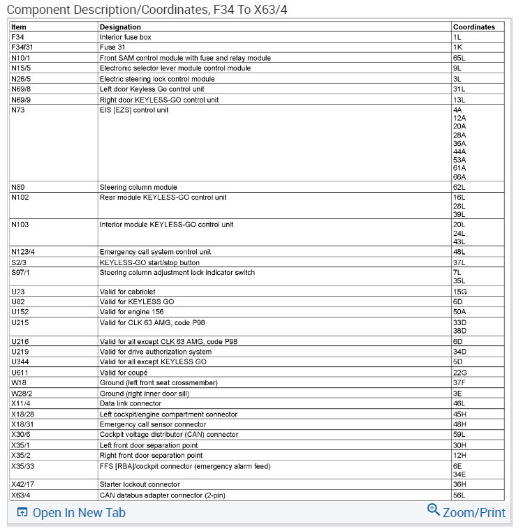

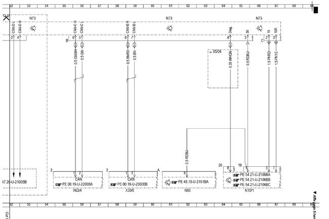

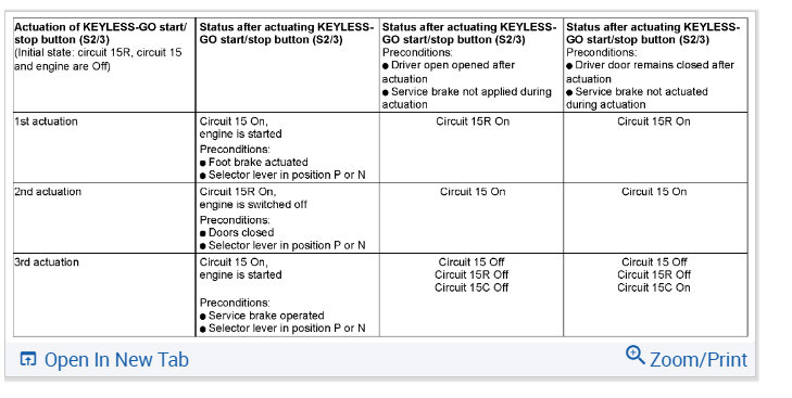

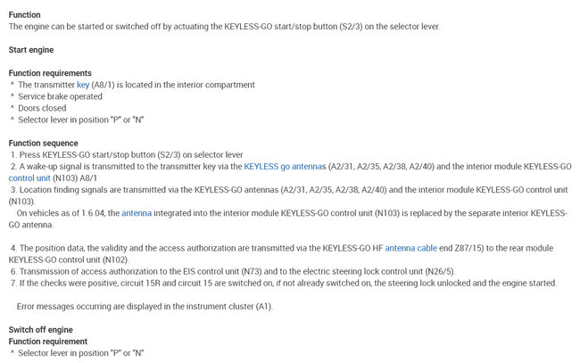

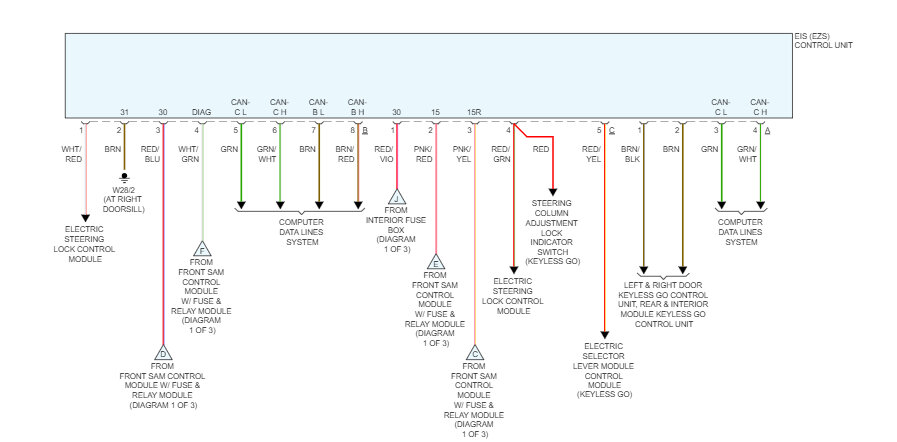

Can you send me a diagram of the ignition switch to all the components involved in starting the car including the PCM signal? Also, do you have a troubleshooting chart from Mercedes that shows step by step what to check in a no crank no start to pinpoint the bad component?
Oct 11, 2023 at 11:04 PM
  • 55,381 POSTS
Sure, here is the information you have requested. It still seems like the front SAM module to me. Check out the images (below). Please let us know what happens.

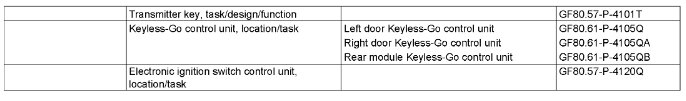

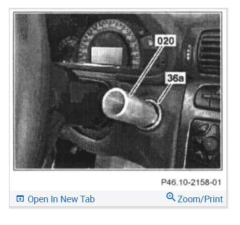

I ordered a used front SAM with same part number from a 2007 clk350 to avoid programming. I’m hoping it will be plug n play. Will take a few days to arrive. The wiring diagram you sent me I don’t see the wires from the ignition switch to the other components. I would like to see where the signal goes in the wiring in all three key positions. So, i can check voltage at components. Can you send me that?
Oct 13, 2023 at 5:38 AM
  • 55,381 POSTS
yep, the ignition switch is the EIS control unit which I have provided above. Let me know what happens with the used front SAM module.

I cleared the codes then rechecked with the key on. I have a lot of codes still. TCM, ESM, ESP, SRS, IC, AGW. Front and rear SAM shows good. SRS is showing on dash not operating. Also, radio shows on screen diagnosis and will not turn on. I’m enclosing codes.

2 more codes plus 3 above.

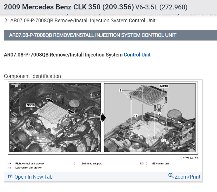

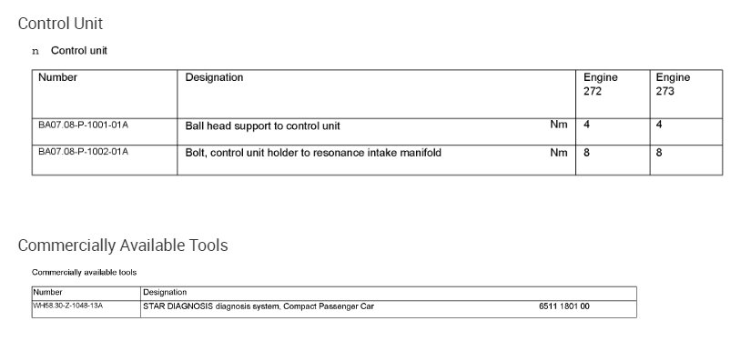

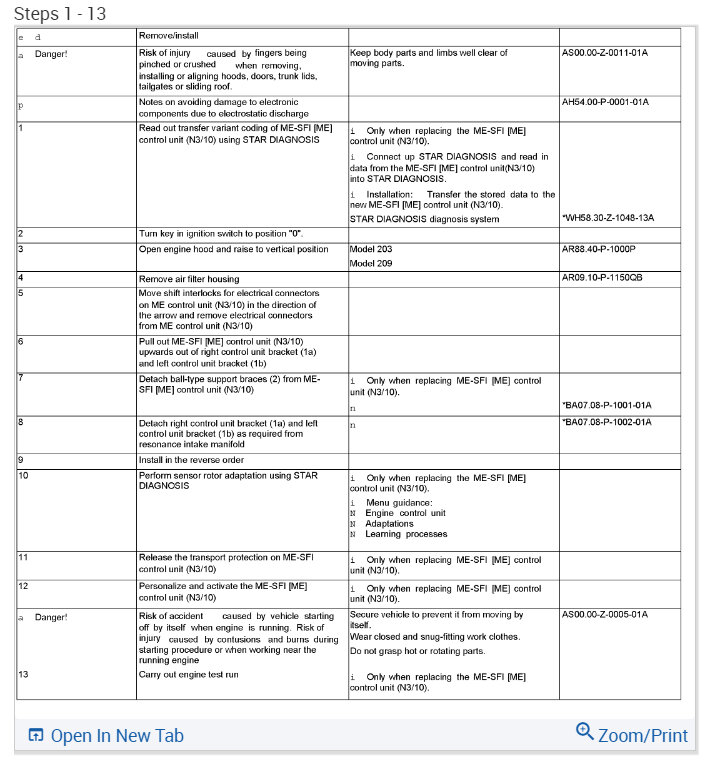

Sorry for the delay, yes, I looked at the codes and it does seem like the PCM is out. Here is the location so you can send it out to be checked. Check out the images (below). Please let us know what happens.
Oct 25, 2023 at 1:43 AM
