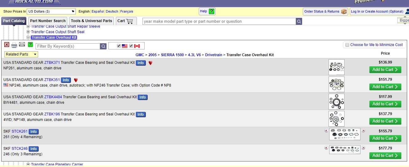

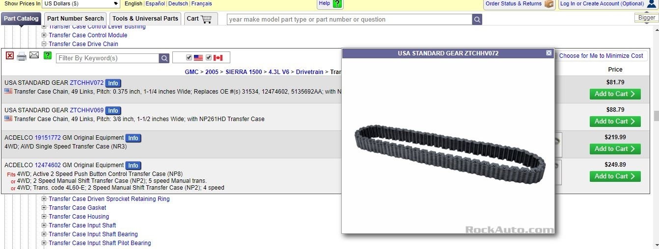

Okay, looking to rebuild my transfer case as it broke inside. I am looking to buy a transfer case rebuild kit, but need to try to find out the chain size as the one I'm looking at says you need to get the correct chain and you need to know how many links are in the chain and pins. how do you find this out 2005 GMC Sierra 1500 it a np246?

I attached the kit and the chain for you to view. There is only one chain for the 246 case.
Sep 22, 2019 at 1:10 AM

Okay, thank you. now I know what chain to get, now what about the transfer case rebuild kit itself since you have to buy that one separate which one would be the one I needed?
Sep 22, 2019 at 1:22 AM
The one I posted. It is for the 246 case.
