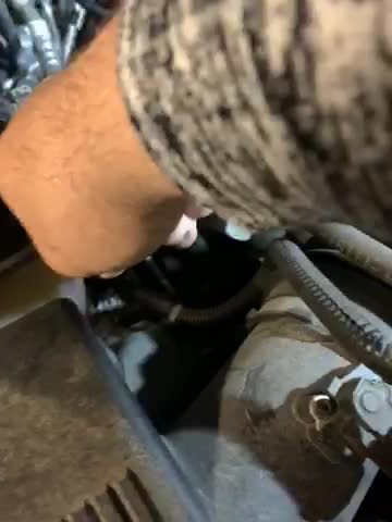

We have the SUV listed above XL Denali. we turn on the air conditioning and cold air blows in the rear and warm air blows in the front vents. Left to right works properly and all modes work properly.

It doesn’t make sense that the rear vents would be blowing cold and the fronts warm.
May 27, 2019 at 6:50 PM
Yes, it does. The rear has its own expansion valve and the front has its own as well.
I need the gauge readings to help

I have seen a lot of people suggesting valve door actuators. Can you please point me in the right direction on what gauges to buy/borrow and how to take the high and low side reading?
May 27, 2019 at 7:09 PM
You can rent a set of gauges at a parts store or buy a cheap pair at Harbor Freight.
There are ports on the AC lines to attach. You cannot mess up on installing on the ports.
Run the engine with the AC on and tell me the readings on the red gauge and the blue gauge.

I also recharged it with one of those cans form auto parts store and no dice.

Okay. I have zero pressure in low side. I never heard the compressor or condenser kick on. Whichever is supposed to.

I charged it with one of those A/C pro cans and now I’m reading about 29 on the low side. After a minute or two it is dropping to 25.
May 28, 2019 at 6:18 PM
That means you had no freon in the system.
You have a leak and you need to find the leak in order for it to work properly.

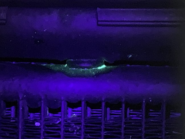

I think I found the stupid leak. Looking through the grill, I found this in the top right corner of condenser.
May 28, 2019 at 7:43 PM
Yep, that's the leak.
Replace the condenser and the dryer and evacuate and recharge.

Replaced condenser and dryer. Pressure is reading about 45 after recharging it with a r134a can and it still isn’t very cold.

How much did you add?
Did you replace the dryer? That is required.
How long did you evacuate the system?
Jun 6, 2019 at 1:29 PM
GEOFFPEARL
  • 31 POSTS
I added a 12 ounce can then another maybe 4-6 ounces. I did replace the dryer too. I did not evacuate but it seems to be blowing colder now. At least cold enough that my wife isn’t complaining. :)
What does evacuation do?
Jun 6, 2019 at 2:53 PM
Boils all the moisture out of the system. If you have moisture, it will not produce enough cold air.

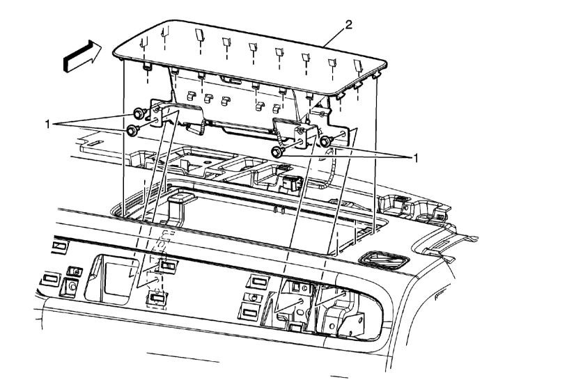

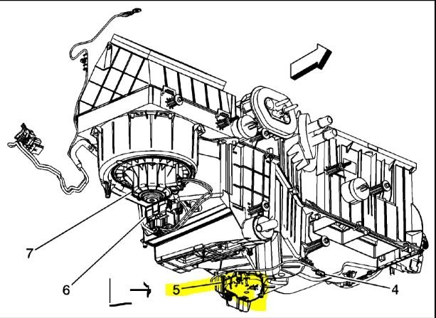

A/C is blowing cold everywhere other than passenger side of vehicle. same when you run heat most of the time it blows warm but other times cold only. Have changed the drivers side blend door and cannot locate passenger side. any help is appreciated, wife is complaining!
Jul 16, 2020 at 11:41 AM (Merged)

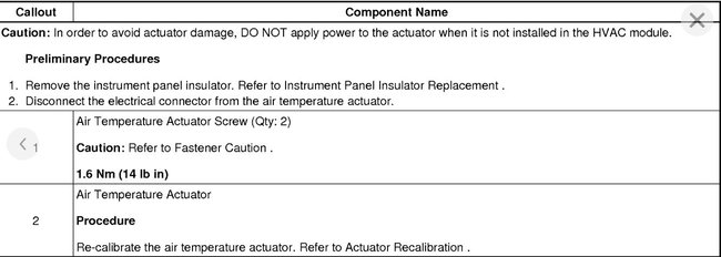

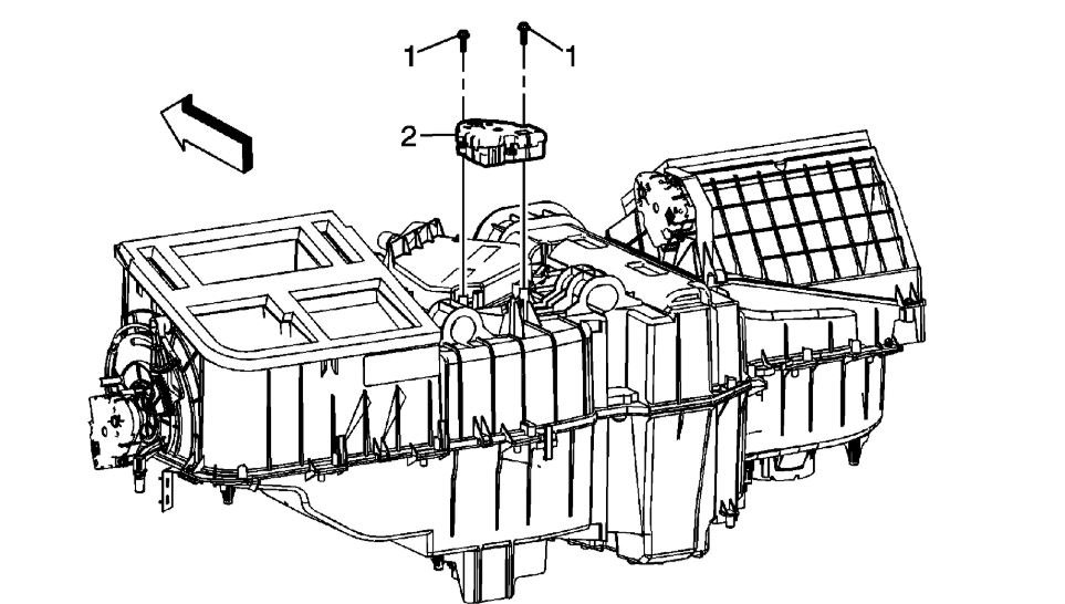

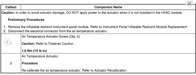

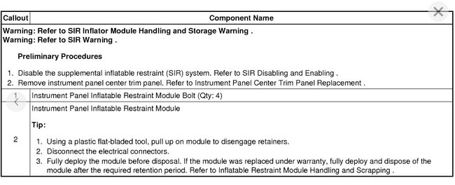

Good afternoon,
The actuator for the passenger side is on top of the heater case. I attached a diagram, picture and procedure for you.
The air bag module on top of the dash has to be removed to access the actuator.
You can get the actuator at any parts store.

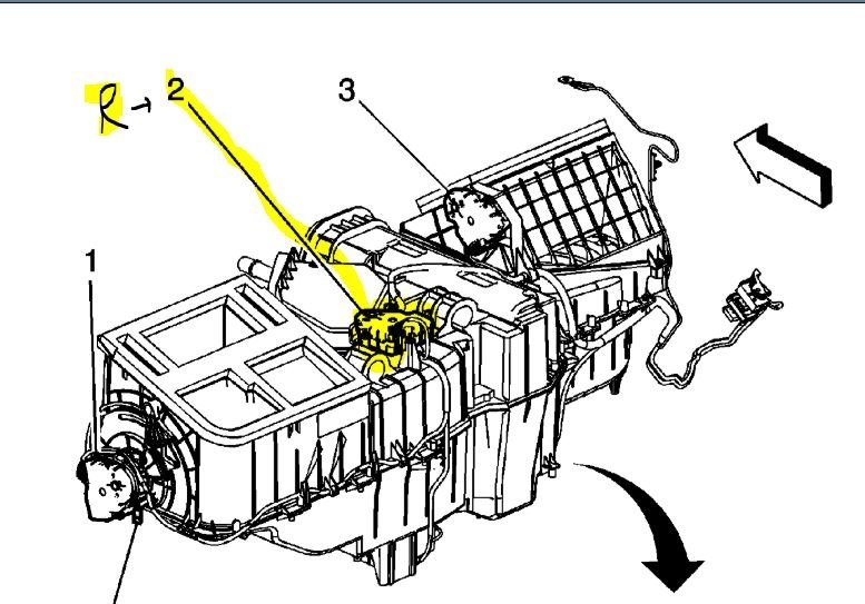

I have dual electric climate control. The drivers side blows hot when the A/C is on. I have tried to reset the actuator by pulling fuses etc. looking for the location of the actuator. Is there one on the drivers side? Have electric moving pedals also.
Jul 16, 2020 at 11:42 AM (Merged)
  • 110,194 POSTS
Welcome to 2CarPros.
There are two. One for the left (driver) and one for the right. I attached twp pictures below, labeled them 'L' and 'R', and highlighted the actuator.
Here is a list of all of the components indicated on the pictures:
1 - Mode Actuator
2 - Air Temperature Actuator - Right
3 - Recirculation Actuator
4 - Air Temperature Sensor - Lower Right (CJ2)
5 - Air Temperature Actuator - Left
6 - Blower Motor Control Module
7 - Blower Motor
8 - Air Temperature Sensor - Lower Left (CJ2)
____________________
Here is a link that shows in general how one is replaced:

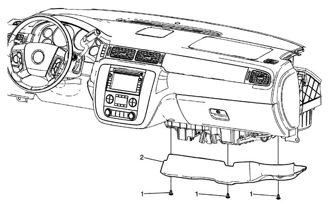

KCOONSTX
  • 6 POSTS
The one for the drivers side, what’s the easiest way to access it? Does the panel on the side of the console come off?
  • 110,194 POSTS
Welcome back:
See picture 1 for either automatic or manual temperature control. See picture 2 for insulator removal.
Let me know if that helps.

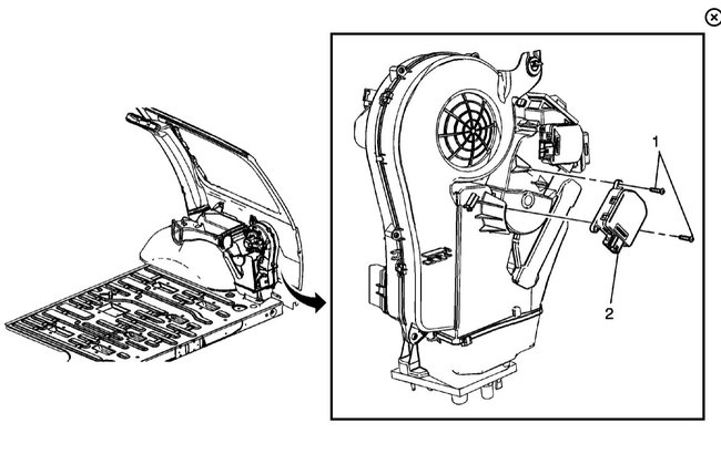

Hi, I have a 2007 GMC Yukon & teh rear AC blows hot on all speeds & on Cold. The front AC is in working order. My husband is pretty mechanical & we were looking to see where the AC runs from the front to the back. We check the fuses & they are all in working order. He seems to think that the door that opens/moves from heat to cold may be stuck. Any suggestions?
Thanks,
Karla
karlaw1972@gmail.com
Jul 16, 2020 at 11:43 AM (Merged)
  • 54,861 POSTS
These cars had a problem with the rear blend door actuator which controls the temperature. Here is a guide and a diagram (BELOW) that will show you hoe to get the problem fixed.

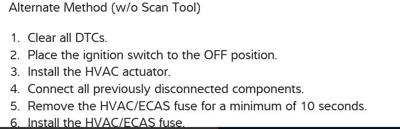

MIKE 69
I watched the YouTube videos about changing the door actuator.
I first disconnected the wire harness on the actuator, but it is still doing the same thing, randomly cold or warm on both side's, but the compressor is always freezing,
so it does not seem to be the actuator, because it is doing the same randomness being unplugged. Do you guys have any ideas?
Thanks very much.
Jul 16, 2020 at 12:01 PM (Merged)
HMAC300
  • 48,601 POSTS
when you replace an actuator you need to pull the fuse on HVAC inside truck to reset the actuators. See picture:
