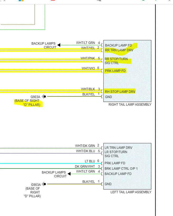

My rear passenger side LED signal light isn’t working but my brake lights do. Bought a whole new part and replaced it but now it’s not working. Can you please help me?

The light assembly contains a control module. You indicated now it isn't working. Do you mean the new light is not at all functional?
If that is the case, chances are you got a bad assembly. Shawn, where was the new assembly purchased? If it is an aftermarket from online, it may be faulty.
Let me know if the right front light assembly is working as far as the parking light and turn signals. If it is, it isn't a power issue to the rear.

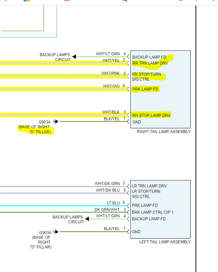

If possible, disconnect the light connection. Check each of the wires indicated below for power under the selected function the wire indicates. If they do have power, confirm there is continuity to ground via the black wire. If you have power and ground, replace the light assembly.
I will watch for your reply.
