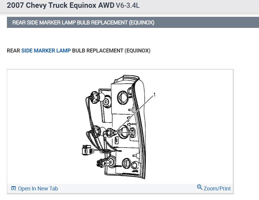

The brake light comes on when you press the brake but when you turn on the lights for night the other lights don't come on only the brake light when you press the brake.
Apr 16, 2023 at 8:27 PM
  • 55,051 POSTS

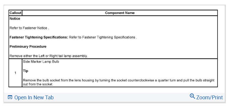

So, it only one running light that doesn't work or all of the running lights not coming on, if it is just the one it sounds like you have a bulb that has gone out here are the instructions on how to change it out in the images below. Also, i have included a guide to help you as well.
https://www.2carpros.com/articles/no-tail-lights-exterior-running-lights-tail-lights-out
