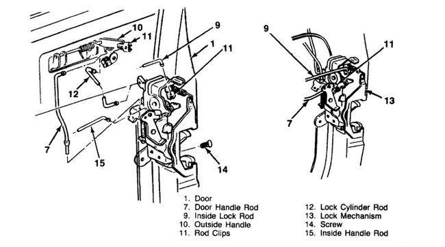

The handle broke. So i went and got a whole new unit and put it in. Put the door back together, closed and locked and unlocked and opened the door from the inside and outside. Went into the house, came back out and opened the door from the outside went inside the truck, closed the door and locked it, unlocked it again and tried to open it. Wont open. I go out the front door and try to open it from the outside while unlocked and it wont open. What do i do now? I can't open the back passenger door at all from the inside or out. It is not powered locks. It is the back right passenger door.

When you pull on the inside or outside handle, can you feel the rods move?
Pull up the lock rod and hold it while you try to open it. It could be the latch that is bad.
Did you put new hardware on the rods when you change the handles?

I can't open the door. I did feel the rods move when i was assembling it.

When you say put new hardware on the rods, what do you mean? The one clip for the door handle? Because the door unlock one was a tab that i snapped in.
Sep 26, 2019 at 7:47 PM
Yes, those tabs are what I am talking about. They can break especially since are using junkyard parts. If the rods fall off, it will cause this issue.

Where can i get a new tab? So the rod wont fall out.
Sep 26, 2019 at 8:12 PM
Parts stores have these clips. They have an assortment of them for all the different styles.

The door is opening now but not locking.

I can't get the door to lock.

Hi and welcome back,
This is a common issue. Over time the door latch gets filled with dirt and all the grease dries out. It keeps getting stiffer until it wont move anymore.
You need to pop the door panel and remove the door latch. Soak it in gas or the like and clean it out real well. Make sure everything is moving good, Re-lube it with white lithium grease or I prefer using chain lube and reinstall.
