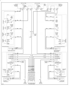

I replaced the regulator in the passenger front door and now no power even to mirror. Checked all fuses but no fuse or CB appears to solely control all power to just that door. Door was fine when disassembled as I checked functions. Switch cluster got wet inside door during the time I waited for the regulator. Battery was drained also. All other doors are fine.

After looking at the schematic wonder if there is a break in the circuit It does not look like the window circuit and mirror circuit are the same. Disconnect the switch and check to see if you are getting power to that door. Enclosing a diagram of circuit
https://images.2carpros.com/forum/automotive_pictures/54223_power_window_circuit_1.jpg

No power to the door except the power lock that activates all doors but the passenger front. Anyway to enlarge the schematic?

I am not that good with using a computer but found that if I save diagram to someplace like pictures then I can resize it using paint or similur program. to whatever size i want
