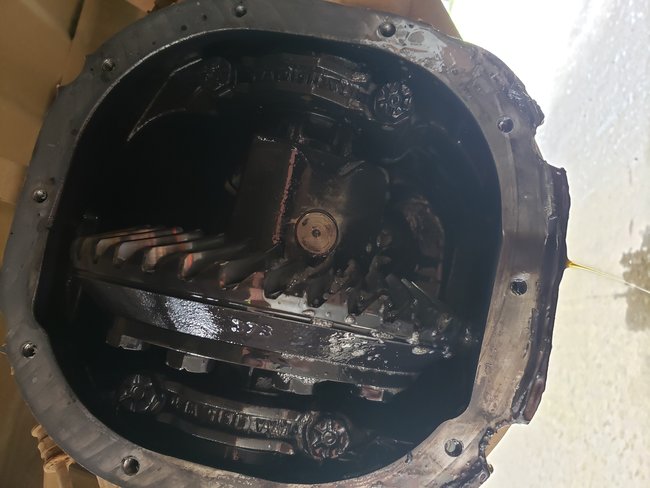

Here's a photo of the differential, I'm changing the fluid now. You think it will help ?
Mar 22, 2020 at 6:09 AM
STEVE W.
  • 15,411 POSTS
Changing it won't hurt but it isn't going to fix worn gears or bearings. If the mileage you have is correct I would say it's just wear, It might be possible to tear down the entire differential, replace the bearings and reset the pinion depth and ring gear lash to make it better but I'm not sure it would make a lot of difference with the wear you have. If you grab the driveshaft at the yoke where you were turning it in the first video can you move it up and down or side to side? that would indicate very worn pinion bearings which could be changed out. Then it becomes a question of cost and return on investment, is the truck in great shape? Is the engine and transmission really good? Do you intend to keep it? If those are all yes, I'd probably go to a salvage yard and find a rear out of a lower mileage truck with the same gearing and options and remove it. Hopefully one that was wrecked in the front as that gives an indication that it was on the road and being used, then use that to build a new axle for your truck. That way you can take your time and still have your truck on the road. Then just swap it out on a weekend when it's ready.

The truck is in great shape, engine and transmission too. I grabbed the pinion and could not move it when I had the cover off. So I guess that's something. Should I worry about it? Or avoid pulling or hauling anything? or what?

I agree with Steve. If it starts making more noise or new issues, then a rebuild should be considered. I looked at your pic above. I don't know if it is a reflection or what, but the ring gear appears to have different colors on the teeth. Is that just a reflection?
Also, when stopped, the differential isn't going to cause any shaking or vibrations. That sounds more like a rough idle issue.

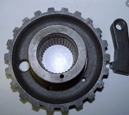

Yes that is a reflection. Also guys, I hate to sound redundant, but just to be sure that video I posted it me moving the driveshaft at the transmission, not the differential. The noise is centered at the transmission end.
Mar 22, 2020 at 1:09 PM
  • 110,248 POSTS
When you said it you had the rear lifted, I assumed you meant it was the differential. That is most likely the parking sprag you hear. Unless you had it in neutral. I attached a picture of what a parking sprag gear looks like. That is what holds the vehicle from moving.
If there was a bearing issue in the tail housing, chances are you would see ATF leaking from it.
Let us know. And no, you aren't being redundant. Feel free to ask anything you want. (dealing with cars LOL)

Chances are everything is okay with both the transmission and differential. There will always be a little play. That's normal. The idea that you serviced the rear differential is a good thing. Most people neglect doing it and it is something that needs done.
Now, if you would have told me that much play was in the differential before the internal gearing connected, I would have told you what I originally said. It's a bit excessive. However, at the transmission, that doesn't concern me.

The gears didn't move when I tried to move them by hand once the cover was off.

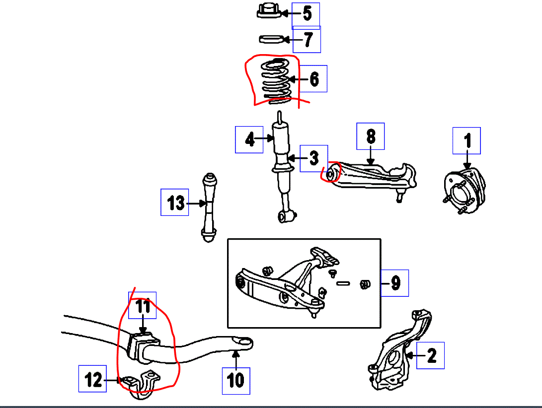

When you take the rear rotors off, check the brake shoes for the parking brake as well. If the noise is in the front, make sure the coil springs are in good condition and not broken. Try to record it when it happens. When you said bong, I picture a coil spring. Also, make sure the control arm bushings are good and nothing is loose on the front.
I attached a pic and circled a few things to check. Let me know what you find.

Well, I jacked it up on the control arms and I can't find any kind of movement. I can't see anything obvious.

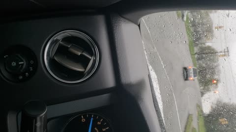

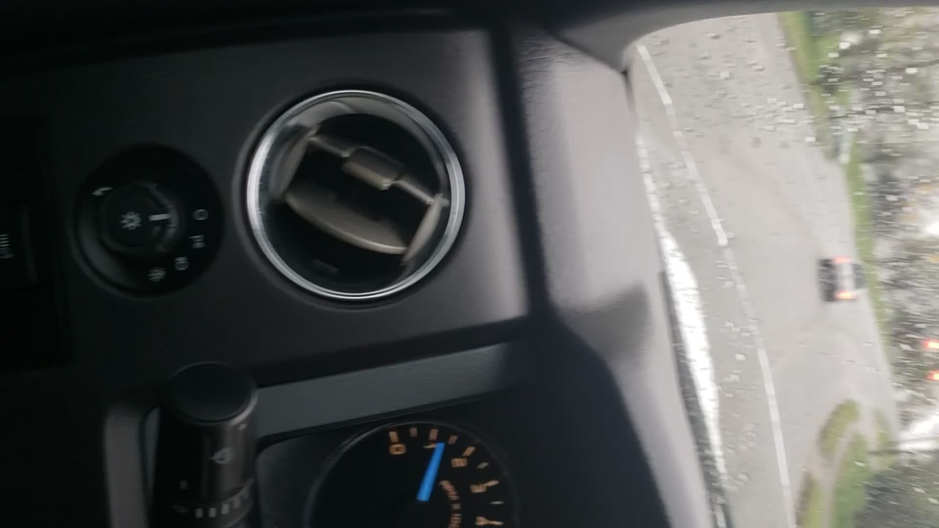

I have a video here. You can hear the boom as the truck ceases movement. I'm kinda leaning towards sticking shocks despite how expensive they are.
Mar 24, 2020 at 8:10 AM
  • 110,248 POSTS
I barely hear it. If it was a shock, you should be able to recreate it by bouncing the vehicle by hand. I wish I could hear it better, but realize that is easier said than done. Do me a favor, check to confirm there isn't any play in the control arms or sway bars. Also, recheck (and you may have already) the caliper mount, caliper slides and so on. Once last thing, make sure there is no play in the wheel bearings.
I literally held the speaker against my ear. I heard something but really can't identify it simply because of volume. I hope you understand.
Mar 24, 2020 at 9:45 AM

I know it's hard to hear, I did my best, haha. I've checked wheel bearings and ball joints. I jacked it up by the control arms and wedged a pole underneath the tires and pressed upwards, and there was no noise or dramatic movement. I don't know how to test the sway bar links.
Also, if I come slowly to a stop I can avoid that noise, but when i let off the brakes it will do it.

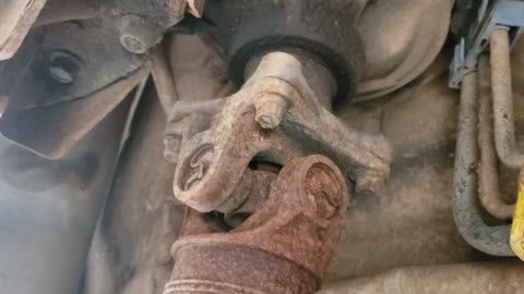

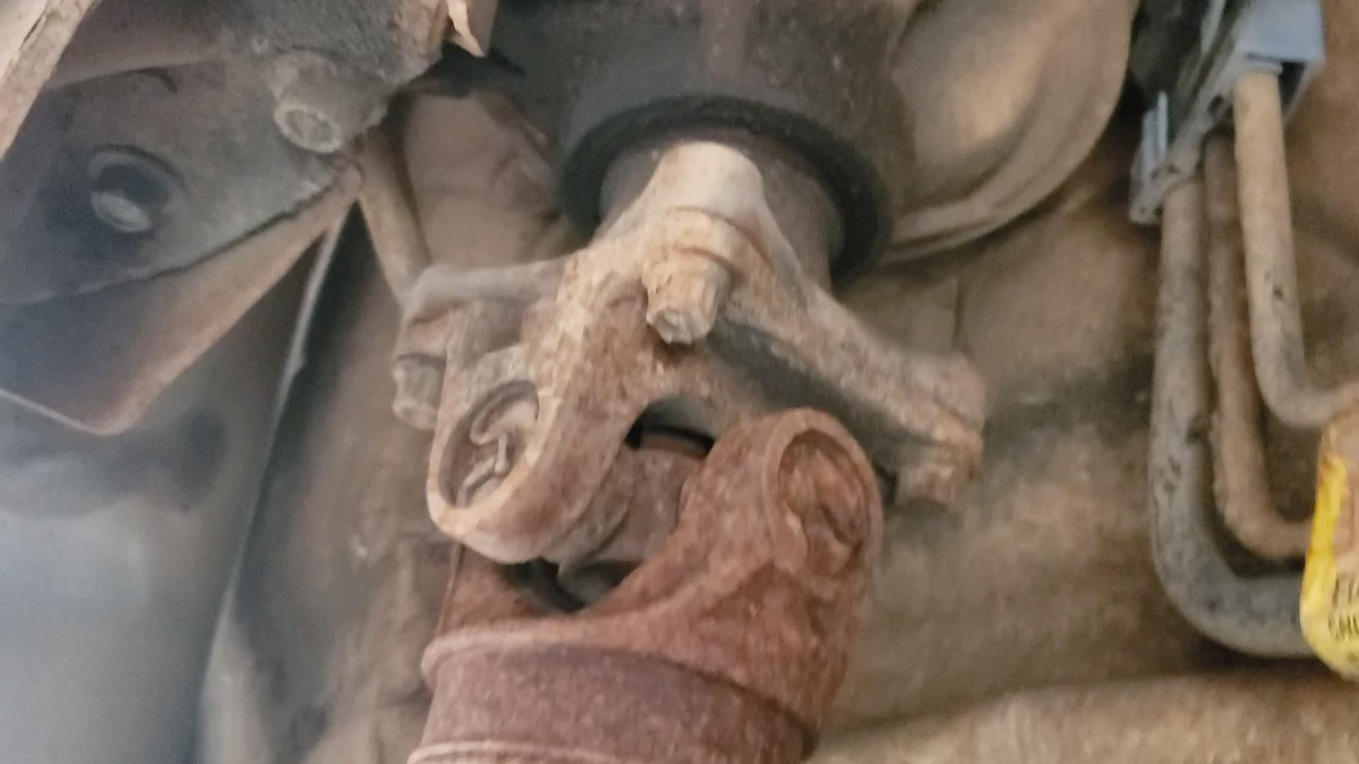

Here's something: a friend pulled up and down on the driveshaft and there's a similar noise/vibration, it seems like the driveshaft mount is letting it move up and down .
Mar 25, 2020 at 3:37 AM
  • 110,248 POSTS
Are you referring to the universal joint? Take a look through this link and confirm it for me.
https://www.2carpros.com/articles/how-u-joints-work
Mar 25, 2020 at 8:57 AM
CANNON1349
  • 861 POSTS
No, the center support bearing, or the carrier bearing in the middle of the shaft. I can move the driveshaft an inch in any direction, apparently the rubber part is done, but the bearing itself is fine. Any thoughts?
Mar 25, 2020 at 9:24 AM
  • 110,248 POSTS
That sounds like the problem. I have a feeling you will need to get the entire part. I don't believe you can get parts to it.
Please let me know if that takes care of the noise. I'm really interested in knowing.
Mar 25, 2020 at 9:51 AM

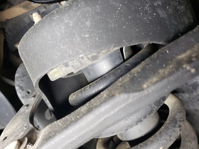

I found that a front strut has a broken piece. But would this cause a noise like that or is it cosmetic? Hands down we know the center support bearing needs to be changed, but here's another idea.

That looks like a dust cover. That shouldn't be causing a noise. It should be plastic.

Yes it's plastic. Didn't know if it's a cause for worry.
