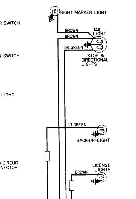

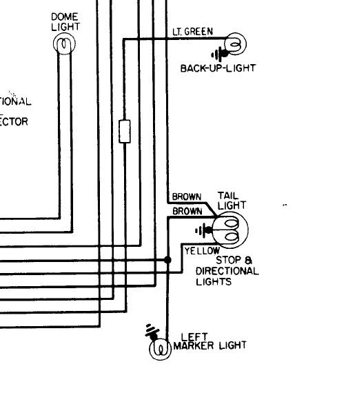

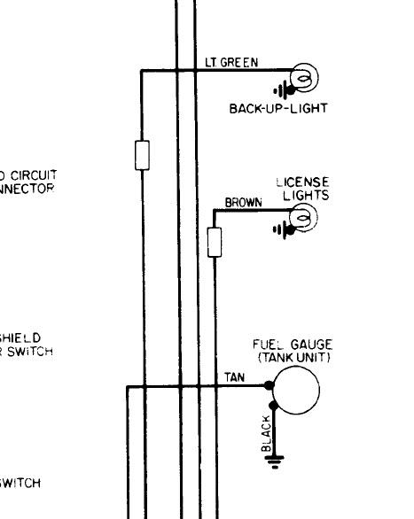

i have a truck i am restoring and i dont know where p/n/d/d1/d2/ is on the side of the transmission?.
also sum dumb ass cut out the wires for the rear lights and now when i wired it in the light socket was hot and the flashers dident work really i nead some one to tell me witch wire is what there is 3 green wires and 1 yellow and 1 brown witch is witch

The wiring info I found for this model year, says GMC, tail lamps. The wire colors are voltage.
